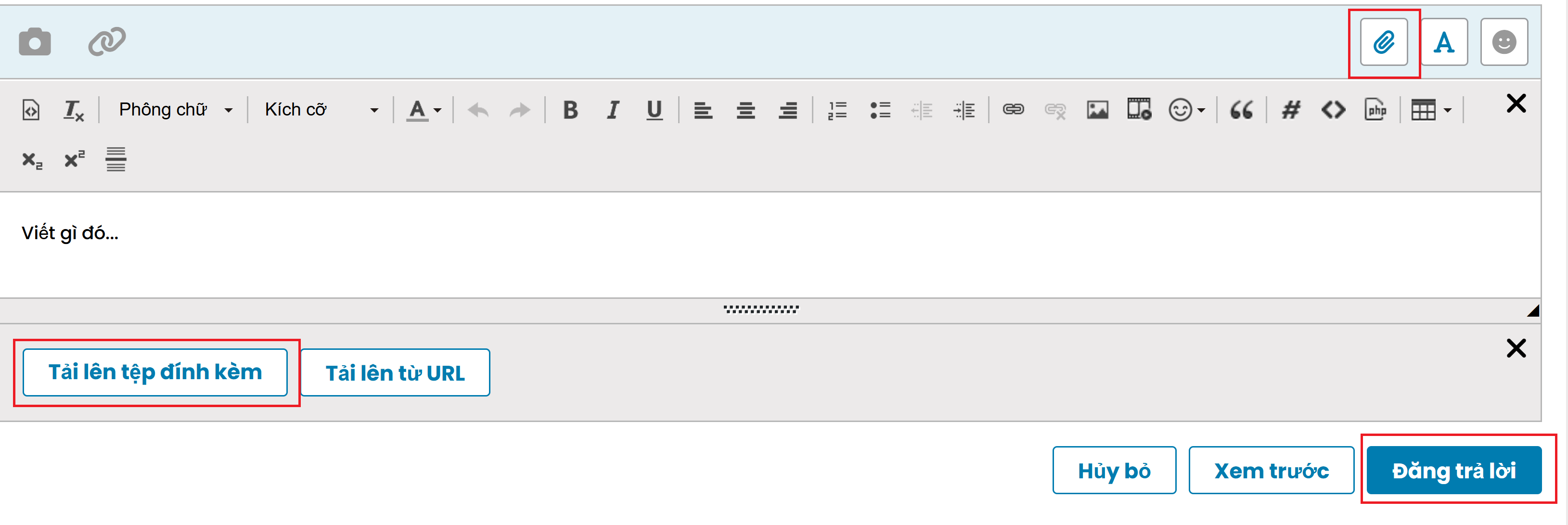

              I'm sorry bro ican't upload files here
              and this the URL
              thank you fro unlock files
              Use Winrar or 7zip before posting
