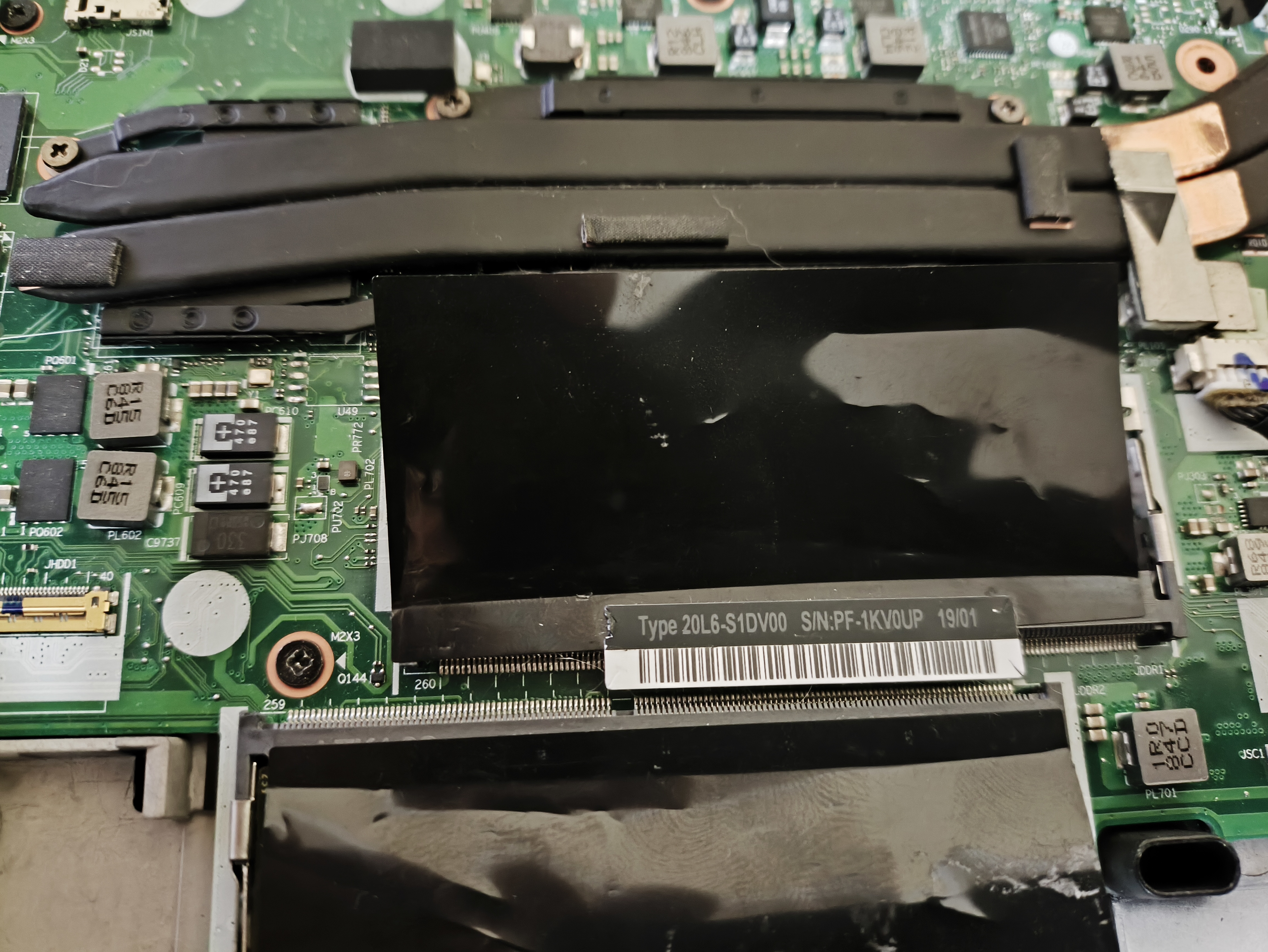

                    Please, same problem. 0285 error code. Bios attached. Type 20L6-S1DV00 S/N:PF-1KV0UP
                    • hoaca388
                      Badcaps
                      • Jan 2022
                      • 11448
                      • Viet Nam
                      T480 Laptop (ThinkPad) - Type 20L6
