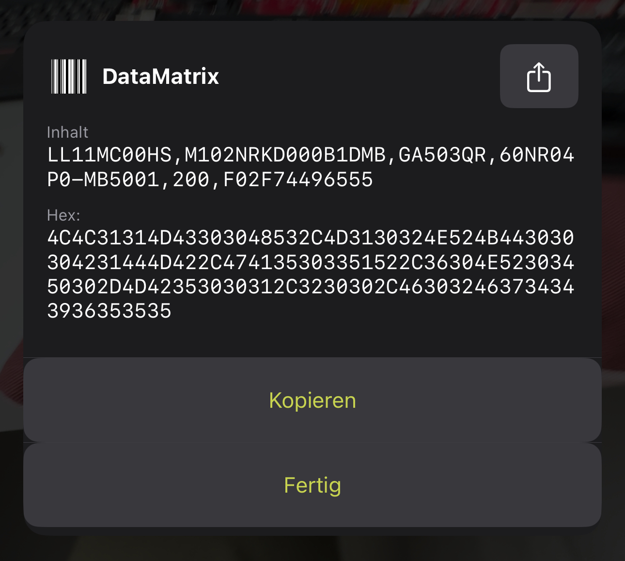

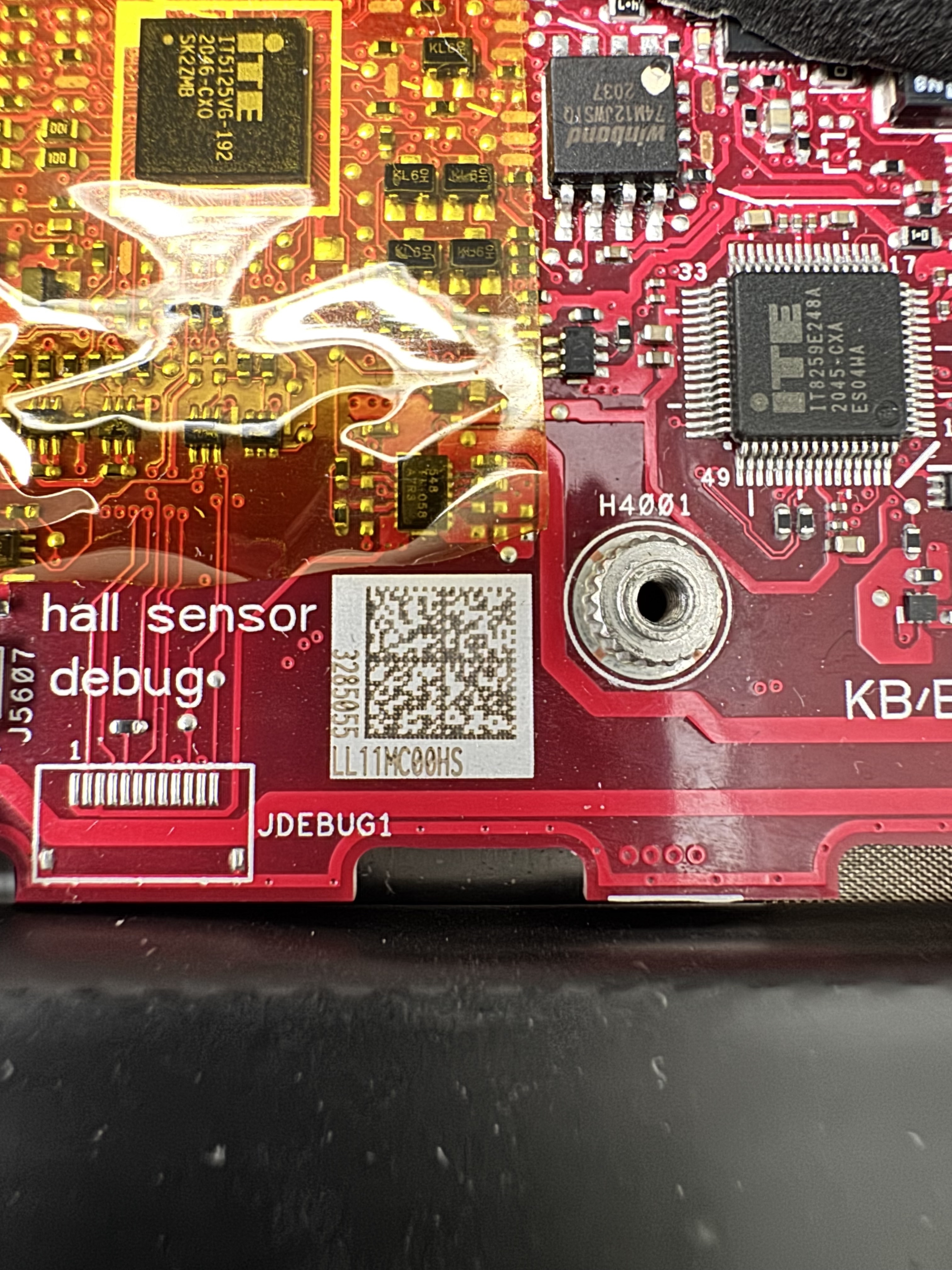

            I told you, post a picture with QR code from working motherboard to see what bios you need
            • mixtape87
              • Apr 2020
              • 28
              Your absolutely right didn’t read that part of your post properly sorry for that! Here is the Data matrix code from the Mainboard
              • volinakis
                • Jan 2021
                • 2664
                • N/A
                try

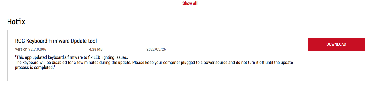

                      I see there is a fix for RGB kb in drivers, download it and install
Name:	Screen Shot 2025-01-03 at 11.54.18.png
                        I installed that already but didn’t changed anything so I will try to flash the new bios and then check it out

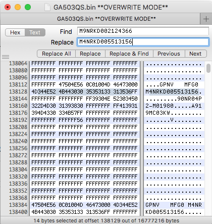

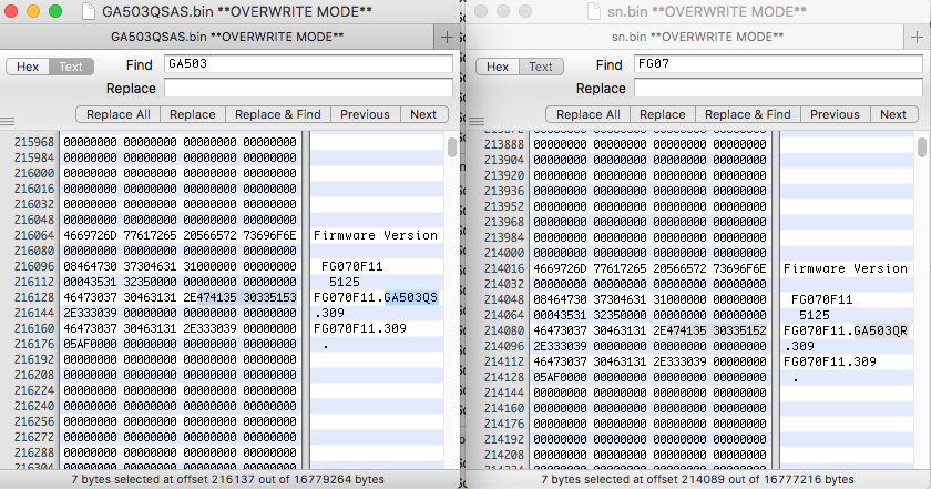

                                    In this bios there is another SN, can you change the SN to the original one I posted?
                                    • volinakis
                                      • Jan 2021
                                      • 2664
                                      • N/A
                                      #38
                                      well, is so simple, open hex editor, Find&Replace.
Name:	Screen Shot 2025-01-11 at 02.26.09.png

                                        • mixtape87
                                          • Apr 2020
                                          • 28
                                          #40
                                          Click image for larger version  Name:	Screen Shot 2025-01-11 at 02.26.09.png Views:	22 Size:	44.5 KB ID:	3545891
                                          Nothing worked, I reinstalled the dead mainboard and after i press the power button the keyboard lights up in rgb after swapping to the replacement motherboard its still just simple red light and nothing changes. i am really desperate and don´t know what am i doing wrong here. has anybody an idea or can help me to fix this?​
