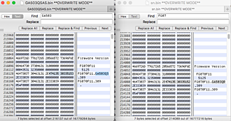

                    well, this bios you attached made your RGB kb not working, so post bios backup from new motherboard without serial with which your kb worked. Also post a picture with QR code from your new motherboard, it's possible to be GA503QR

                        yep, as I suspected ...
Name:	Screen Shot 2024-12-29 at 13.10.52.png

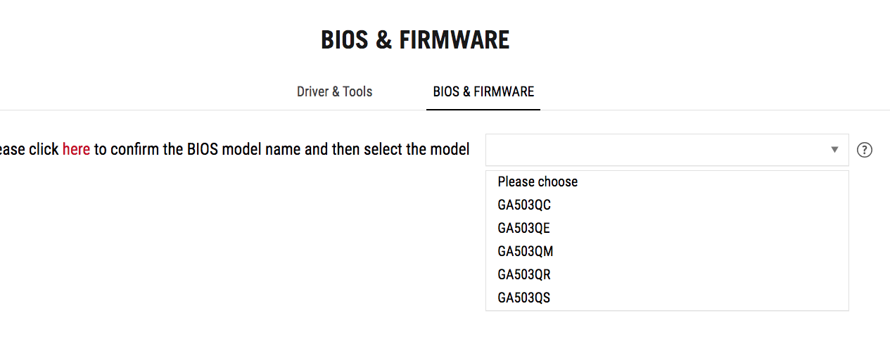

                            you can clearly see in picture, one bios is for GA503QS and other is for GA503QR.
Name:	Screen Shot 2024-12-29 at 13.10.14.png
