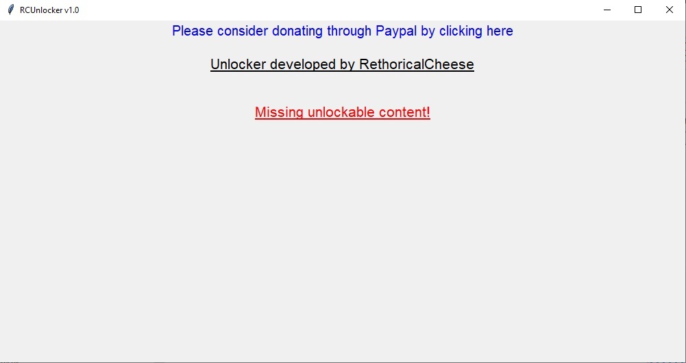

            Hello!
            Help me unlock this bios! Password locked. Bios and EC file also included.​
            HP Elitebook 755 G5
            SN: 5CG0037BRX
            PN: 2MN15AV
            SPS L21936-601 (CS1945)

              Originally posted by Echoo
              Hello!
              HP Elitebook 755 G5
              SN: 5CG0037BRX
              PN: 2MN15AV
              use RCUNlocker on 16MB bios..

                I get this screen:
                  I get this screen:
                  hi try
                  • Echoo
                    • Apr 2018
                    • 92
                    • Budapest
                    It starts, but unfortunately the password remains.

                        • Echoo
                          • Apr 2018
                          • 92
                          • Budapest
                          Originally posted by minhdigital
                          Try !!!
                          Thank you very much! Everything works perfectly now!
