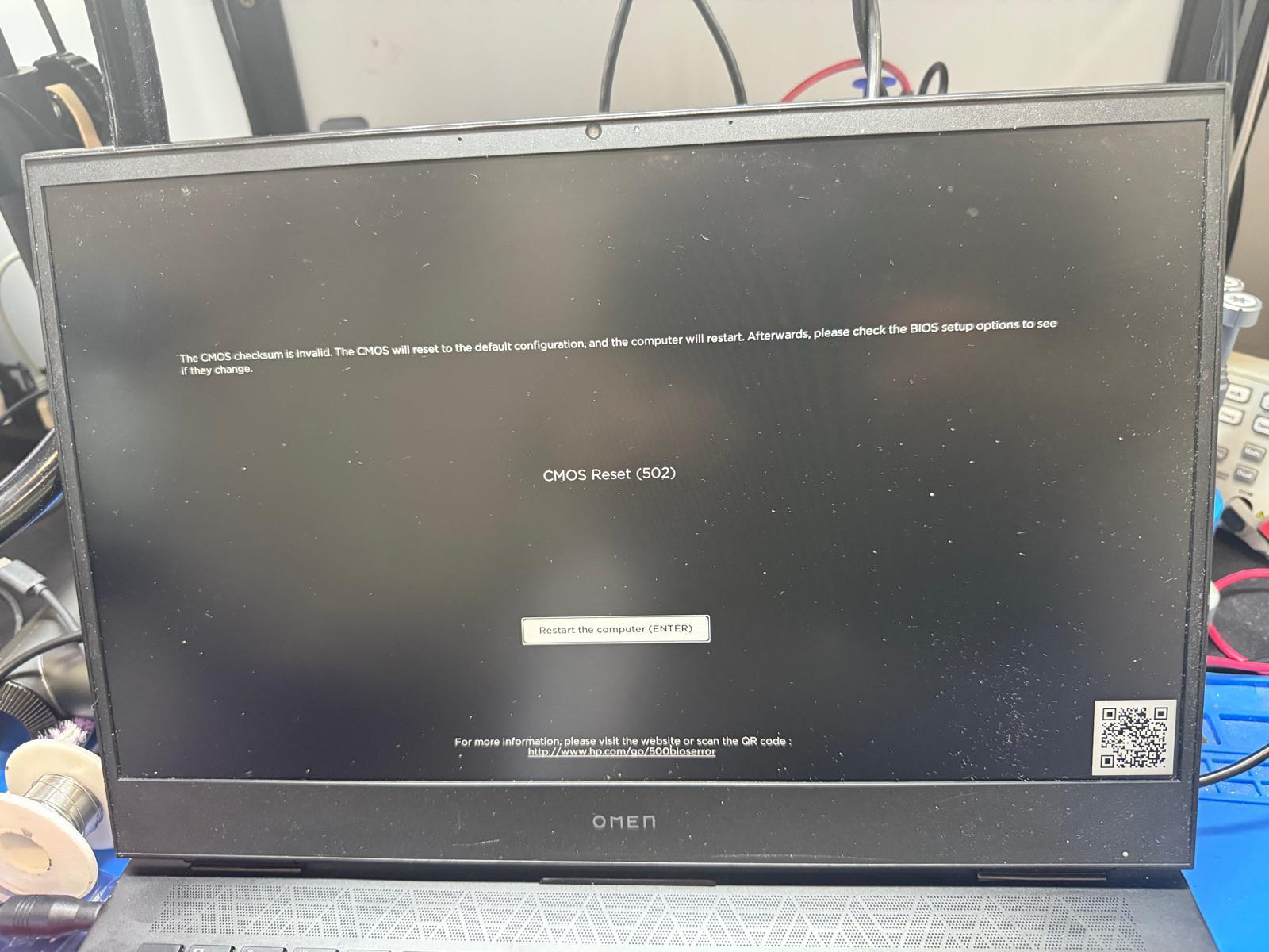

                                          #40
                                          I get error 502. Here is the error and the BIOS backup. Help me, thanks in advance.
