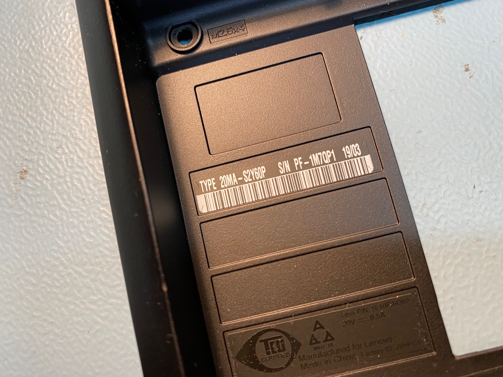

      Re: Lenovo P52 20MA-S2Y60P Bios please
      The S/N: PF-1M7QP1
      Added a picture of it as well.
      And I did not know that, must I do something with that?
        Originally posted by Jenzo
        The S/N: PF-1M7QP1
        Here's your New BIOS, try it and let me know.

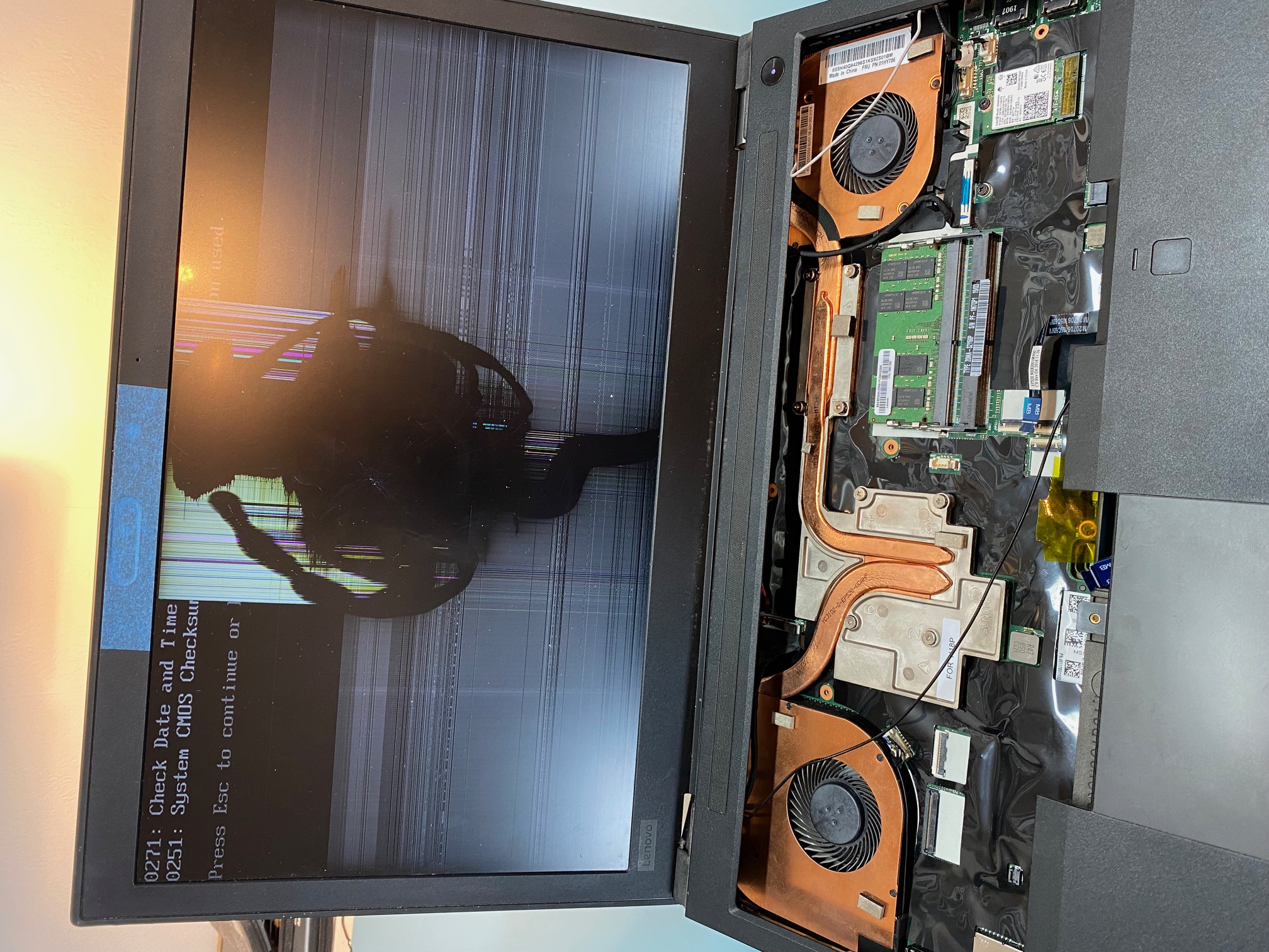

                                      • Jenzo
                                        • Jul 2019
                                        • 135
                                        • Belgium
                                        Hey everyone, as promised an update:
                                        The bios now works! With the RT809F programmer no issues writing and verifying.
                                        On a sad note, now it boots it turns out the display is really damaged, picture included. That will be a fun call to the client :').
                                        Thank you to everyone helping me out here, I learned a lot here!
