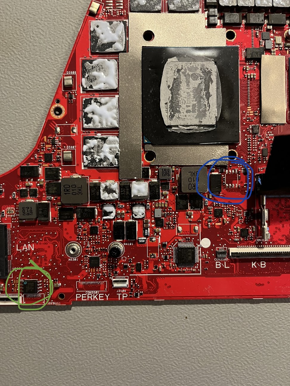

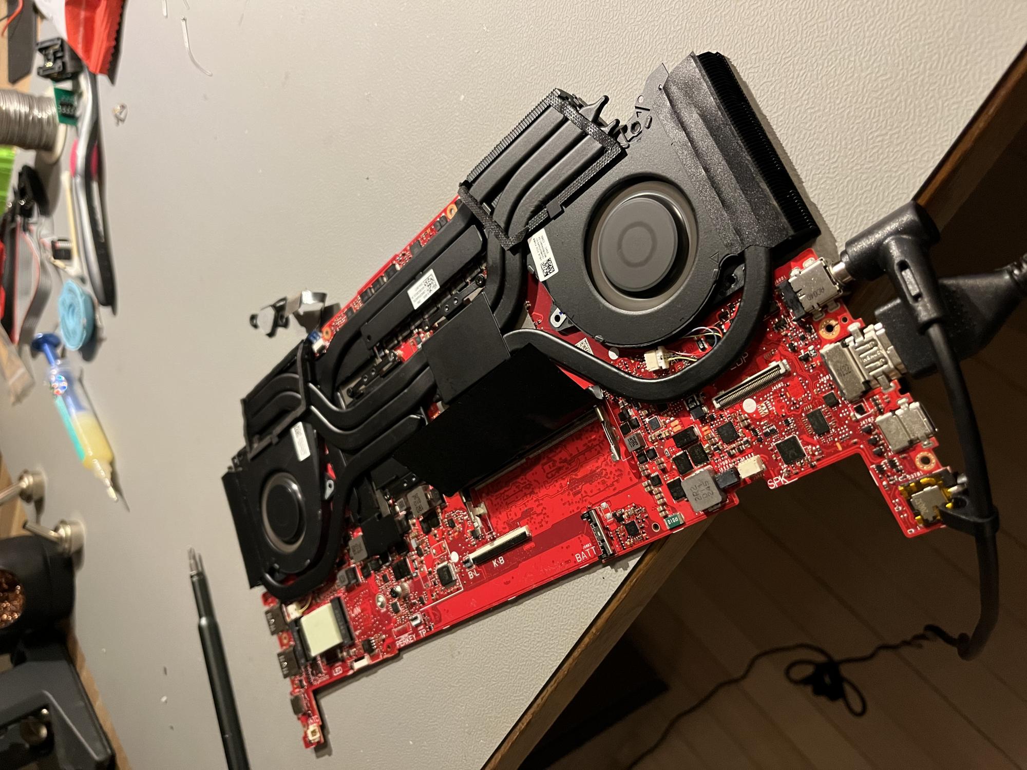

              ASUS GA401IV Rev 1.4 Bios
              Have a GA401 that turns on and after a couple seconds turns off. Can anyone check this dump? Thanks!

                Your backup is the 1MB vBios .Find another chip .Is there a model number on the square white QR code next to the RAM slot.
                Post the laptop serial number

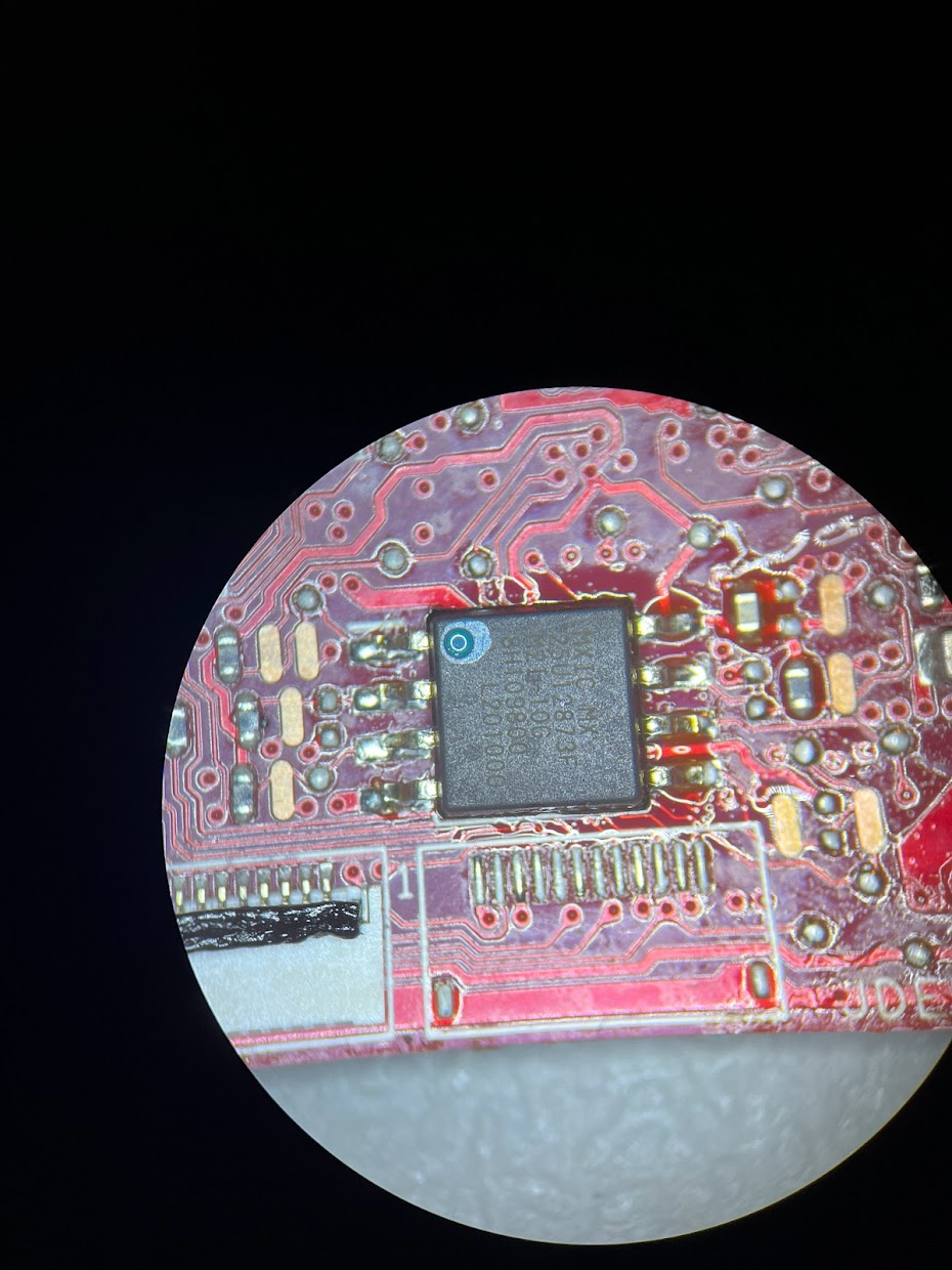

                  Lol, I'm an idiot
                  I just found a Winbond IC and took it off.. I'm guessing it is the MX IC, as pictured.

                    Yes its the MX chip, looks like its been worked on before,the connector at the bottom left seems a little melted.Get some kapton tape on it or put a metal shield over it before you desolder the chip.
                    The vBios might help someone else .Post a picture of the label with the serial number on it

                      Nah, thats me, I have worked on the board, and have gotten all voltages present on the board, so this is pretty much my last chance of getting it to work.. What label do you mean?

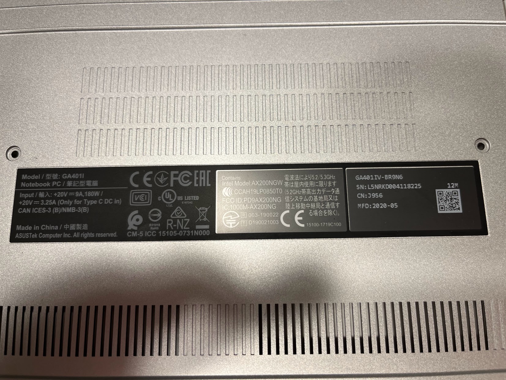

                        The label on the base cover

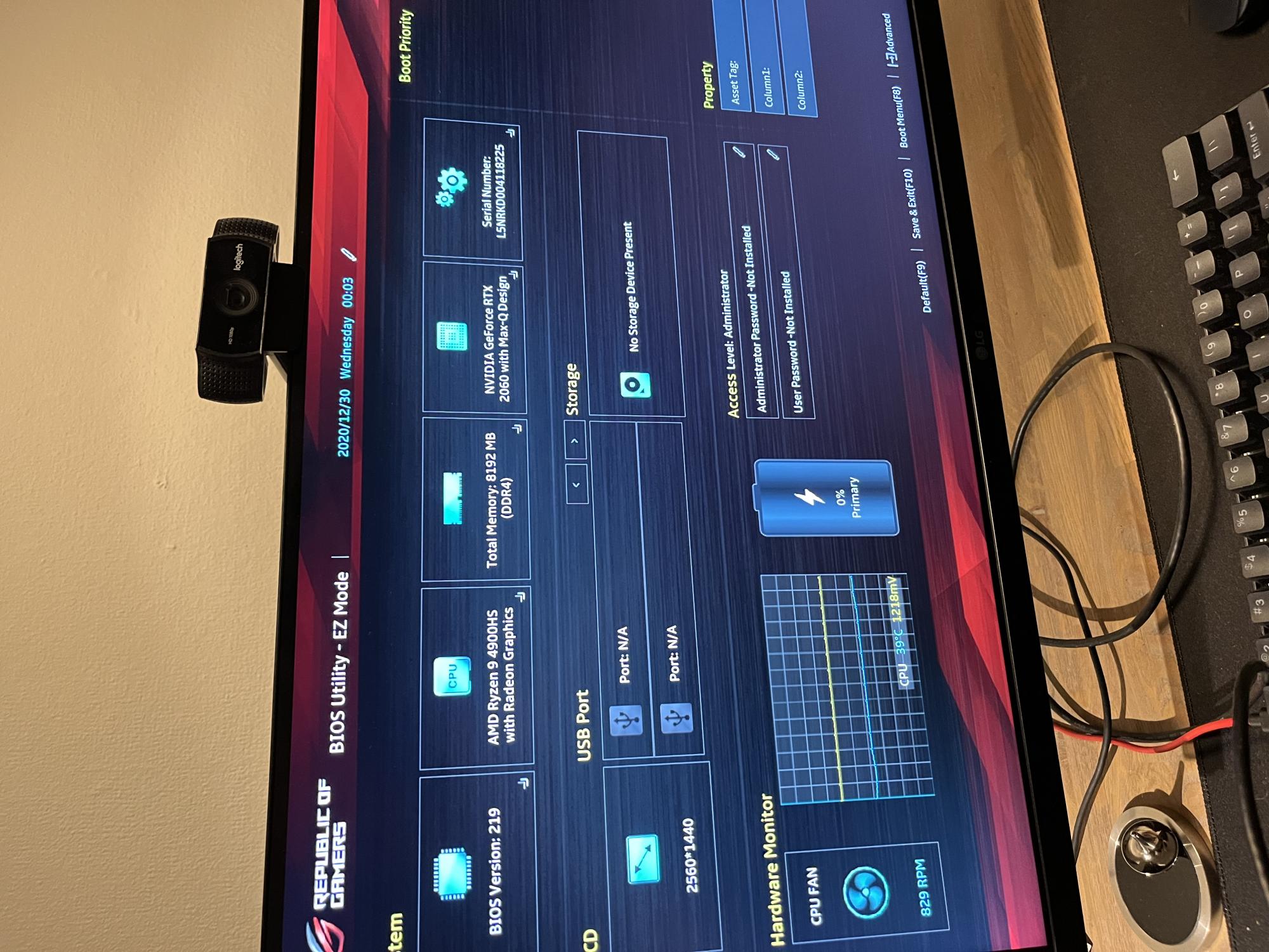

                          Sure,
                          Also, the right BIOS this time

                            Here's your New BIOS, it's a Virgin BIOS from ASUS with your DMI and Windows Key.
                              What a legend you are! It booted right up!
