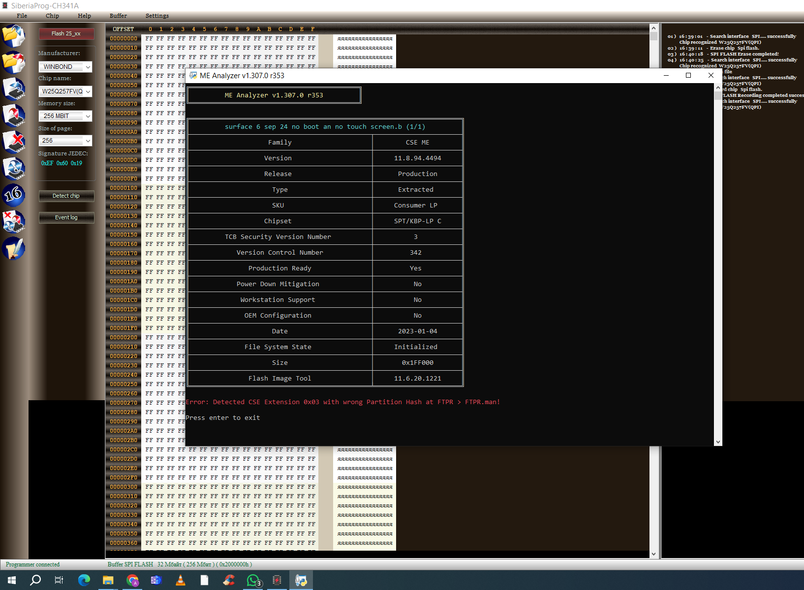

                    Hi from Spain. I have a problem with a surface pro 6. I have the original (sense corresponse to thee motherboard) bios bin merged with a another bios bin, trying to dump bios pass. But () I had delete the original original bios bin. When I flas the bios merged, the machine flash win logo for a senconds and off. When I have flashed thee same bios bin changed ME region by ME region of the other bios bin functionaly, surface go to boot and I can installa windws, etc, but the touch screen is dead. The keyboard goes normal.
                    I had used fit tools to clean ME region, but I have`t found the repository with proper ME (see atach). When I try to fit with a ME near to mine, the result is the same.
                    Anyboy, can help me to clean ME or post the proper ME?
