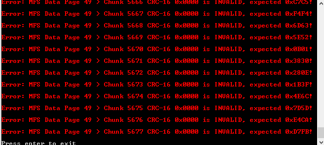

        surface pro 5 1796 flashes logo
        hi
        i have a suface pro 1796 that flashes logo on boot then goes off,
        i believe its a corrupt update, i have extracted the bios from the flash and it fails when i run ME analyser - CRC errors.
        i have a working bios that has the same version and was wondering if there was anyone out there who could replace the ME in my file with the working one from the other?
        (if this is possible!)
        extract is my file

                    Re: surface pro 5 1796 flashes logo
                    2 versions - original extracted bios and FIT output with new ME region
                    but still flashes logo so believe its something more that is corrupt,
                    if i change bios region i lose serial numbers etc,

                        • 20966
                        Originally posted by stevep2k21uk
                        Bump
                        try this one.
                        • stevep2k21uk
                          • Nov 2021
                          • 30
                          • United Kingdom
                          Hey smdflea
                          I have flashed it and the tablet boots but there’s a code 10 power failure on the TCon driver.
                          Any ideas?
                          Thank you for your help
                            Hey smdflea
                            I have flashed it and the tablet boots but there's a code 10 power failure on the TCon driver.
                            Any ideas?
                            new screen fitted - tcon error has gone so must have been related to missing screen.
                            touch doesnt work though with new screen
                              • 20966
                              Try this one. I`ll change the thread title as its a surface pro 6 not 5
                                screen just flashes on then goes off again like initial problem
                                  Try this new one please.
                                    when i check it with me analyser it gives crc errors? should i still try it?
                                      errors from test2
