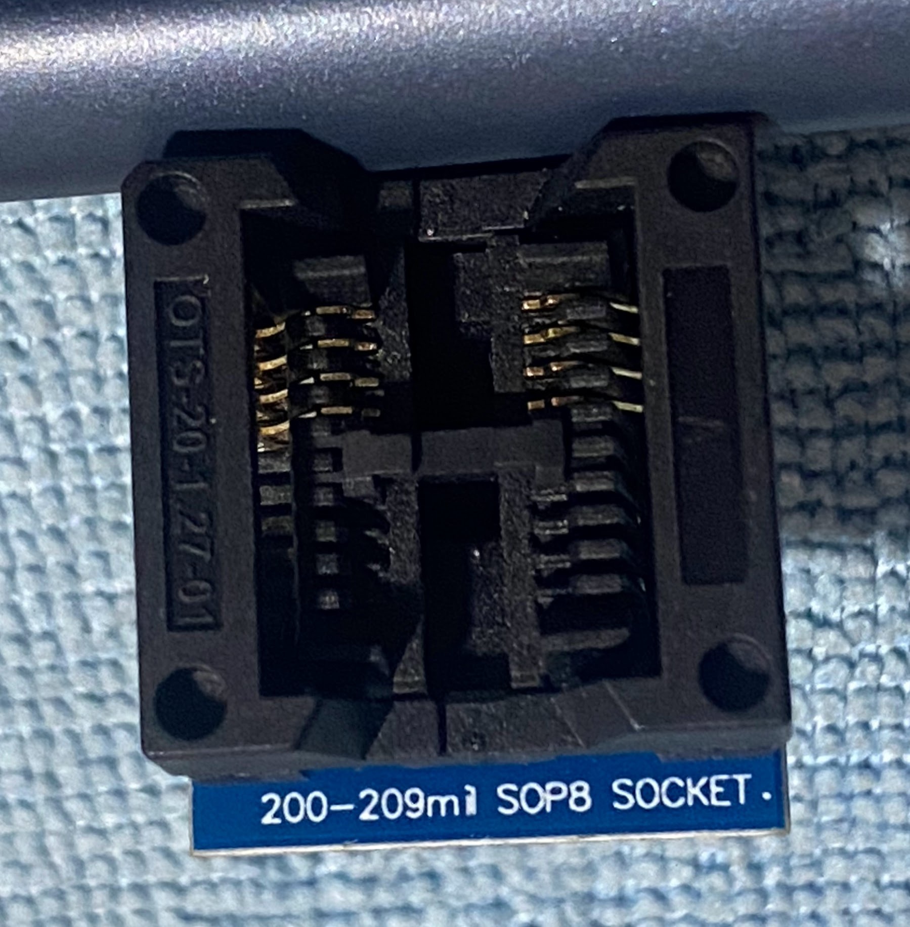

                                • laptecperu
                                  • May 2023
                                  • 5
                                  • PerĂº
                                  Ok friend, I understand, I have this socket from my programmer, with that I can program the unsoldered BIOS chip, I upload a photo of my socket
                                  • peste
                                    • Dec 2016
                                    • 13827
                                    • ROMANIA
                                    ok...ok take the chip out of the board put it in the adapter and the adapter in the programmer...
                                    • laptecperu
                                      • May 2023
                                      • 5
                                      • PerĂº
                                      Hello friend, good day, I unsoldered and flashed the 2 BIOS, but the laptop still doesn't turn on, only the power LED, the small BIOS UB2, is it also necessary to flash it?
                                      • peste
                                        • Dec 2016
                                        • 13827
                                        • ROMANIA
                                        either you didn't write them correctly or the laptop has another problem...
