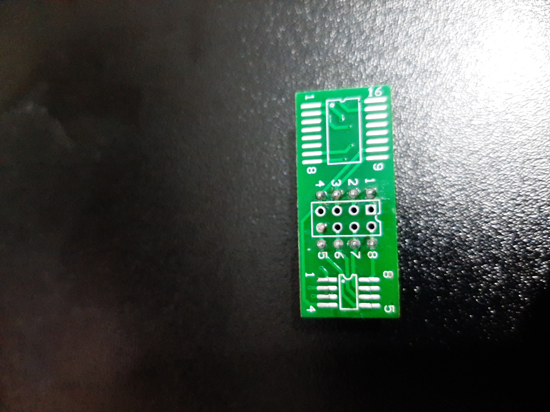

    Im trying to program a bios chip and I get this error
    The bios (even the original) is 16MB but the chip is only 10MB
    Any solution?

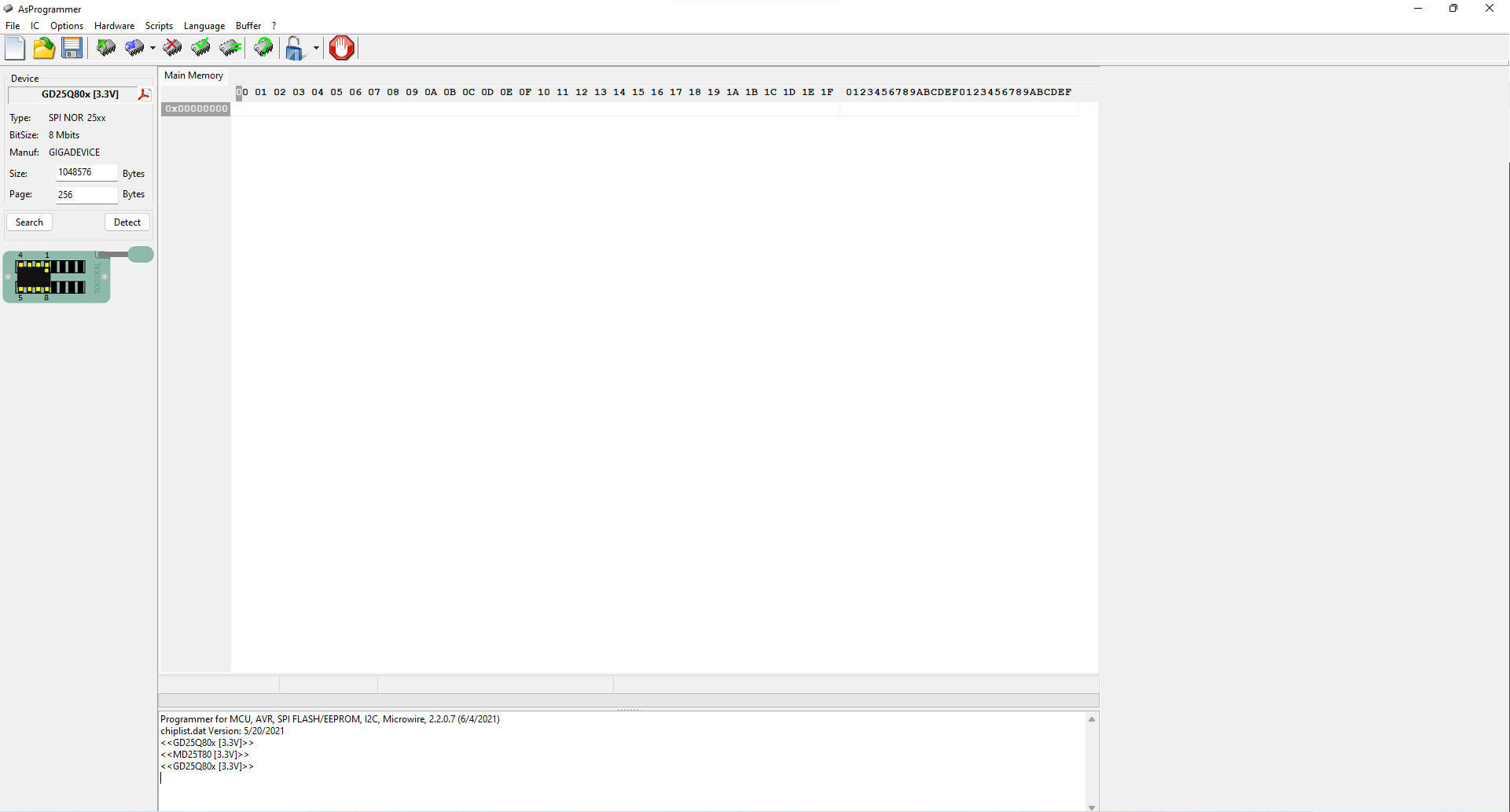

                      I soldered the chip on the adapter board, and i selected the chip manually.
                      The chip is 10MB in every single software i tried even without the programmer pluged, so it's not the software and probably not the chip
                      I just don't understand how the reading was 16 if the chip is 10.

                        The chip isn`t 10 as already said by @mon2 ,it is 8Mb megabits (lower case b is bits and upper case B is Bytes),so the file read should be 1,024KB which is 1MB MegaBytes
                        Post pictures of the adapter board without the chip on it and the software screen when the chip is read manually.Also post some of the 10MB and 16MB backups you made.
                        Can you answer the other question i asked, did you erase the chip or try writing to it ?

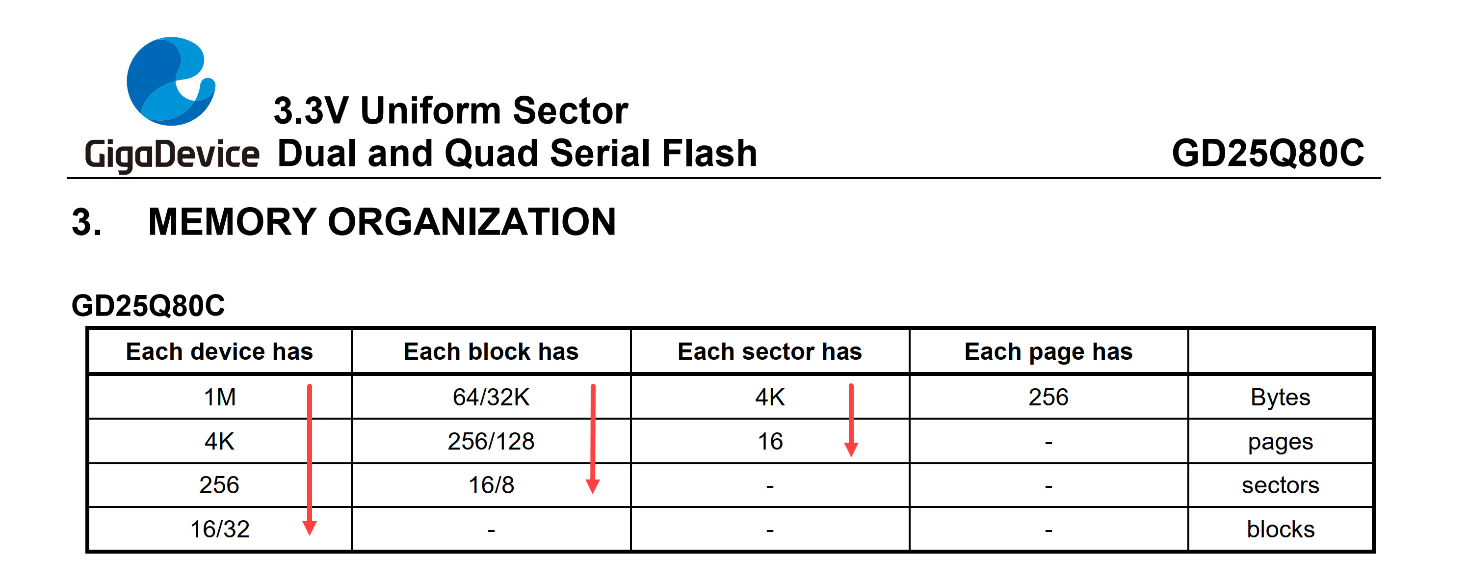

                          • R_J
                            • Jun 2012
                            • 9535
                            Re: Buffer size not equal to IC size
                            Here is the datasheet
                            • mon2
                              • Dec 2019
                              • 14002
                              Memory org
