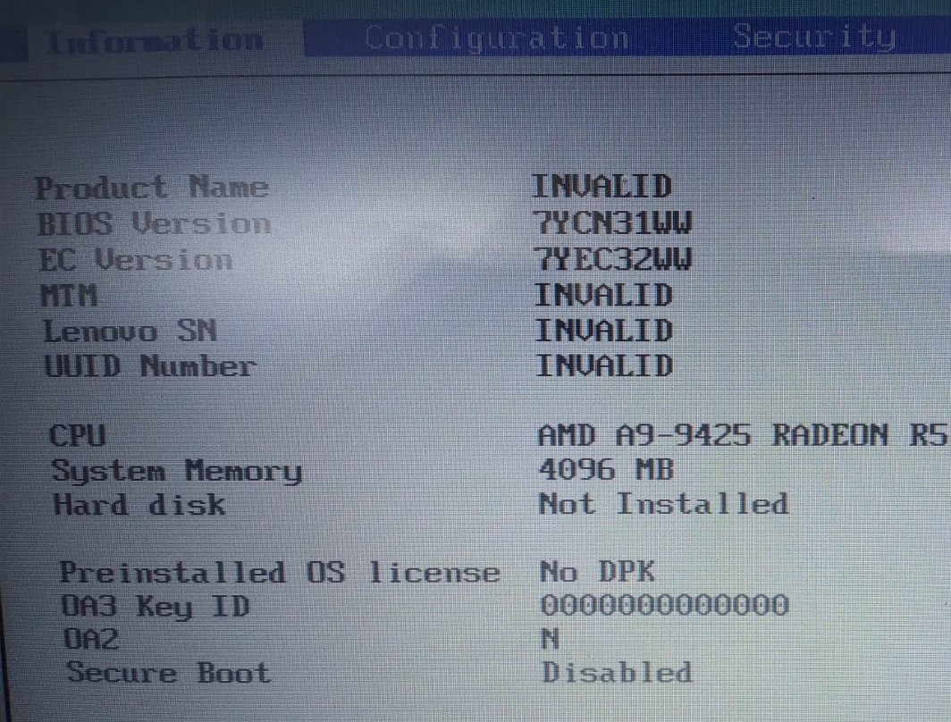

            Thank you now the laptop seems to be working, the only issue is that the information in Bios Screen says Invalid in several lines, but i think that would not be a problem for the laptop owner.

                  There isn`t a 2nd chip.Try this bios,your DMI (serial number etc) included, all the invalid sections will be filled in

                    Thank you, I will try this bios, thanks a lot
