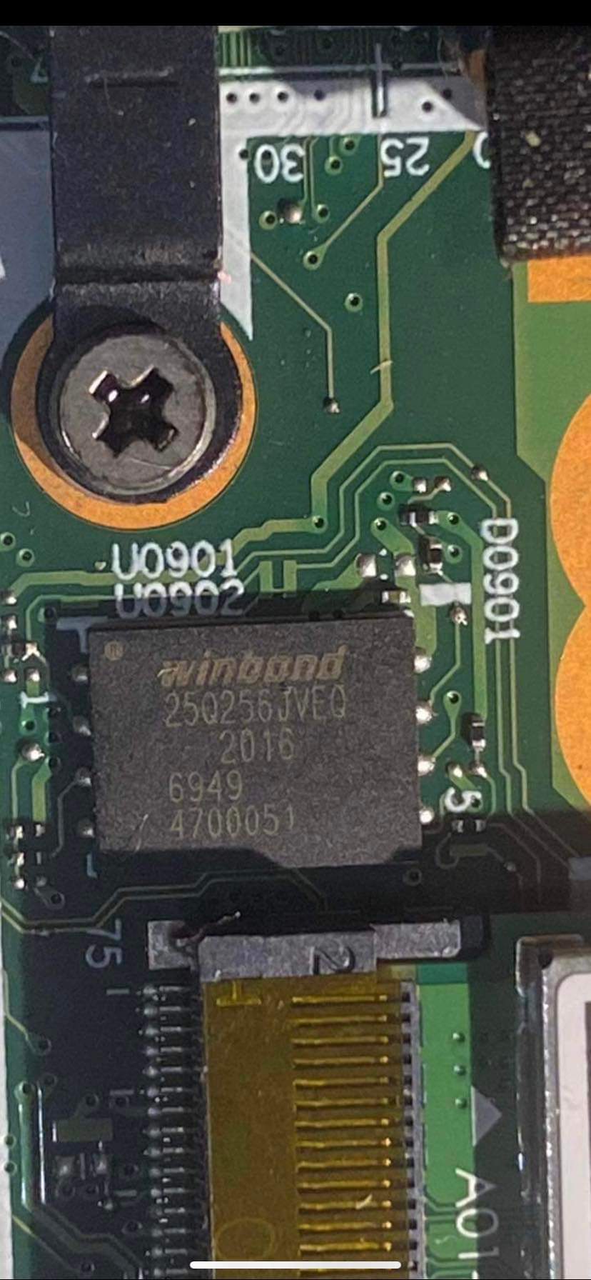

                  okay , i think this this is the bios chip i guess? would you know? Winbond-25Q256JVEQ

                    • 22279
                    Re: [REQUEST] Thinkpad L490 Bios file ?
                    You have found the correct bios chip,but,it is not in the support list https://www.hklrf.com/24download/img/EZP2019-List.txt .You can select a different chip instead, W25Q256 or GD25Q256 and untick the verify setting.The chip type is WSON8 you will not get a clip onto it,it must be desoldered and out into or on an adapter board, or run wires from the adapter board. The EZP programmers are problematic reading and writing anything 8MB or higher, in the manual its recommended to turn the speed down;
                    Quote:
                    Note: Some 8M or more chips are detect ID unstable. recommended to select the chip
                    manually. In addition, if some errors when reading and writing, please to lower the
                    speed.
                    Its essential that you make a good backup, don`t erase the chip or try writing anything to it yet
                      do you mean i should buy a replacement chip ?
                      or do you want me to try to flash W25Q256/GD25Q256 file ?
                      I bought ezp2019 with wson8 extension board ? should i need to desoldered it ?
                      Actually im not good in using solder iron , so if i can prevent to use it , i will prevent it
                      btw , if my chip is not supported do you have any bios flasher to recommend that can support my chip ?
