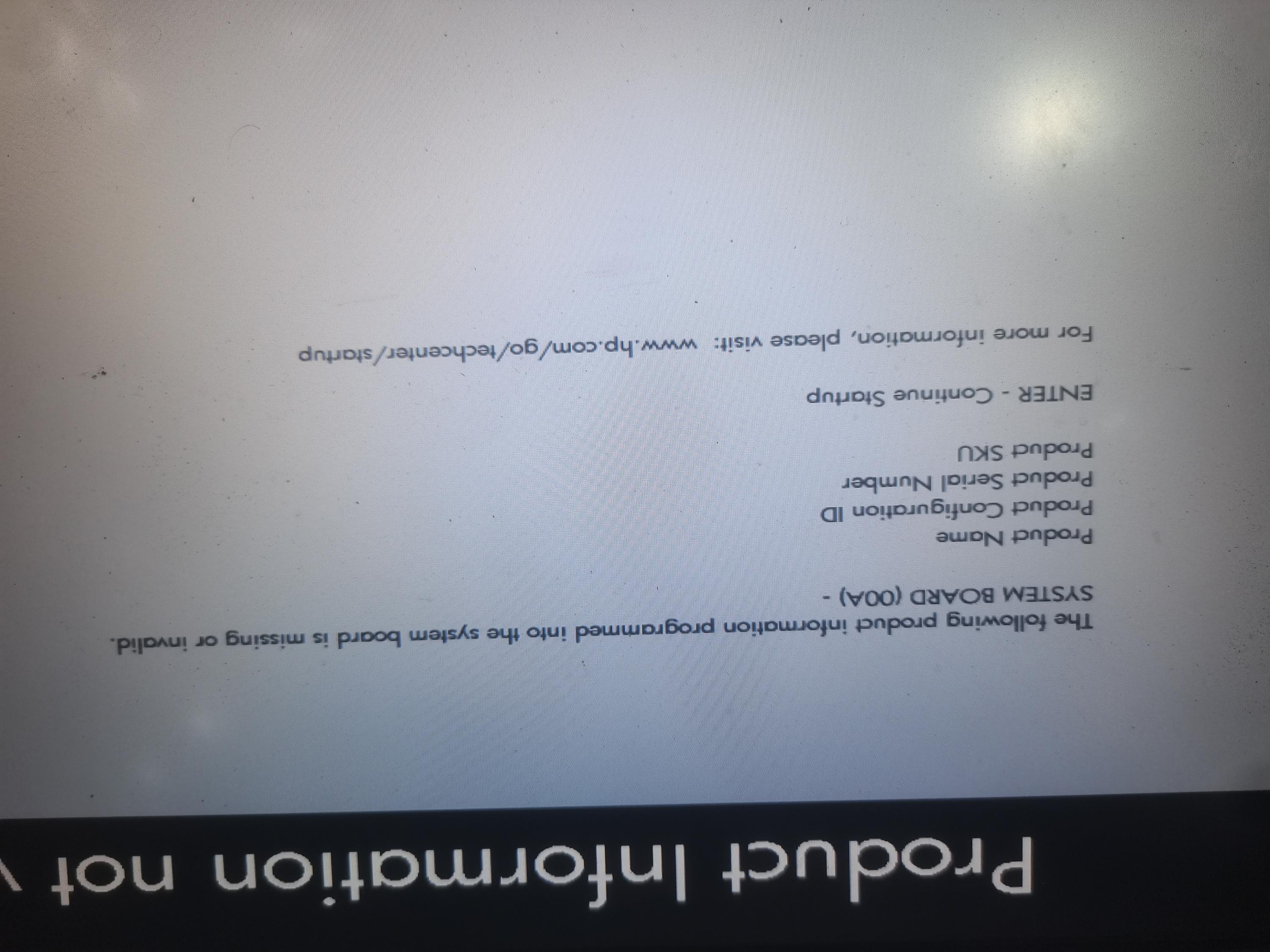

          The laptop start but black screen
          Laptop model : Hp probook 6550b 6050a2326601-mb-a02-001

            Re: Hp probook 6550b 6050a2326601-mb-a02-001 bios dump
            Originally posted by LightMad
            Here's my original bios dump and Serial number is: CNU1153JTF
            try...
                Originally posted by peste
                try...
                Now it's working but printing an error message
                  the DMI information is missing...try to write it with this program
                  https://www.youtube.com/watch?v=9T57ktw8n3Y
                    Thanks a lot! I working!!!!!!!!!!!!!
