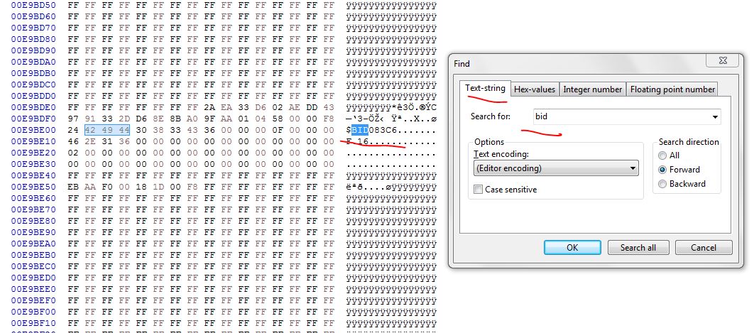

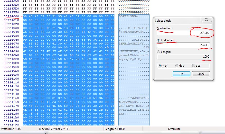

    Bios update from HP support https://ftp.hp.com/pub/softpaq/sp133...0/sp133147.exe ,download and run the exe,choose "save to a location" to extract all *.bin files. Your BID is 083C6 .Copy the DMI and key from your backup to the new bios using a hex editor. HxD hex editor https://mh-nexus.de/en/hxd/

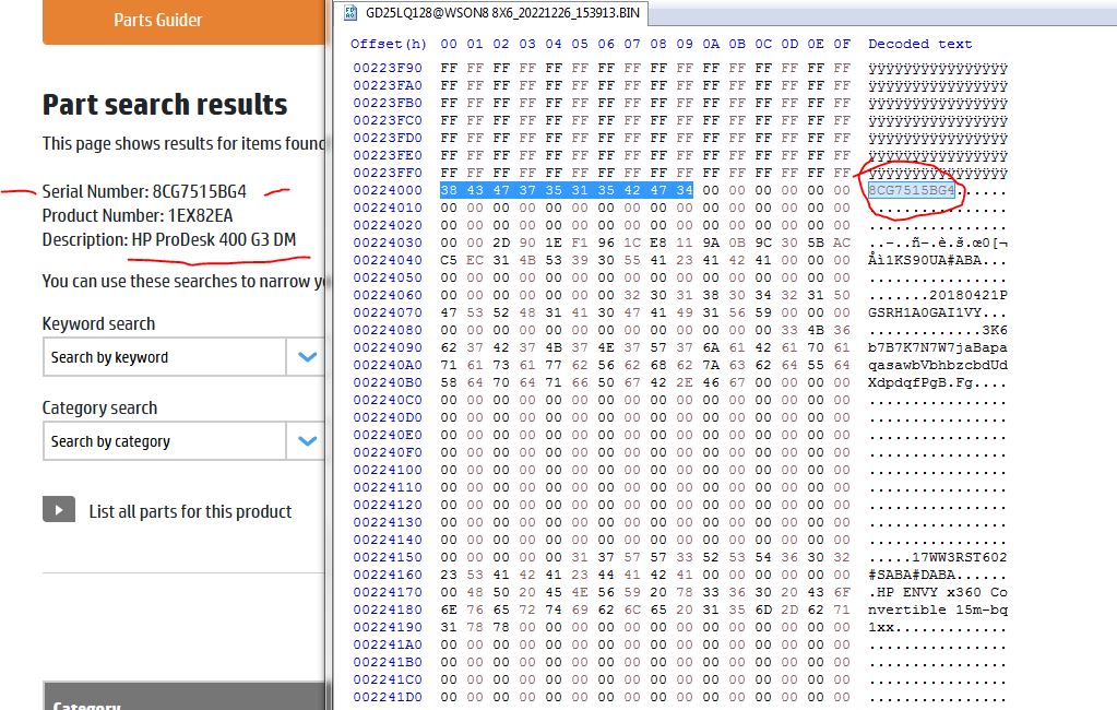

        Does your serial match the one in the 2nd picture.I just noticed in the picture that the model is 15-bq1xx so you could have the wrong bios. Flash both the bios you extracted,one of them will work,then you will have to use HP DMI tools to add the missing DMI info,or use a hex editor and modify the backup with your info,it might not work though as the place where the DMI is at those off-sets could be somewhere else in the 15-bq0xx model

              Here's your New bios file, it's a virgin bios from HP with your DMI and Windows Key.
              I got that file by your Product Number: 1KS90UA, because your serial gives me a PC!
                  Yes the serial is from a PC.Someone has had fun messing with it

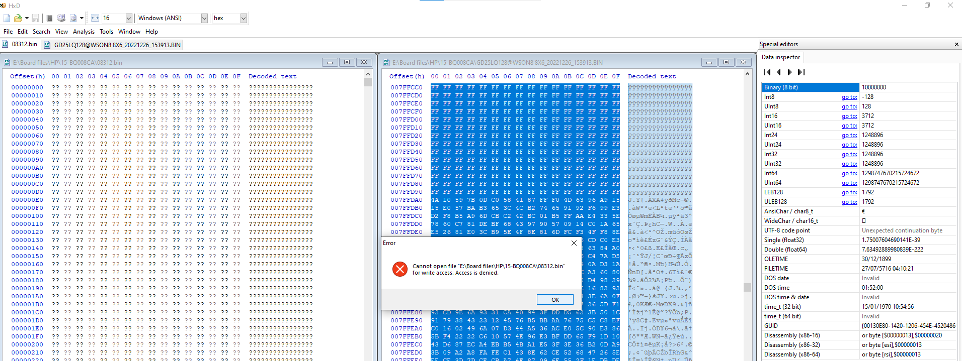

                          Please why do i keep getting access denied on the HXD editor, I cannot basically paste and replace hex values. I am trying to build the bios by coping the ME region from the dump at offset 0 - 7ffff0 and paste into 08312. Please help me.
                            Your CPU is AMD ,it does not have ME firmware.We`ve already established,eventually,that the bios you originally posted is fucked up and its the wrong size chip. 08311 and 08312 are the bios you should be trying,and flashing onto an 8MB chip
