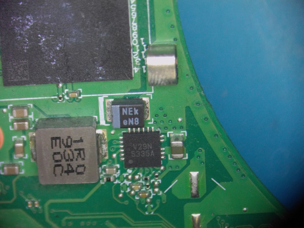

    Hello friends, I have this motherboard which does not turn on I have 19v on the entire motherboard but it is not able to turn on
    I can't find a diagram or something to guide me, I checked charger bq2480s, apparently it has everything ok, since it delivers the 25 v to the corresponding mosfet
    and then I can't find the 3 v and 5v always help me solve it please or if you need more information
    regards

    Re: DA0XKTMB8C0 rev. C does not turn on

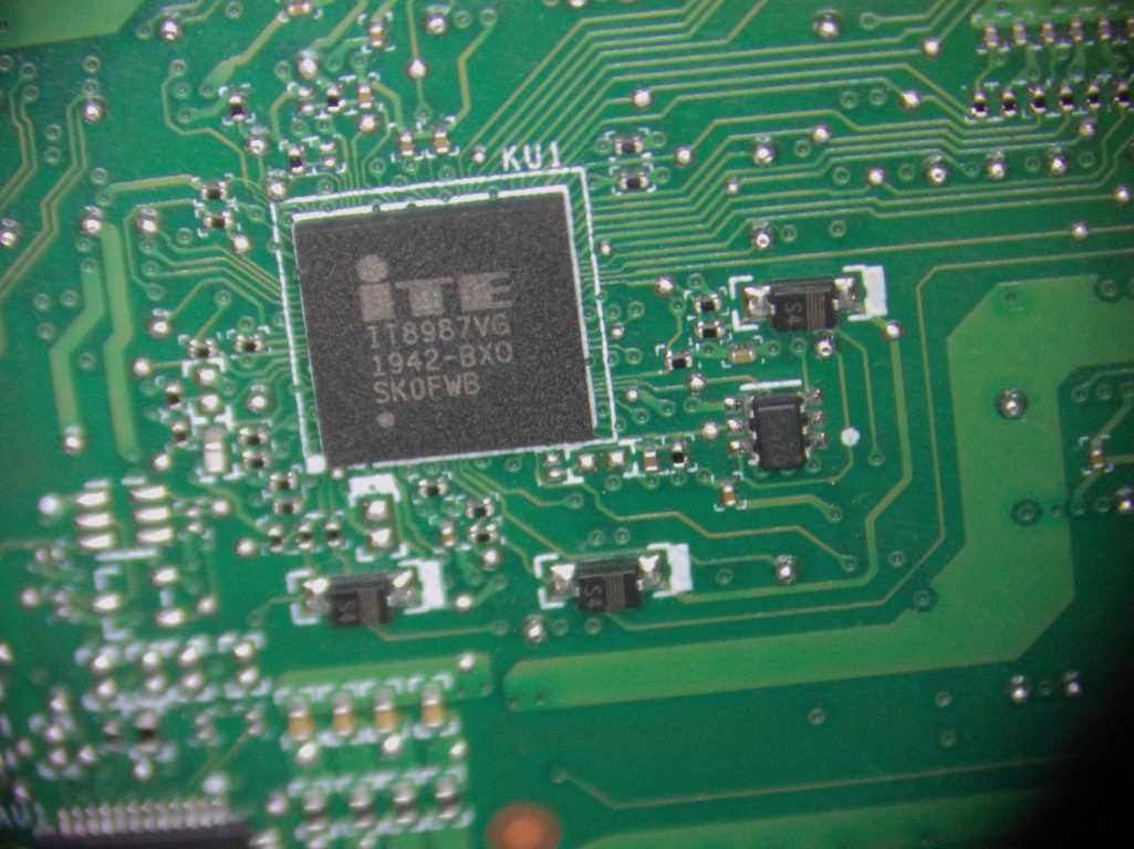

    Look for each and every PWM ic. there may be 2 separate IC for 3V and 5V or a single IC for both 3V/5V. Locate that IC first and give us the top markings of that IC. Which KBC is used here??
    You should share as much info as possible so that someone can suggest something. What you have described is not enough.

      sorry for the little info ,
      I will look for what you indicate, apparently it would be these ICs
      I will check again for more news
        No, this 5335 ic is not your 3V/5V PWM IC. Datasheet linked for GNT 5335.
        https://cdn.badcaps-static.com/pdfs/...ab6fd587d6.pdf
