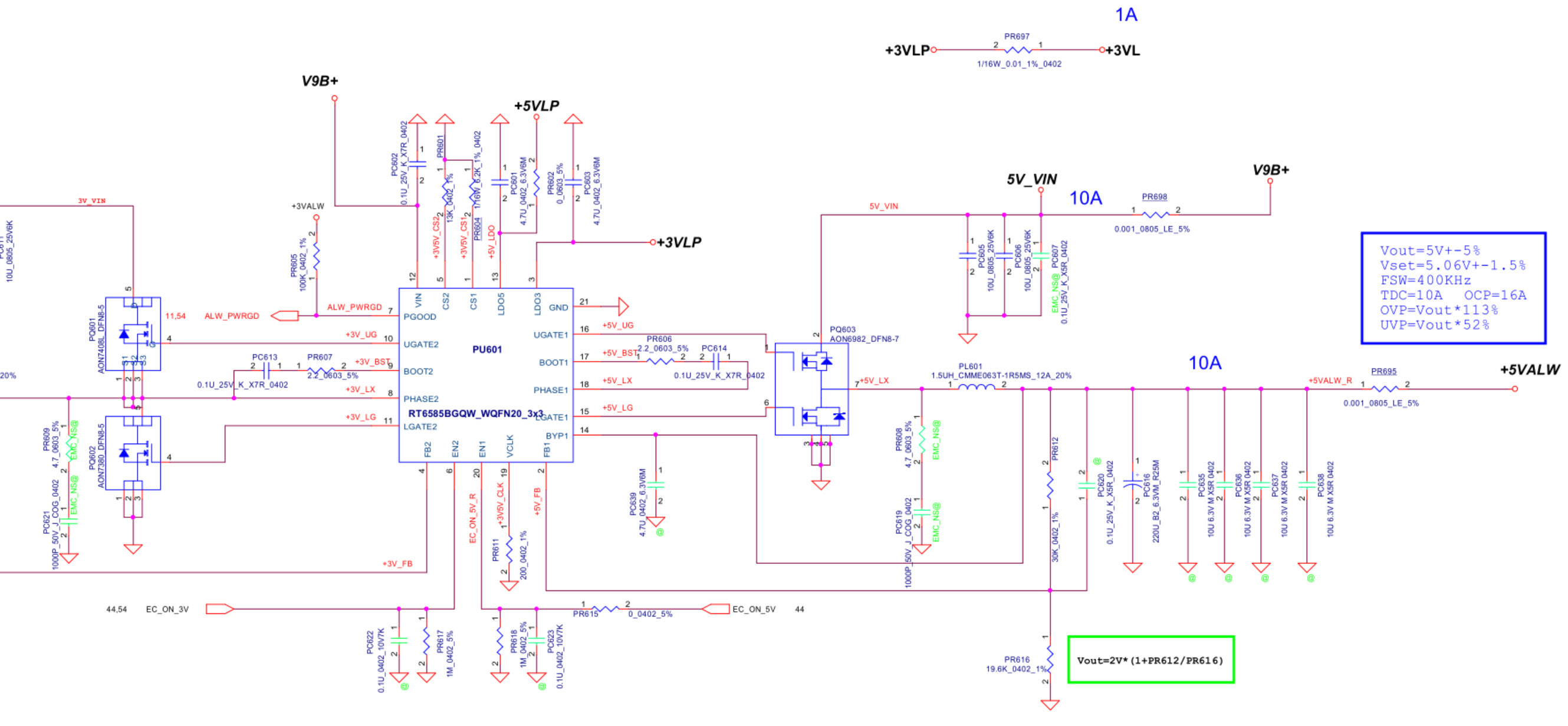

      Re: Lenovo C740-15iml no post, I do get 20V on charging port
      Attached (partial from paid database that locks the files).

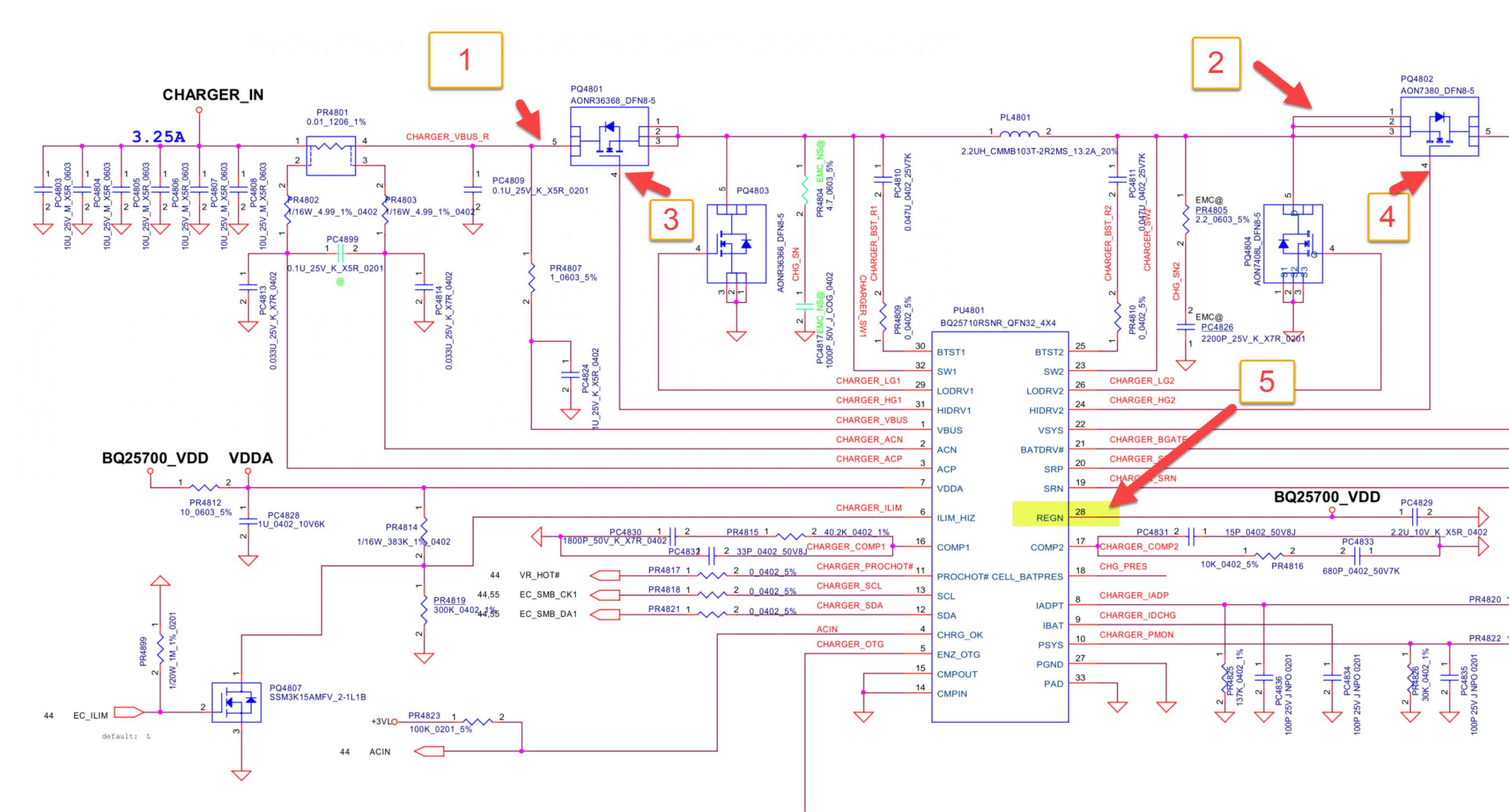

        PU601 is not being powered so start with the charger IC review. Likely you have at least one defective DCin mosfet.
        See attached. Measure the voltage to ground of each point of interest.

            mon2,
            I am getting the following based on your 5 test points with charger plugged in:
            Test point 1: 9V
            Test point 2: 1.97V
            Test point 3: 2.65V
            Test point 4: 3V
            Test point 5: 6.1V
            When charger is plugged in, my tester is showing 20V/0.172mA on charger. It then settles around 20V/0.75mA.
            When ran on battery only, I get nothing. Pushing power button does nothing.
                  From the schematics, the 9v is within range of the V9B+ power rail.
                  Can you confirm again that this voltage is not reaching pin #12 of PU601?
                  The same 9 volts should be present on pin #12 of PU601.

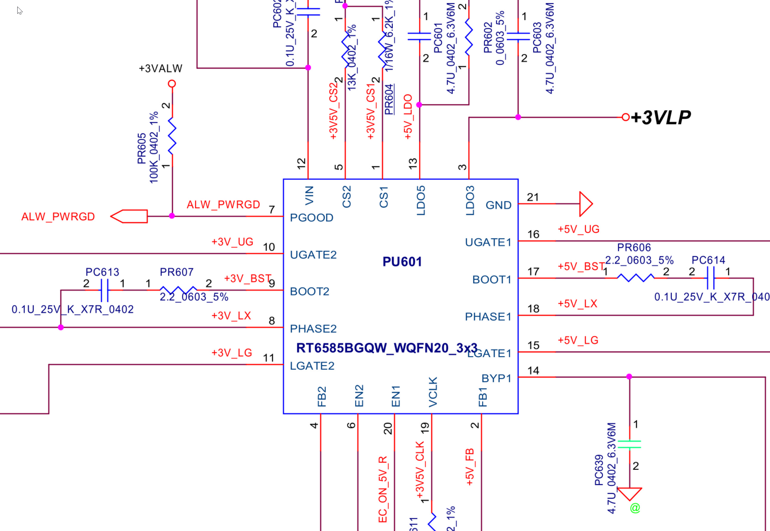

                            Based on your first post of this regulator being very hot, this component may be defective.
                            Remove all power. Meter in resistance mode.
                            Check the resistance to ground of
                            pin # 3
                            pin # 13
                            pin # 8
                            pin # 18
                            Post each measurement. Your always ON LDO rails are not working as well so something is wrong. Either you have a high load (ie. shorted cap = low resistance) on the rails or this regulator is damaged.

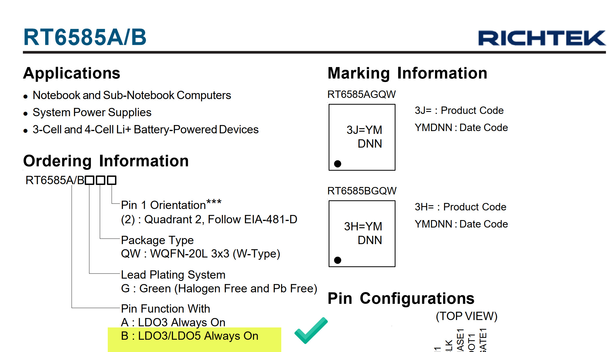

                            Full p/n is RT6585BGQW ; the 'B' in the suffix means that the fixed LDO regulators on pins # 3 and #13 should be always ON. The LDO rails are linear regulators that lilterally take the higher voltage as input (9 volts for your case) and 'burn' it down to the desired 5v or 3v. There will be some heat generated but not to be too hot as you are observing.
                            Respectively, you do not have the proper and expected voltages on these pins.
                            Datasheet for this regulator is attached.
                            You can order the replacement part from Digikey (USA) and recommend that you purchase at least 2 of them for a replacement:
                            https://www.digikey.ca/en/products/d...5BGQW/16376744
                              I have the following resistance to ground on PU601:
                              Pin #3 38.2 Ohms
                              Pin #13 717K Ohms
                              Pin #8 15.3K Ohms
                              Pin # 18 35.36K Ohms, this one jumps up and down a lot but settle around that.
                              My first thought was that this chip is toast but I am not experienced enough to make that call. What do you think?
                                Pin3 is for 3V LDO and is clearly shorted. Remove this IC and check resistance on pin3 again. If resistance goes up significantly in Kohms, then IC is bad. If resistance remains same after removing this IC, then you need to inject 1V on this pin from dc supply and see what is getting hot. very likely it will be KBC and/or PCH.
