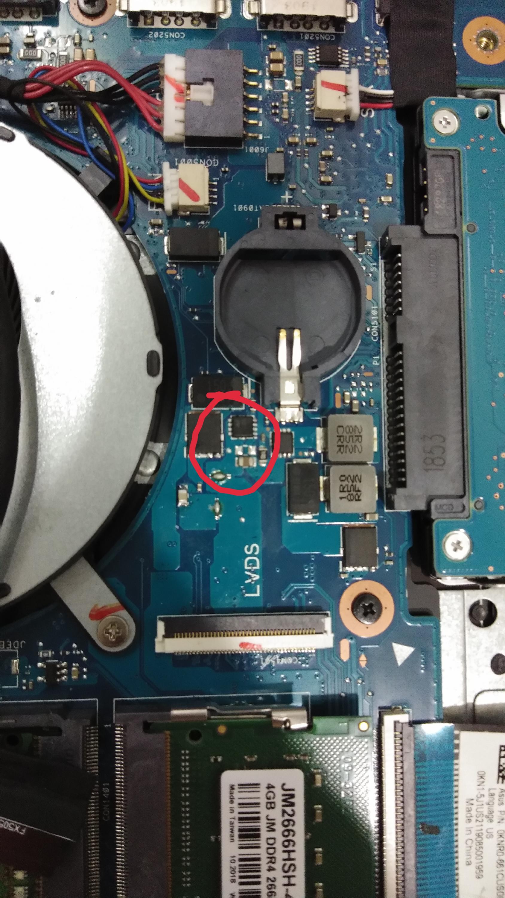

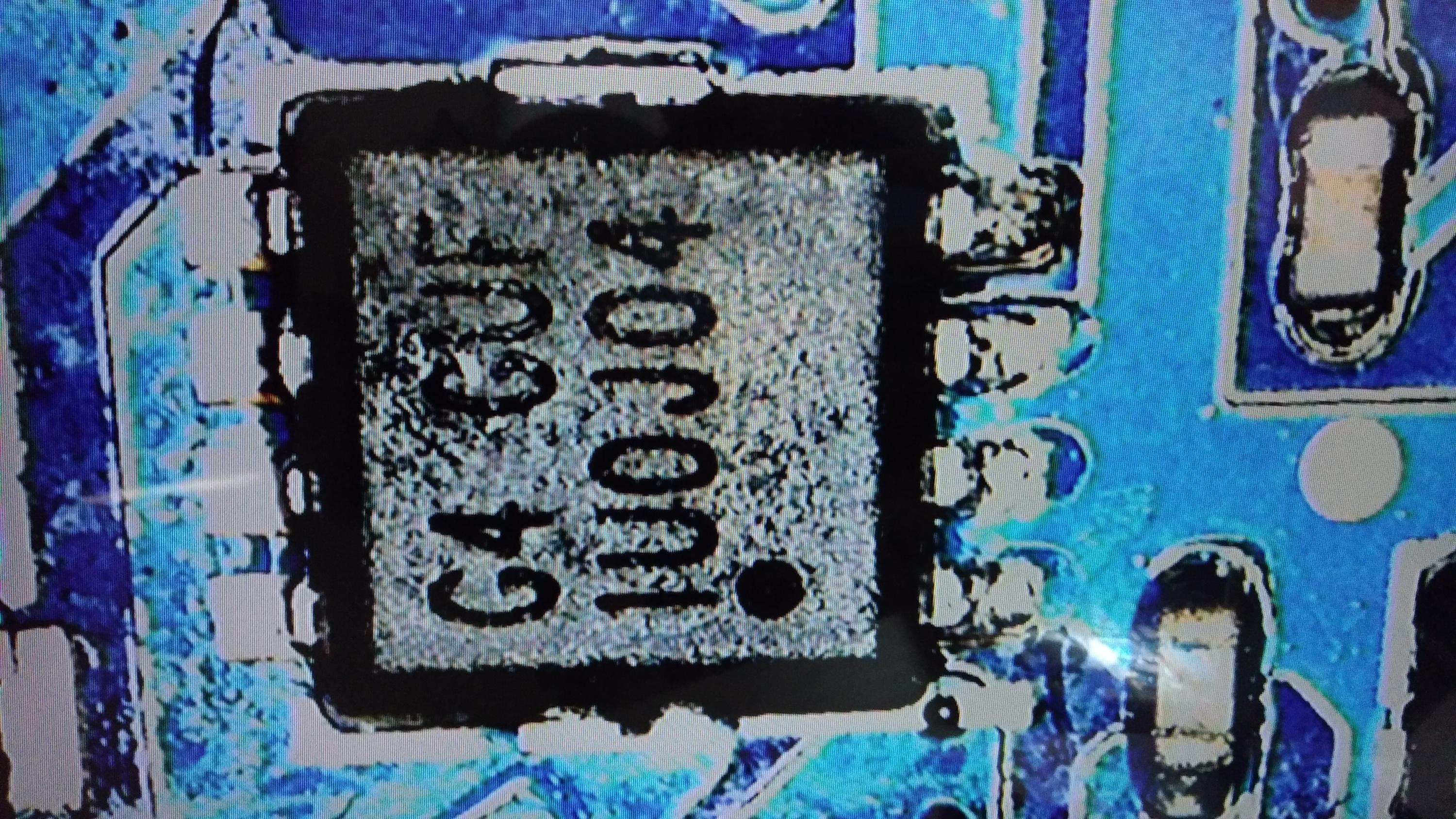

    Greetings everyone. I'm working on this Asus motherboard and one of the cap shorted out. I guess it took along the Mosfet in the pic with it. I tried to google the Mosfet, but I couldn't find any details. Hope someone can help.

    PE616BA https://www.badcaps.net/forum/showpo...65&postcount=4
