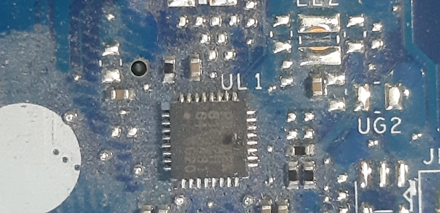

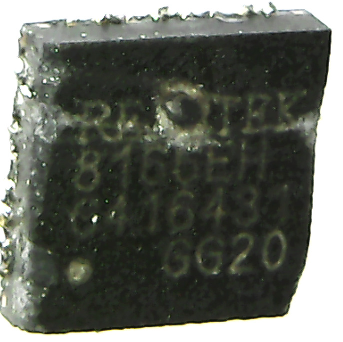

    BDL50 LA-703P dead
    When I turn on the motherboard, turn on both leds on the network adapter and after a few seconds, the motherboard will shut down and not making the POST
    The chip RTL8166EH G416431 CG20 has a bump suspect, according to You could be the fault?
    I attach the photo of the chip.

    Re: BDL50 LA-703P dead
    Yes, to me, this ethernet controller is damaged and should be replaced. With a datasheet or reference schematic that uses this controller, you can check the resistance to ground or diode mode readings of the pins.
