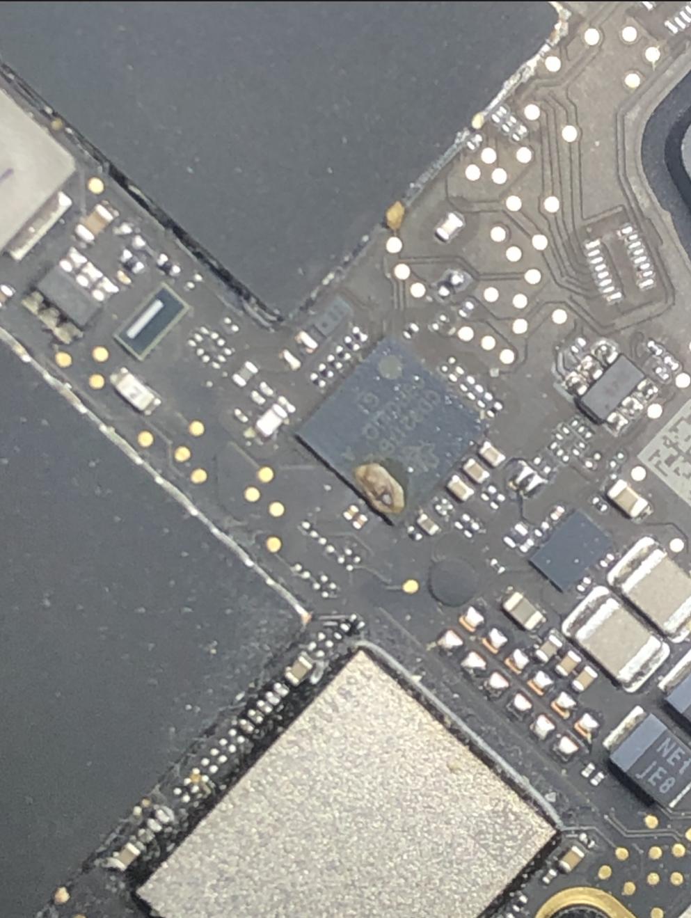

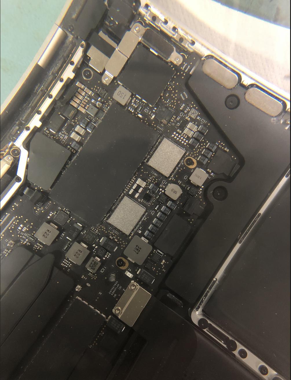

        Thank you for the guidance and offer to support. I don't have a USB C measurement device but I don't think I need one. See the attached photos, CD3217 has a hole burned on it. I don't think it will generate the 20V for the logic board or charging.
        What puzzles me though was the fact that even after I felt the burning and smoke the laptop continued to run. I shut it down after the smoke and let it cool down for half an hour, tried to restart and it restarted with a warning about USB port not working. It worked until the battery was completely empty.
        This gave me the idea that if I would recharge the battery from outside that it would boot. But it didn't boot. I am guessing that the battery controller was in a state to enable power output to logic board. But once the battery was completely depleted it needed an external stimuli to enable the output.
        Anyway, I will replace the burned CD3217 as a first step. I am hoping this would solve the problem. If not, then I would definitely need your valuable expertise.
