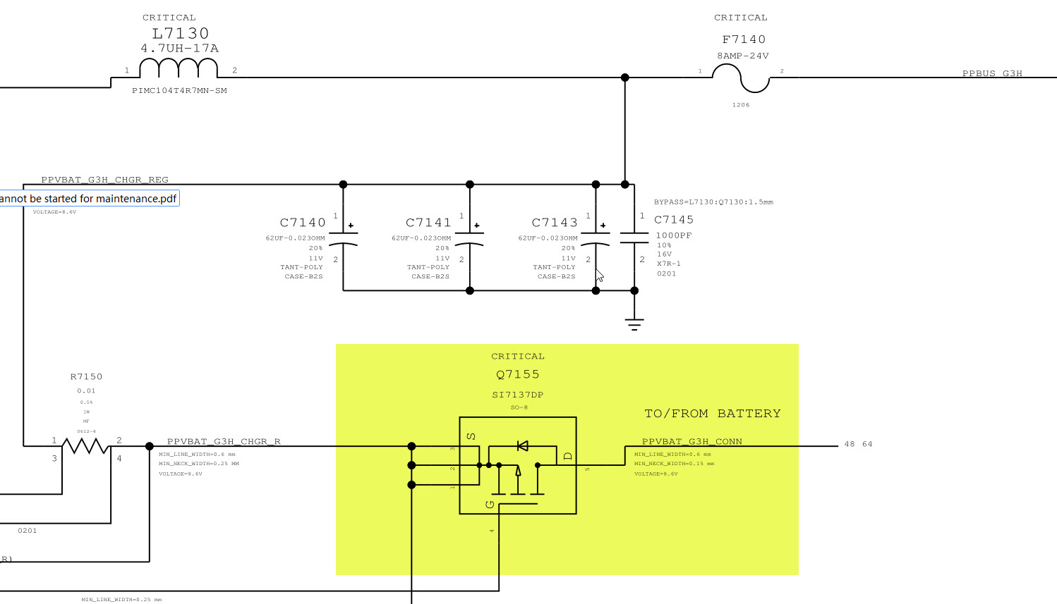

    Macbook Air A1466
    Starts once after battery removed, then when powered off won't start no more
    Keyboard works, no liquid damage seen, power on pads also not working

    Are you using the official power adapter ?
    Do you see the green / orange light on the adapter ?
    Does the unit function with only the adapter ? (no battery)

      Adapter/charger original
      Shows green/red
      Battery removed it turns on instantly as supposed

        What is the 820-xxxx board # ?

          820-00165-a

            See attached. Remove all power / no battery.
            Meter in resistance mode.
            Check the resistance across the battery mosfet @ Q7155.
            source (1-2-3) & drain (5-6-7-8)
            source (1-2-3) & gate (4)
            gate (4) & drain (5-6-7-8)
            Post each measurement. If the meter shows '1' or 'OL' -> then switch to a higher meter scale to take a measurement.
            If the resistance is too low, the mosfet is likely to be defective and must be replaced.

              source (1-2-3) & drain (5-6-7-8) 105k
              source (1-2-3) & gate (4) > 500k
              gate (4) & drain (5-6-7-8) > 600k

                With the battery removed and using only the external power adapter, what are the voltage readings of this battery mosfet ?
                Pins:
                Source (1-2-3)
                Gate (4)
                Drain (5-6-7-8)

                  Power button on the keyboard is usually the culprit; this is seperate to the rest of the keyboard and not muxed by the trackpad. With no power applied, check pin 20 on J4800 for a short to ground when power button is pressed.
                  SMC_ON/OFF_L is pulled high by R5170 to 3.42V, power button shorts this line low.

                    Solved!
                    Thanks all
                    It was a strange high leak on TouchPad, SCL related.
