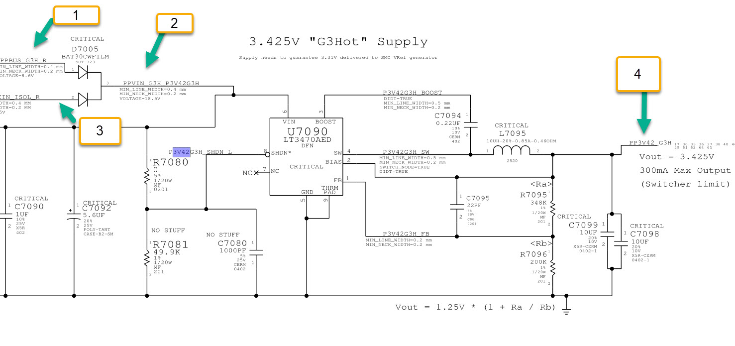

    You need a solid voltage on PP3v42_G3h at 3v42 to see the green / orange lights.
    If this voltage is ok on the main board then you may have contact issues on the magsafe connector.
    Remove all power and confirm seating of the LIO cable and daughter board that has the magsafe connector.
    With IPA and a cotton swab, clean the contacts on the magsafe connector. Test again.
    Be sure the power adapter is an original.

        Re: Macbook Air 820-00165
        Measure and post the voltage checks of the attached points.
              Hi, i have a noob question but i am unable to read this schematic. Can you please tell me the components?
                Measure at L7095.
                  Measure at L7095.
                  Its 3.42V on both ends of L7095.

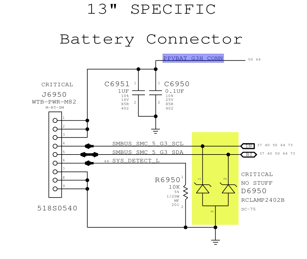

                              Thanks it worked. Reheated and reballed a couple of ICs and the mac works fine now.
                              1 issue is there that it only runs on a power source. Tried replacing a known good battery but still the same issue. Any help?
                                measure the voltage to ground of each SMBUS pin (SCL & SDA) on D6950.
                                  Voltage at Pin # 1 SCL is ranging from 2.5V to 3.7 Volts
                                  Pin # 2 SDA is 1.6 Volts to 2.4 Volts
                                  These are voltages with only the charger connected.
                                  PPBIS_G3H is about 11 Volts which i think is very high resulting into not charging.
                                  P.S It shows not charging . Doesnt show the Cross sign on the battery.
