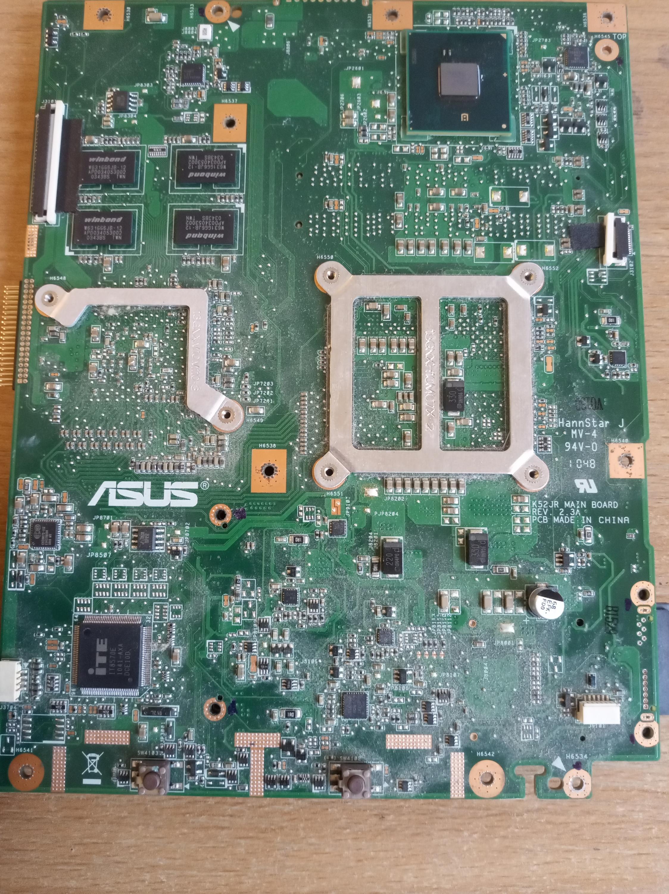

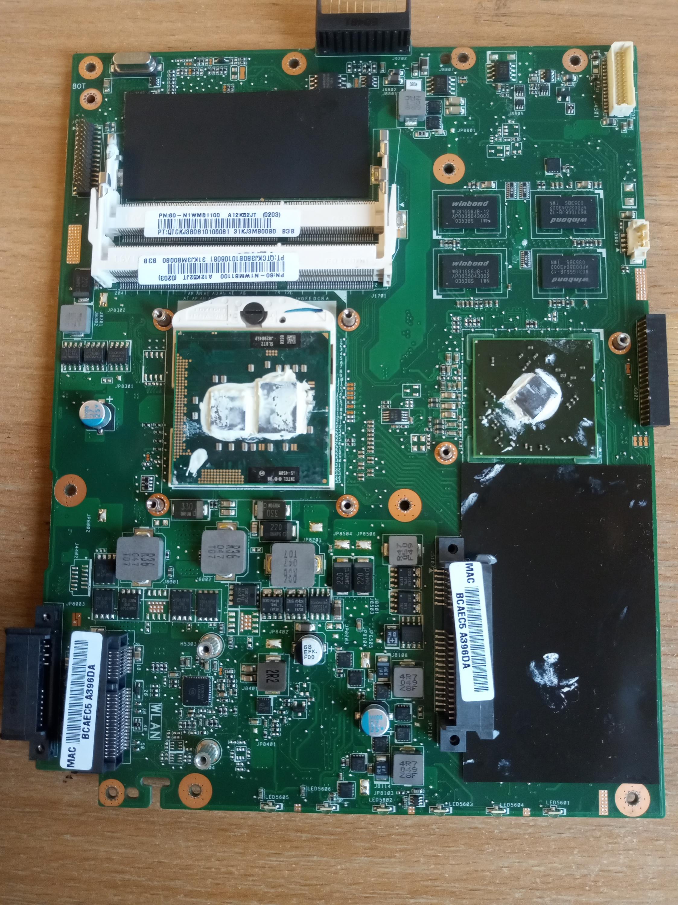

      Thank you for your reply. I disassebled the laptop and here are pictures of mainboard.
      Unfortunatelly I did not find any BQ charging chip.
      Is there avaiable schematic for this kind of mainboard?
      Thank you for help

        Your pics help.
        Focus on the logic board under p/n K52JR - found lots of hits for boardview files using this reference (no schematics). Will review and post some files that may be relevant.

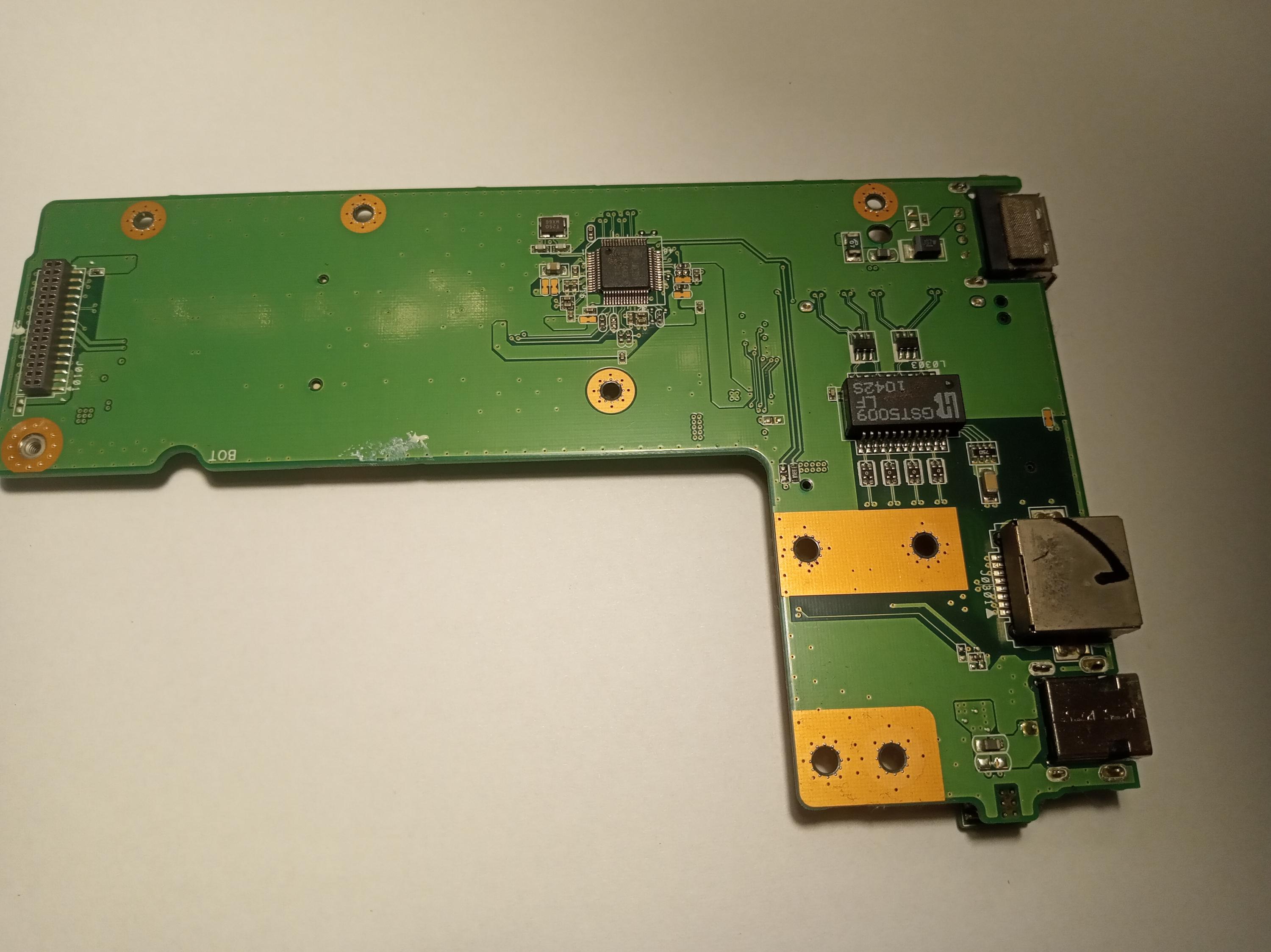

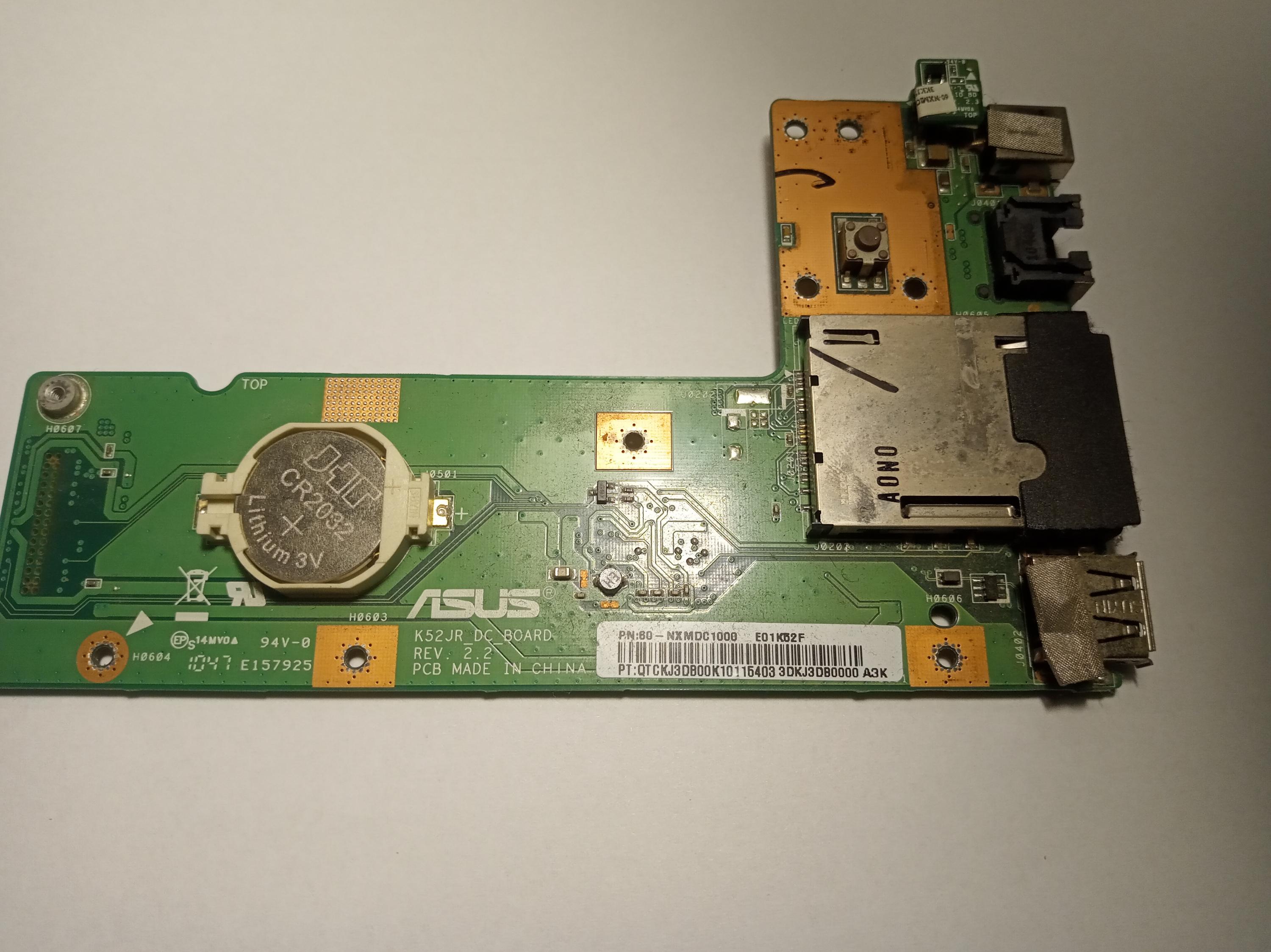

        Is there an external DC board that connects to this main board?
        Can you post pics of that board as well ?

          Here are pictures of the external board.

            Re: Asus A52J does not work without a charger
            Remove that black tape between ram slot as charging ic may be located there.
