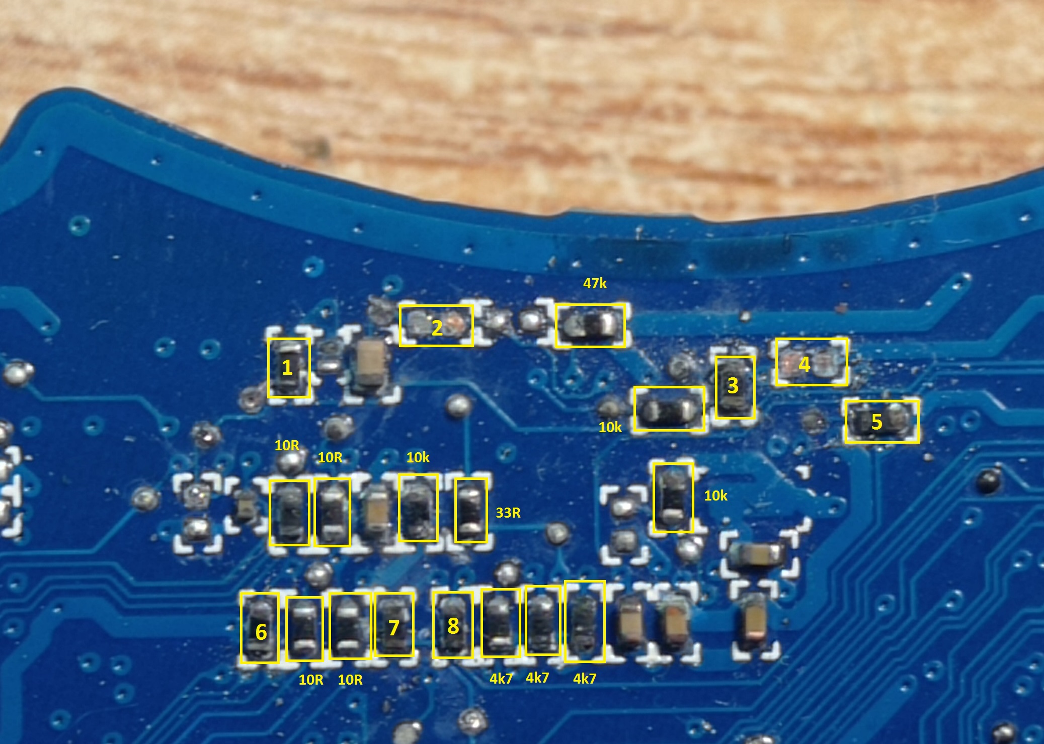

    Good time of the day.
    Have mentioned motherboard which stayed with liquin on for a time. A group of resistors under SIO is damaged with no possibility to measure them. If someone have this motherboard, please help to identify values of resisters marked 1 - 8 on attached picture.
    All these esistors located under SIO.
    Thanks in advance!

    Re: Quanta DA0G7BMB6D1 resistor values
    seems no schematics or boardview available fot this motherboard
      See if this matches
        Seems some resistors which are strapping of SIO correspond to this schematics.
        According to it, 1=33k, 5,6=10k 7,8=4.7k. Identity of rest of resistors stay unknown.
        Liquid damaged only these resistors, all power sources unaffected, seems thah CPU is alive. Would be good to identify rest of resistors.
        Currently board runs LDO 3V, no reaction to power button.
