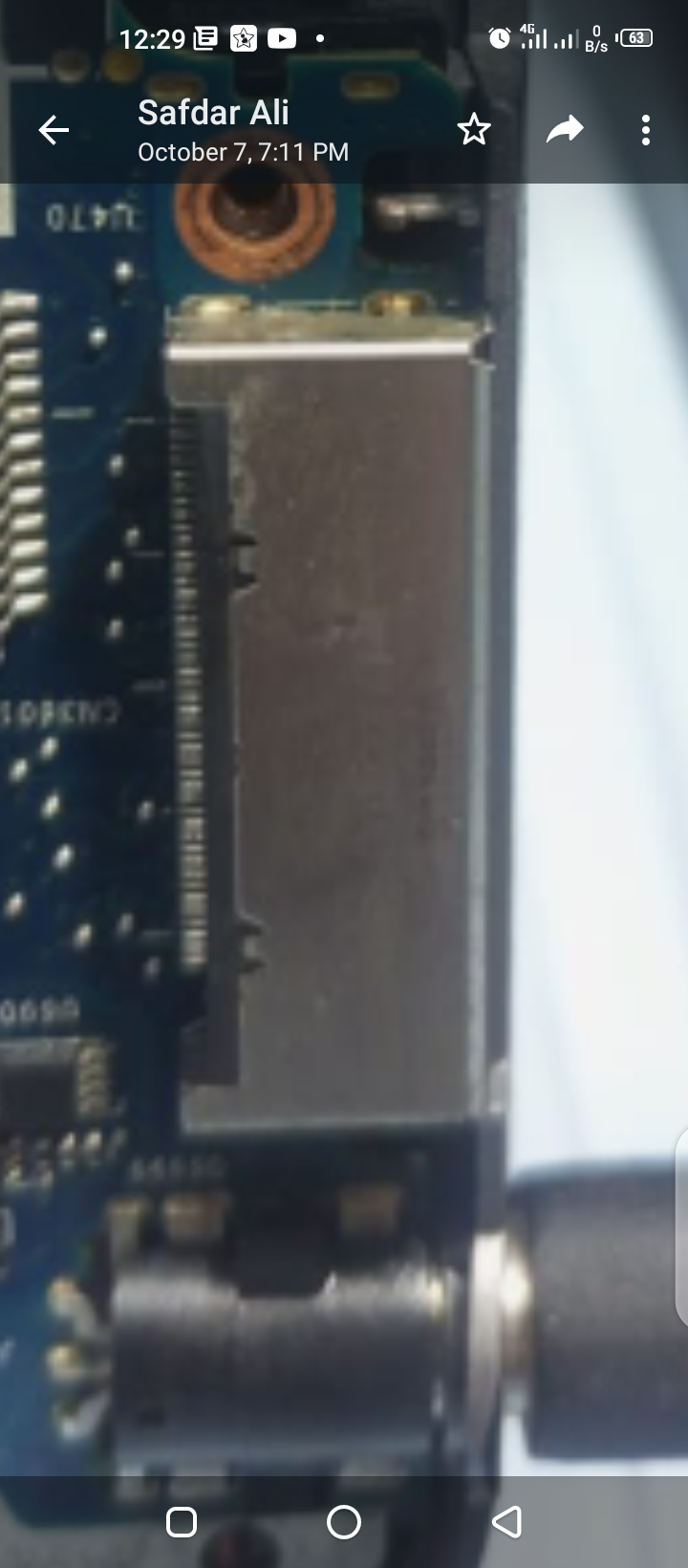

            • smali
              • Sep 2014
              • 287
              • Pakistan
              Re: HP EliteBook 840 g3 with strange problem
              @classicandy
              Clean this( mentioned in pic) Dock connector with alcohol or others cleaning materials and then gave some heat with heatgun for removing carbons and dryness... In these mb this connector making a lot of problems.
