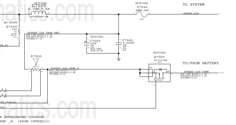

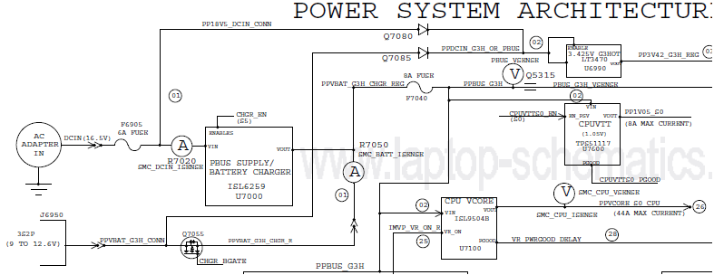

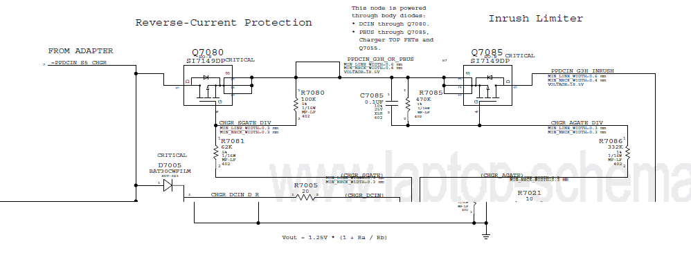

    Hi, I am a beginner, can you help me to understand how is PPV42_G3H generated by the battery without when the charger is not inserted in this particular model? I can't see any direct connection between the battery and U6990 (which generates PPV42_G3H). From the schematic page "Power System Architecture" it would seem that there is continuity between PPVBAT_G3H_CONN and Q7085 but from the schematics and boardview there isn't. Also, from the page "Reverse-Current Protection" it says: "This node is powered through body diodes DCIN through Q7080, PBUS through Q7085 and Q7055". But from the same page there is no connection between that node and Q7055! I also checked with boardview

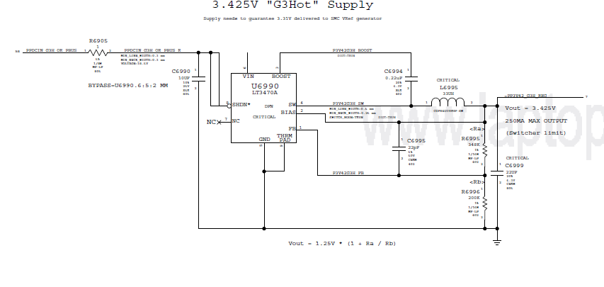

    U6990 generates the 3v42 rail.
    The VIN of u6990 should have a dual diode with common cathode junction.
    This dual diode accepts power from the external power adapter or ppbus_g3h.
    When adapter is absent, ppbus_g3h will power this 3v42 rail which is now in battery mode.

      Please check the attachments. In this particular schematic there is no dual diode and no connection between ppbus_g3h and u6990

        My bad..this logic board is different. The others will have a dual diode.
        For this case, follow the INTERNAL diodes inside of each mosfets between the battery and the VIN of u6990.

          Perfect, thank you!
