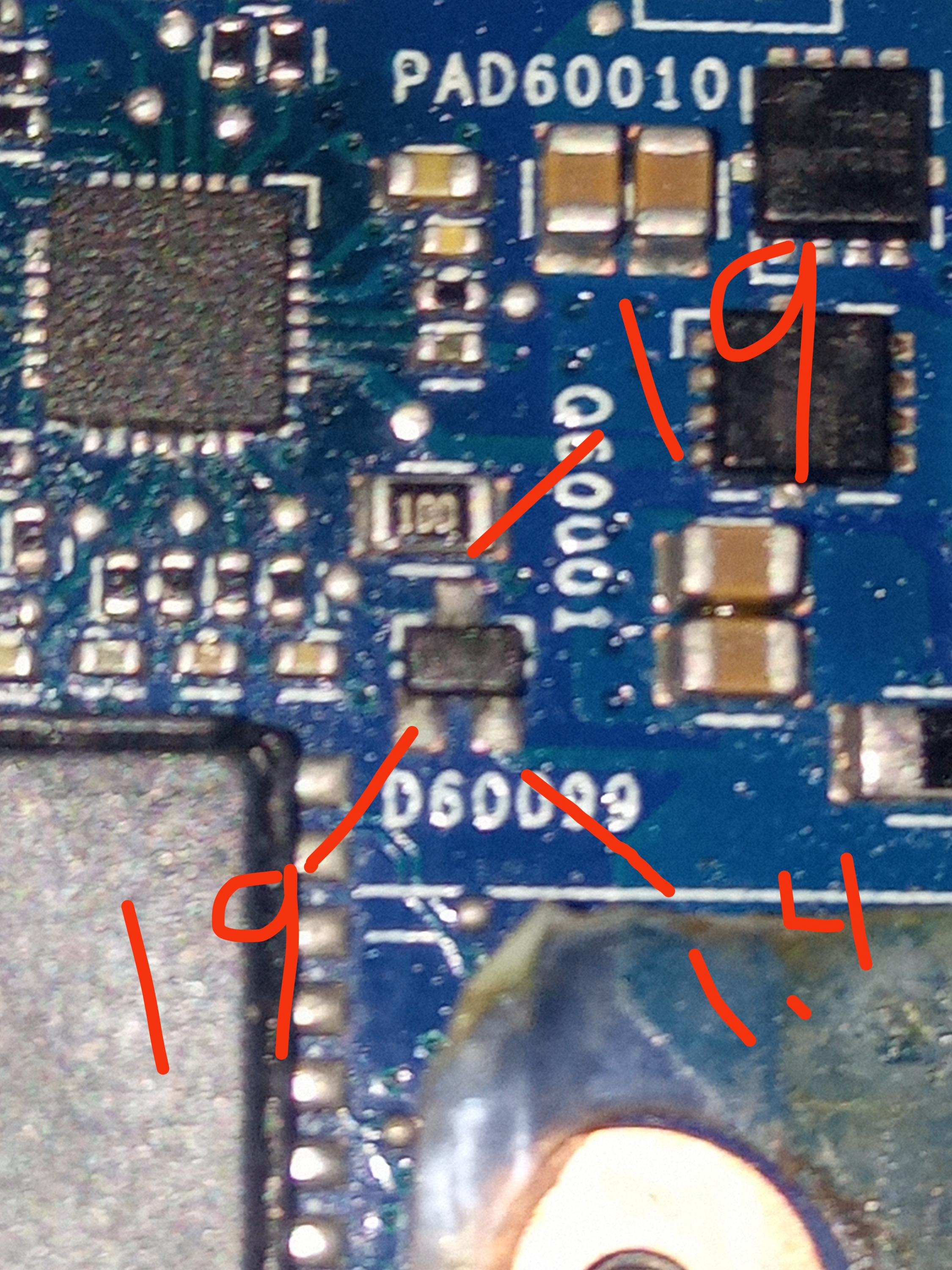

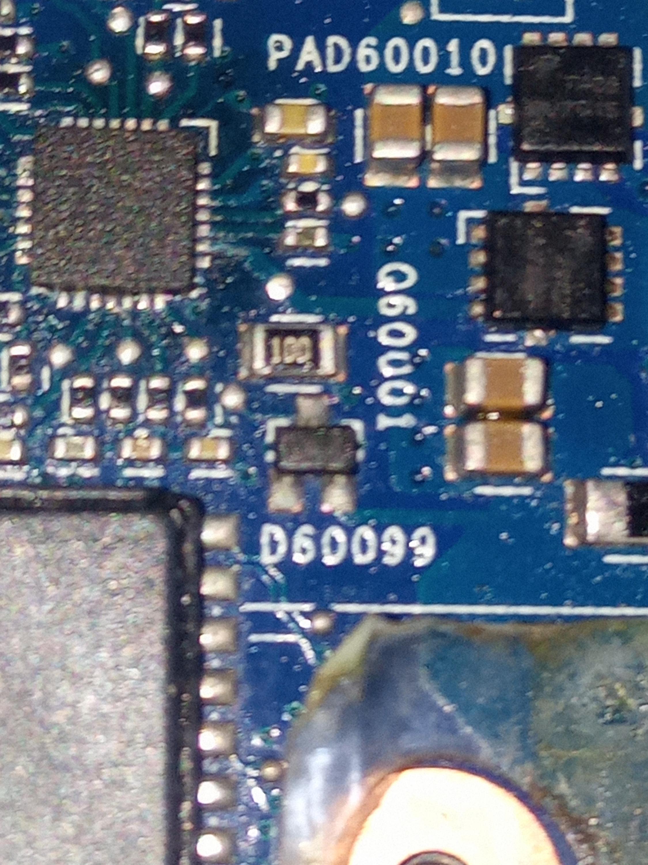

    hp 640 G2 charging issue
    hp 640 G2 when i connect charger the charging sign apear for 2 sec then its stop and the lap plugedin but not charging
    the charge ic number is BQ24780
    pin 1 acin = 19 v
    pin 2 acp 19 v
    pin3 cmsrc 19 v
    pin4 acdrv 24 v
    pin 5 acok 3 v
    pin 6 acdrt 2.5 v
    pin 7 iadp 0 v
    pin 8 idchg 0 v
    pin 9 imvp8 psys 0 v
    pin 24 chg regen 6 v
    ther is a diod its number is D60099 which there is 19 v on two legs of its legs and the leg which connected to the battery coil has 1.4 v

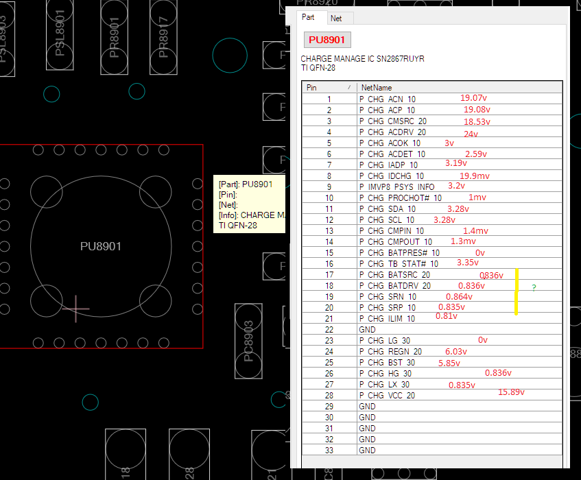

        The VCC pin #28 on the charger IC looks low for the DC adapter voltage that is coming into the board.
        Double check that part of the circuit.
        • bembeno
          • Feb 2016
          • 309
          • egypt
          Re: hp 640 G2 charging issue
          pin 28 = 19 volt
            the 2 mosfet in charging circuit the uper one has 19 on the drain 0.485 on gate and 0.485 on source and lower mosfet has 0.485 on drain and 0 on gate and 0 on source now the output volt to the charging coil is 0.485
            • bembeno
              • Feb 2016
              • 309
              • egypt
              i changed the charging ic BQ24780 with BQ24780S now the output = 12 volt and now the laptop is charging thank you man
