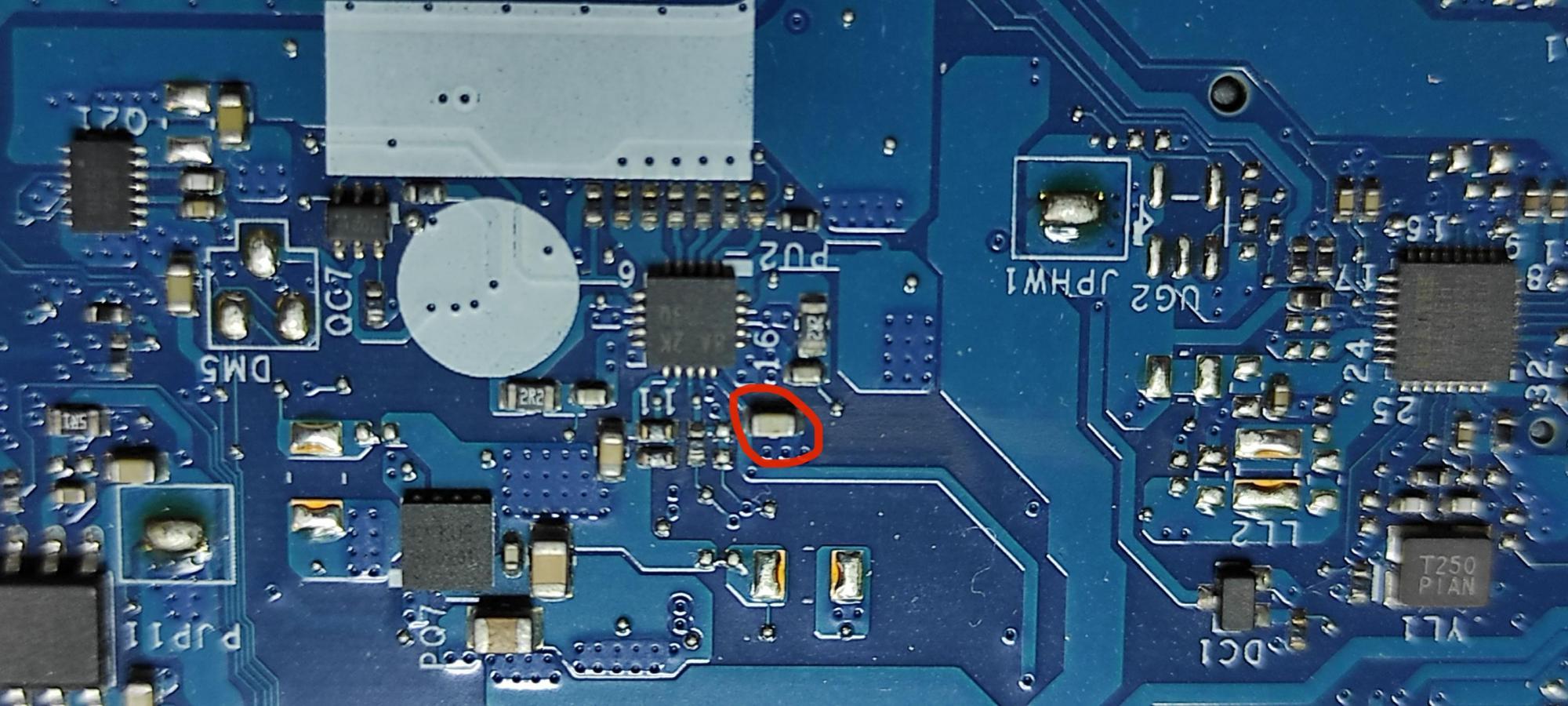

    Originally posted by Andreasbest
    I tried it no change, still getting onlily 0.0011A and resistance 1.7kΩ
    you are facing strange things. I have no idea how its possible. anyway have you cleaned all liquid damaged areas with alcohol?? If not first clean the board. Then lets try to start again.
    Edit: If you can heat the board using hotgun I guess some solder points will make a good connection.

      Re: HP 15-ac126nv no power at all
      Strange things indeed, somebody told me that might be capacitor ready to die.
      Yes all damaged area is cleaned with isopropylene alcohol
        as I know capacitors should heat up if they defective. Can you heat the board. To make good connection on solder points
        After that, check resistance on PU2 all the pins. If the resistance are okay, sold pu2 and pq7 back and check. I Dont think 1.7kohms allow PU2 to heat up. (according to the calcuations)
            LDO3 resistance at 1.7K is too low. have you removed the KBC??
            Btw, what is the resistance on PL12 coil??
              Not gonna put the mb to over or resolder everything, not worth the time.
              Any other idea?
              I suggested it because I see resistance keep changing. May be contact issues. anyway, then we will have to test all the endpoints who use +3VL
              I saw you have mentioned that you removed a capacitor. Who was that?? Can you remove PC46 (marked in the image) and test resistance again on pin 15.
              Anything changed??
                No KBC not removed, only PU2 and PQ7, i'll check resistance Monday because i'm again away from the bench and let you know.
                I only removed the capacitor next to pin15 of PU2 but it's working fine, not shorted.
                I'll try PC46 on Monday and let you know.

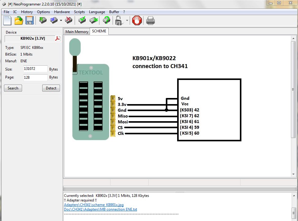

                      So KBC needs programming as you told me so the motherboard goes to donor, can you confirm this at least
                        you will be able to find programmed chip. So I suggest to replace KBC.
                        PS: If you have time,I guess you will be able to use Raspberry or arduino to program KBC. Just an idea. still had no chance to try.
                          KB series sio used on this mb is definitely programmable and there are pre-programmed chips available in market. So give it a try or else take it to someone who has the tools. KBC programmer is a must if you earn money from this business as almost all the mb has programmable kbc chips these days. I dont know whether raspberry/arduino can program kbc but i think its not possible.
                            Here is the guide I found from youtube. He use CH431a programmer to program KBC.
                            https://youtu.be/GQGH6yZuXCc
                            I was able to flash lot of bios chips using Raspberry pi 3. the software I used was flashrom. Anyway I guess we can use same method to flash KBC.
                            I can guarantee Its possible to flash Bios Chip using Raspberry pi

                              I have CH431A but i have some questions:
                              A) Where do you get the dump)
                              B) How will i identify a already programmed and a nulled one?
                              On ebay i only see the KBC chips, none mentions "preprogrammed" etc.
                                  A) You can find them from internet. try to request dump from the bios section of this forum.
                                  B) I see pre programmed chip on Ebay. Mention the KBC No. I will try to share a link
                                    NeoProgrammer software for the CH341A .Its better to invest in a proper IO programmer though, as mcplslg123 said "KBC programmer is a must if you earn money from this business as almost all the mb has programmable kbc chips these days."
