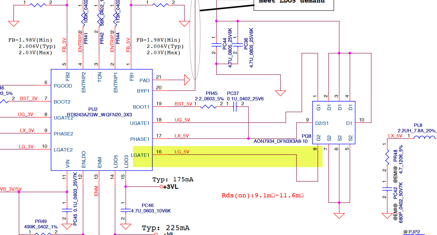

    I noticed that PU2 ( RT8243AZQW ) gets extremely hot indicating a shortcircuit, should i replace it right away OR should i check something else first that perhaps causes the short and PU2 is good?
    Schematics attached.

    Re: HP 15-ac126nv no power at all
    If the part is heating up more than normal then there is a fault.
    Remove all power. Meter in resistance mode.
    Check the resistance to ground of each output voltage rails on this component.
    Post all measurements. If a reading is very low, then need to locate the reason. Perhaps this part is now defective from this event.
      I remove the PU2 and measure resistance to all pins, all look fine with high resistances to GND 10's ok kΩ except pin 16 that is only 6Ω.
      Is that normal?

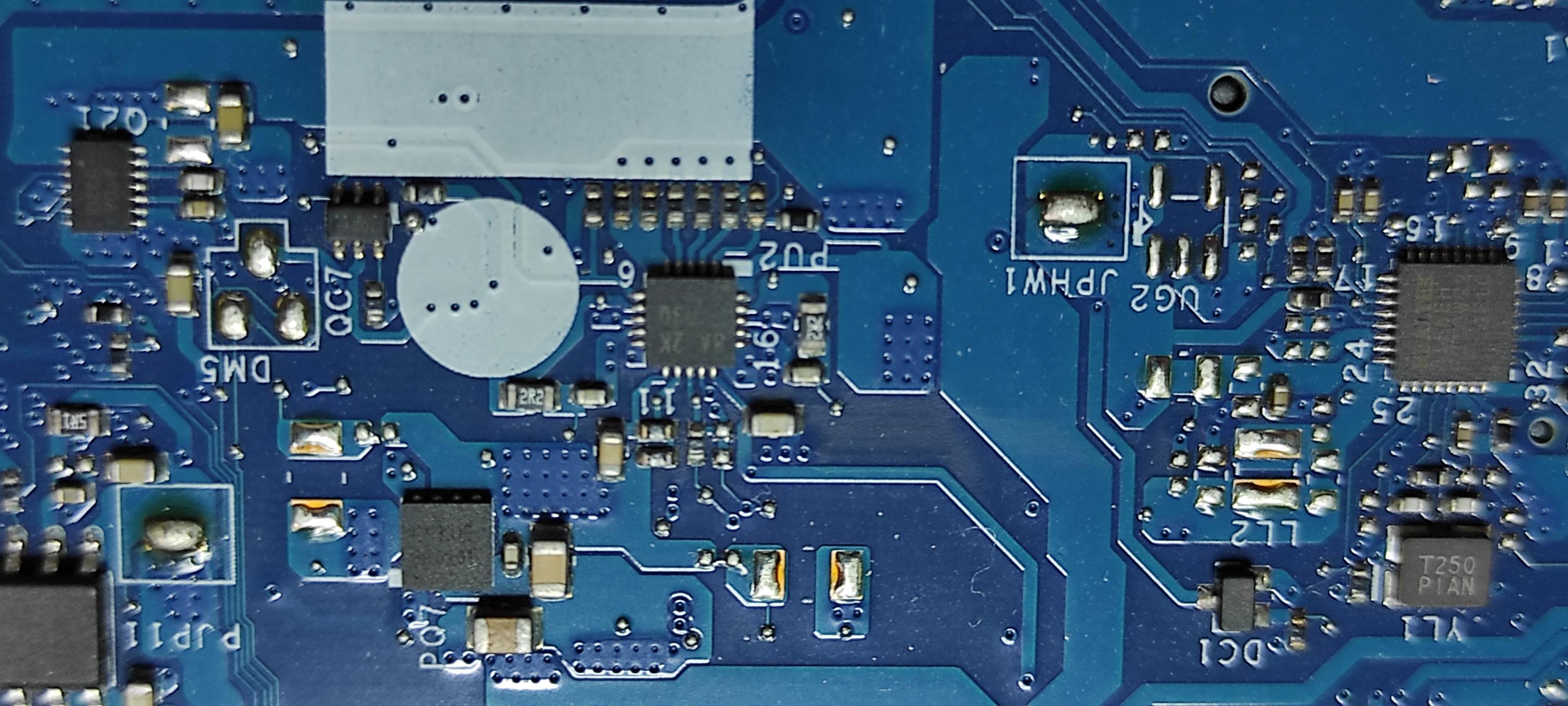

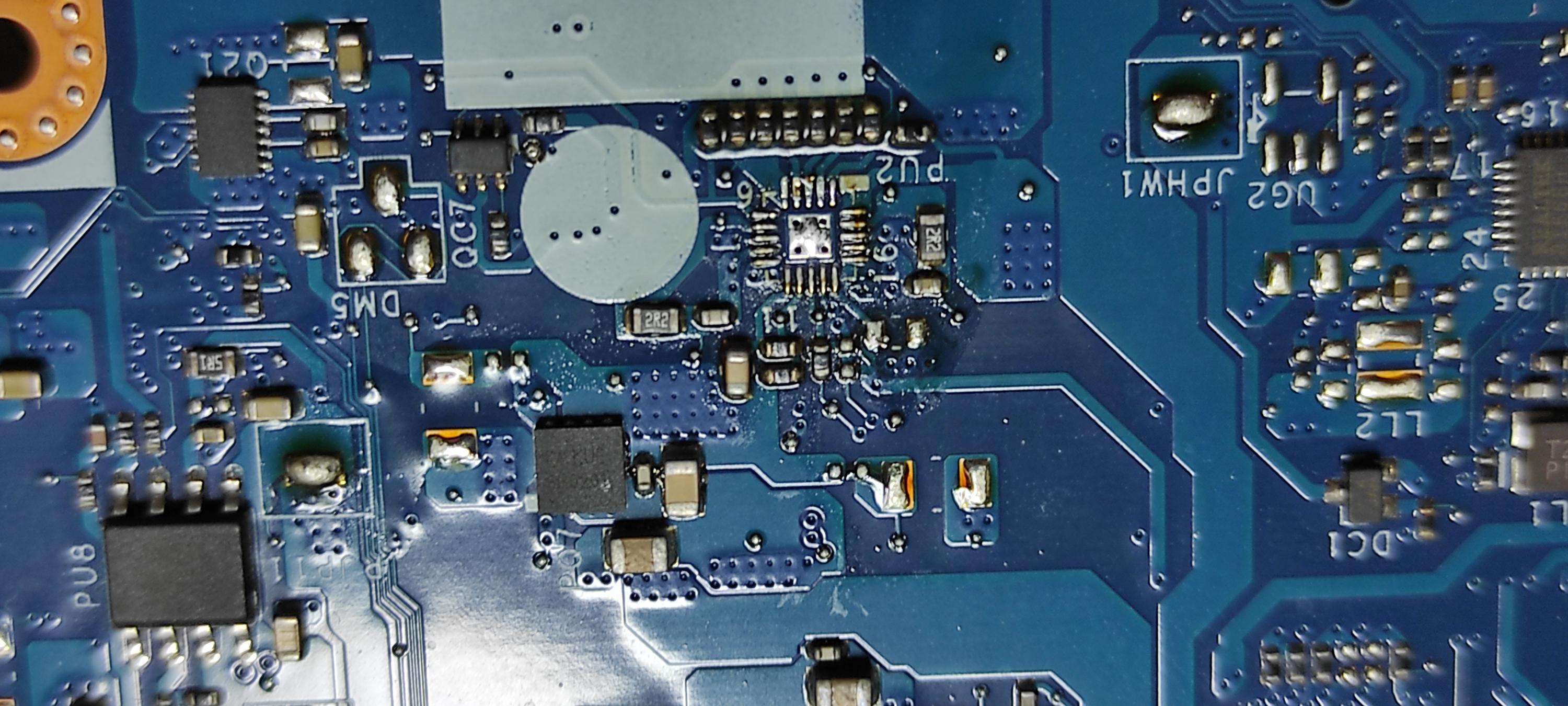

          There is no boardview available so i removed the capacitor that is connected next to pin 16.
          Short remains on both sides.
          Uploading picture before and after.
            Then remove diode PD202 - make a note of the polarity on the diode for replacement.
            Check again.
                Post a clear pic of the area - should be black in color and with a band (white stripe) on it.

                  Found it and desolder it, 7Ω remain on pin 16

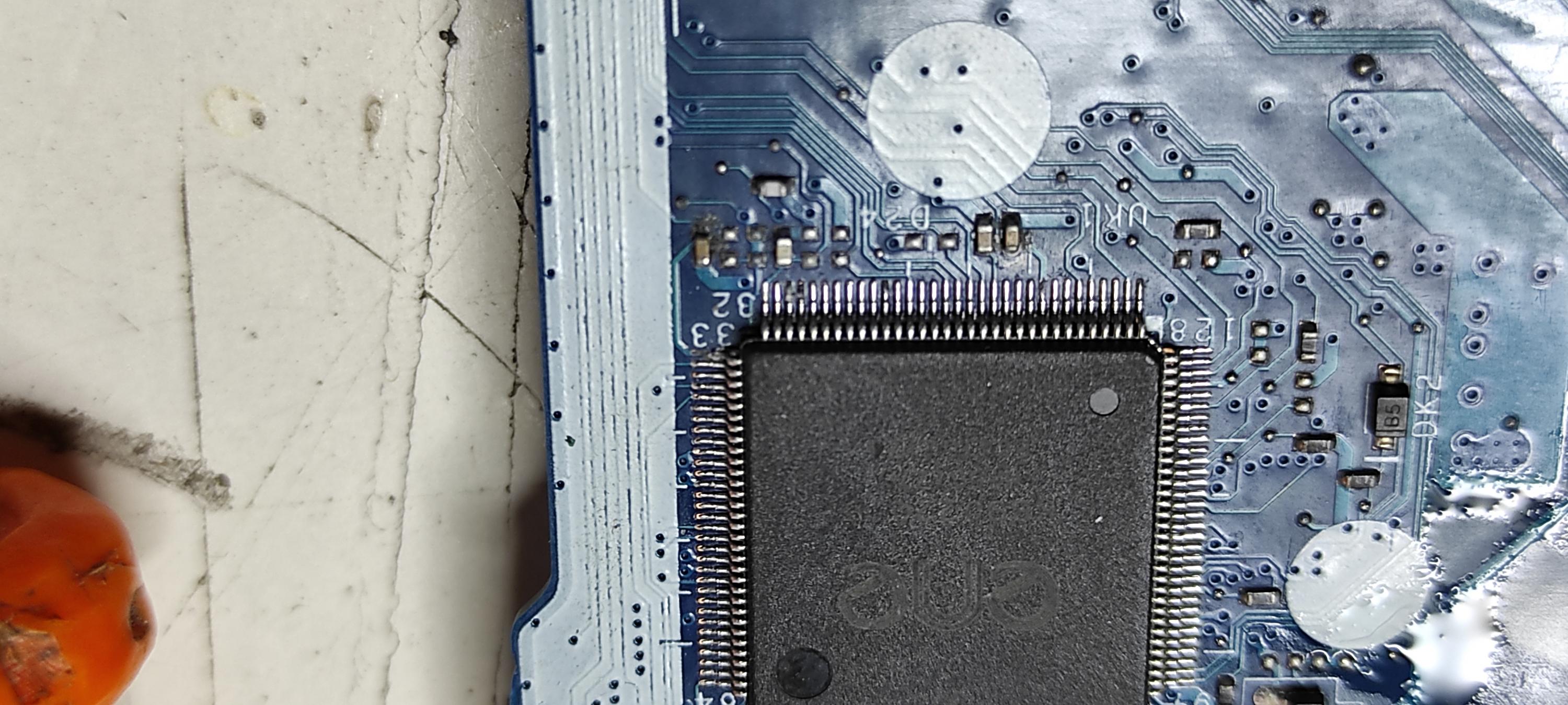

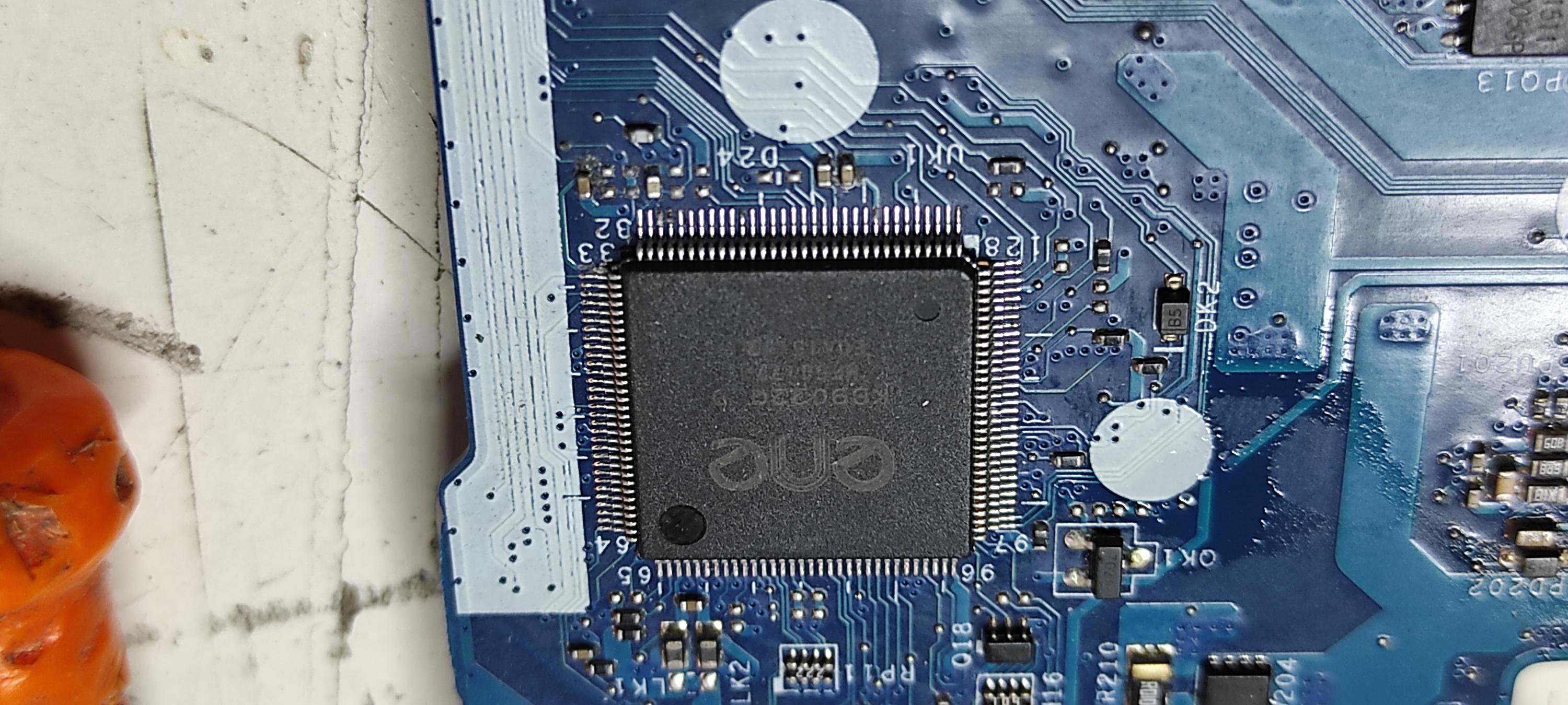

                    Uploadding pictures of the liquid damaged area, perhaps theey can give us a clue before voltage injecting : )
                          Wait! My bad - have too many open Windows.
                          Let us back track. Keep note of each part that is being removed so you can replace it back. The ECE is not the area of interest.
                          Pin #16 of PU2 is linked to a mosfet device @ PQ8. It should be 8 pins.
                          Remove this dual mosfet @ PQ8 and test the resistance again on pin # 16.
                          Update:
                          In my earlier review - searched for 'PU2' and stopped @ 'PU201' and referenced the pin #16 = REGN pin on it. My apologies.
                              Yes - remove PQ8 (8 pin device). Take a picture of the topside for the replacement / pin # 1 orientation.
                                      That does not sound right - is the posted schematic 100% for your laptop ?
                                      • Andreasbest
                                        • Aug 2014
                                        • 1196
                                        • Hellas ( Greece )
                                        Just found the mistake
                                        I count the pins clockwise while they are counter clockwise like usual.
                                        I'm terribly sorry for this.
                                        The correct pin is 15, not 16 : (
