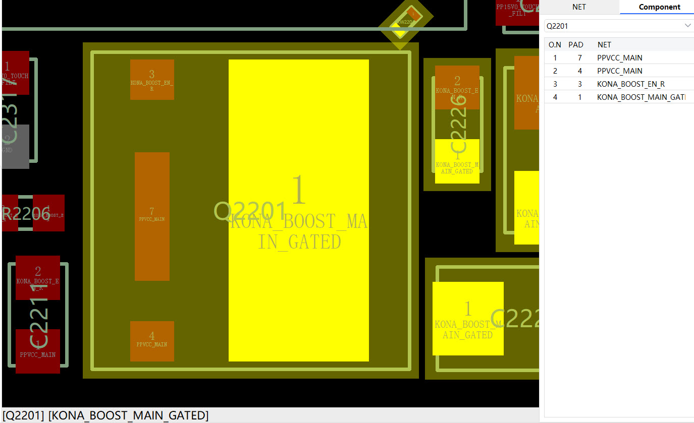

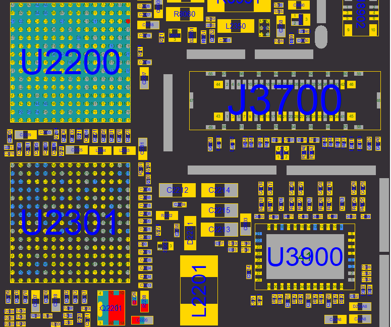

    Hello. I am troubleshooting an iPad Pro 12.9" 3rd Generation for no touch. There is a component that has a visible burn mark on it that needs to be replaced, but I cant seem to find what it is.
    The component is called Q2201 in ZXW Tools. Can anyone identify this component?

    Re: Need Help Identifying Component - iPad Pro 12.9" 3rd Gen
    What is the 820-xxxx of your logic board ?
      Originally posted by mon2
      what is the 820-xxxx of your logic board ?
      820-01435-a
        So far, see only the attached bv.
          Thanks for the reply. Yeah, that's basically all ZXW Tools tells me as well.
          I would try and read the markings on the component itself, but because of the burn mark, I can't make out what they say.
          If someone has a logic board for this model and would be kind enough, could you take a look at the component and see what the markings are?

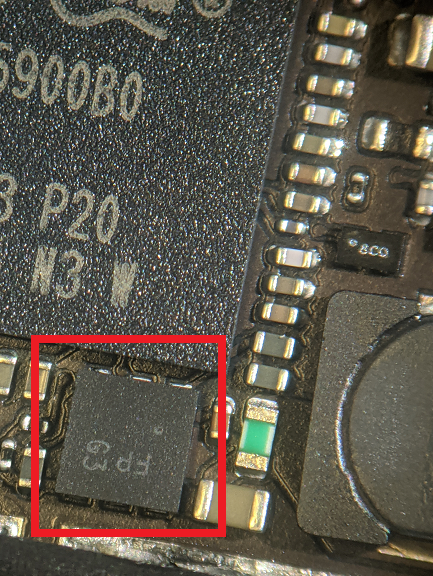

            Update: Luck would have it that another customer brought in the same iPad model for a screen replacement, so I took the shield off and took a look at their component.
            It is marked, "FP G3" or "G3 FP", I guess. Attached is pic. Hopefully this helps someone?
