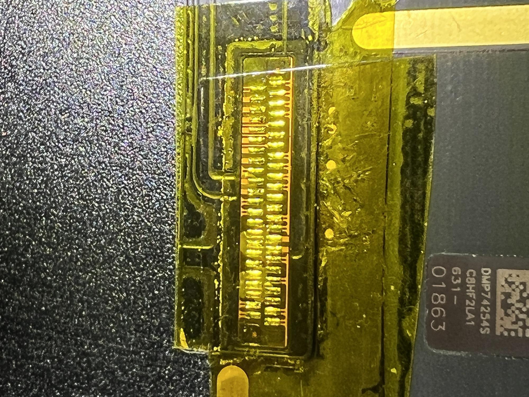

    Hello all,

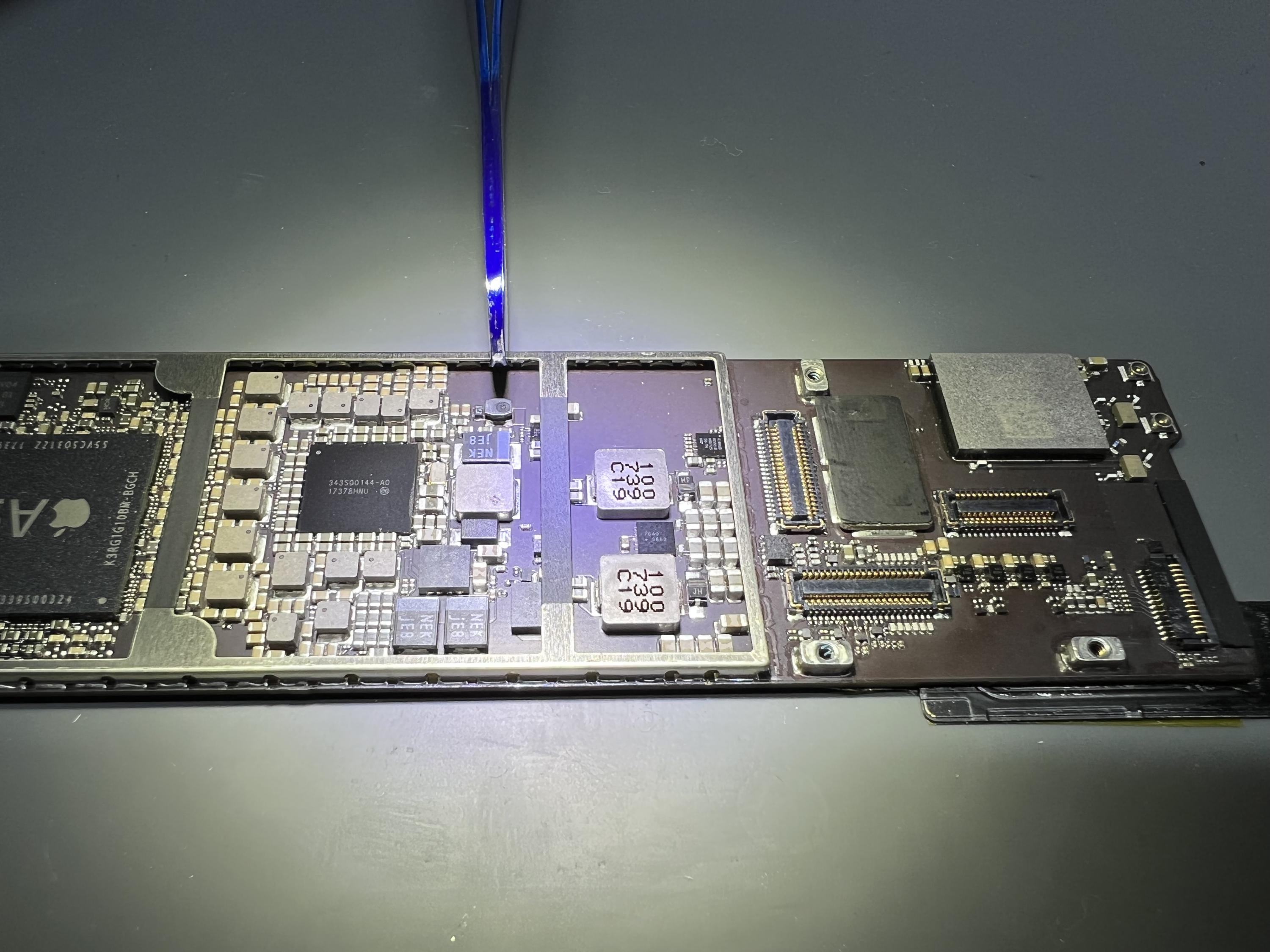

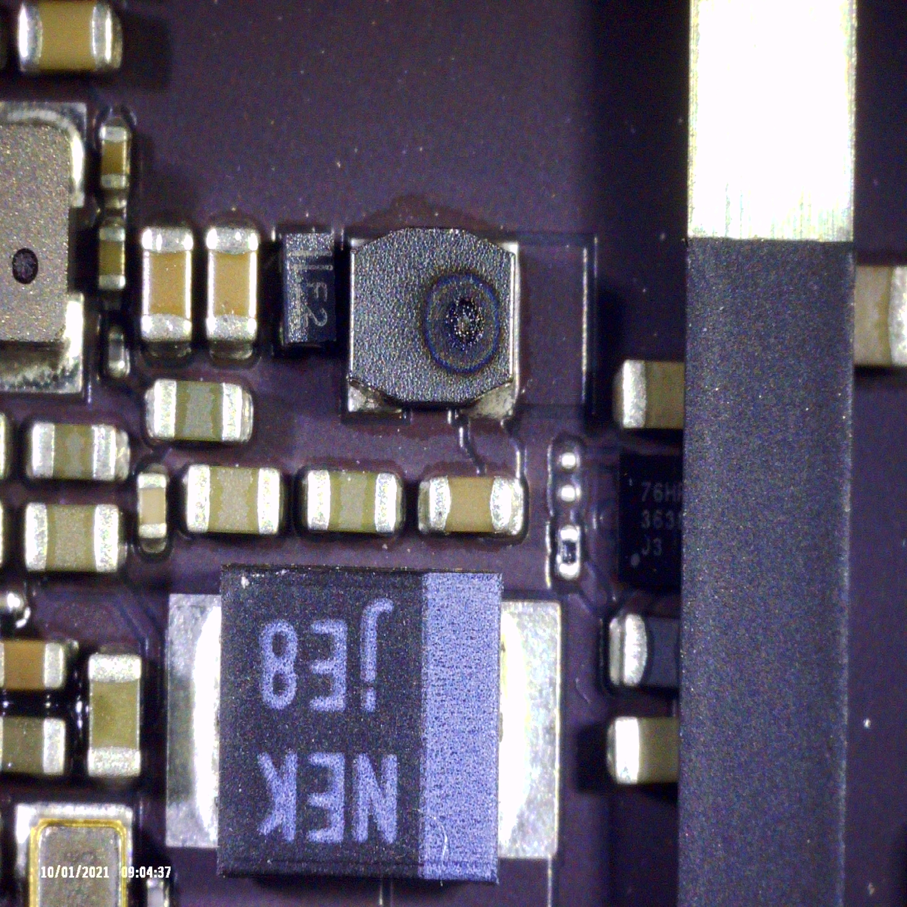

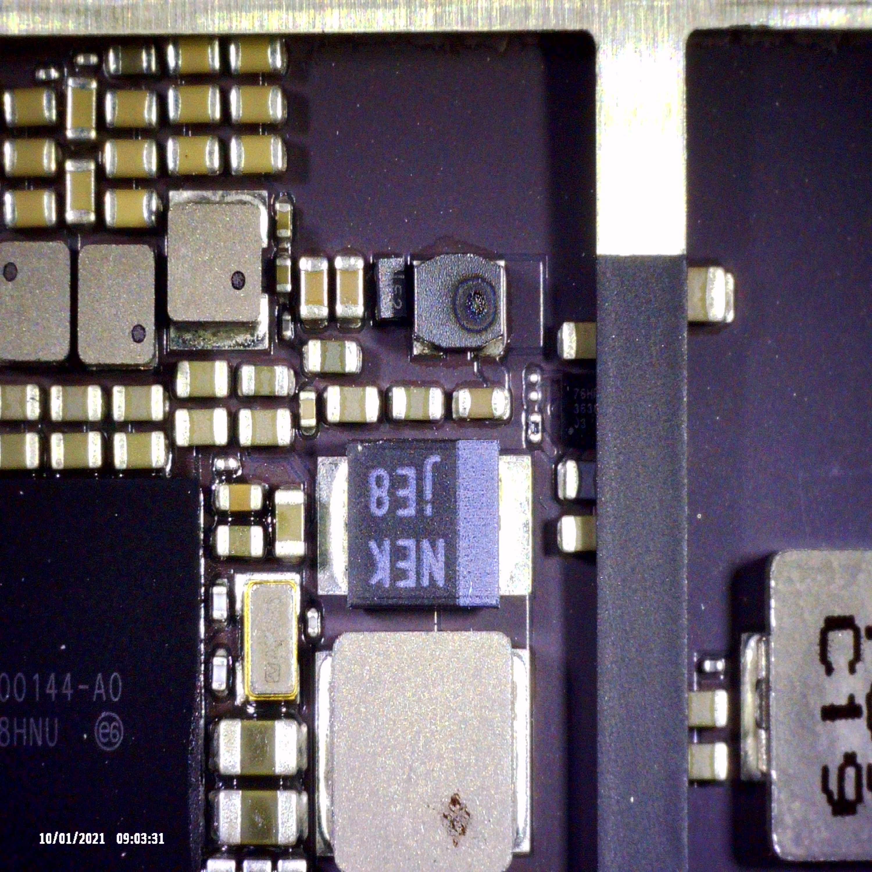

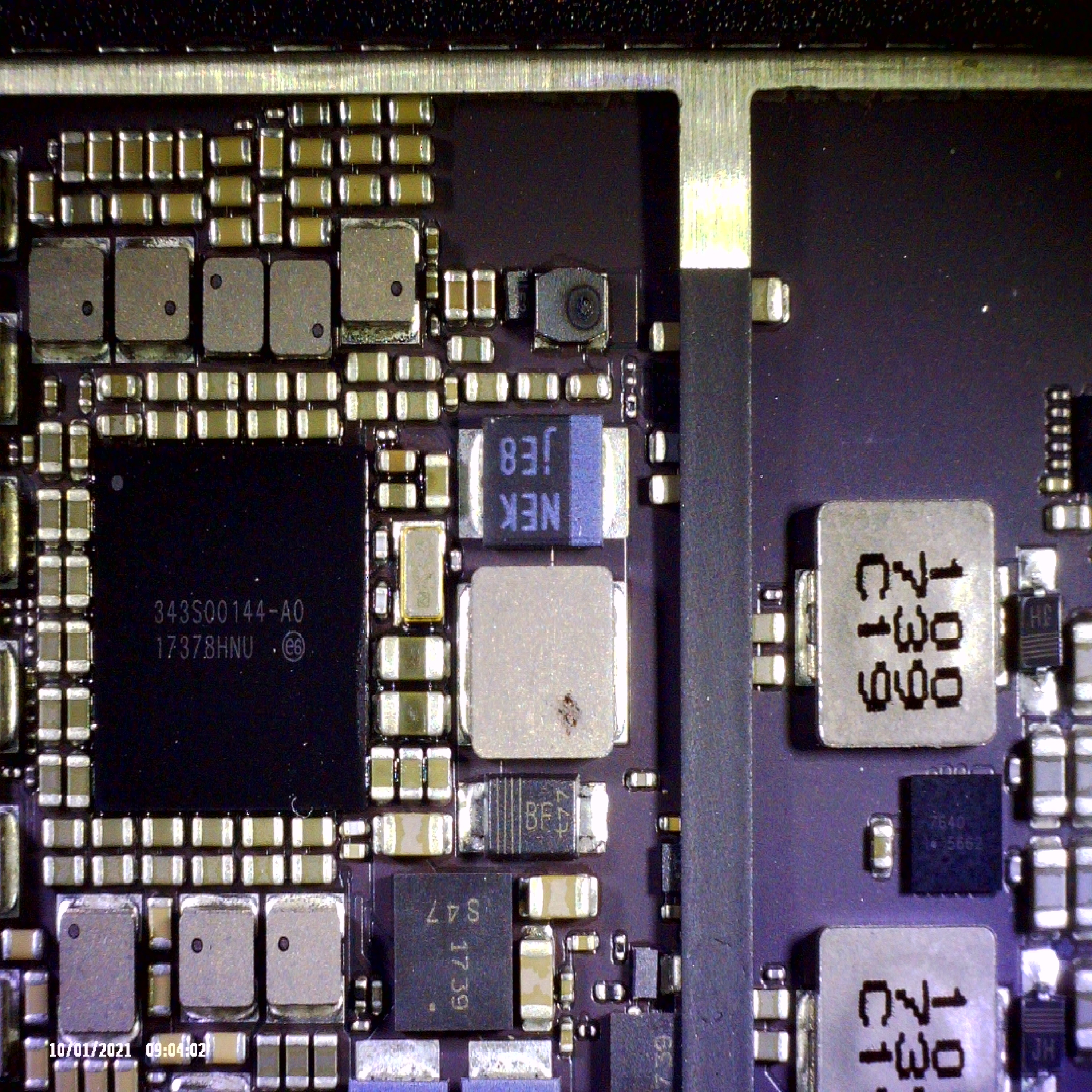

    I have an ipad 5 that came in for home button repair. Issue fixed and return to the customer who then stated it also has battery/charge issues. The battery seemed fine however the ipad would acknowledge the charger every other time. The port looked fine but considering that it would work than not, I decided to change the port. Port changed and yet it draws zero amps. Removed the shield and found this burned component. Tried to find a board view but seems like the ipad 5 is the only ipad for which board views don't exist.
    Yes I should have definitely done a visual inspection before anything but I am learning, the customer is my sister and this is an old ipad that they barely used so it's a good candidate to learn on.
    If anyone has the board view or better yet help me identify this component that would be great. This burned component is causing a short on all the caps. Also if there is any advice or suggestions on what to check I am open to it all so please help me learn. Thank you all very much!!!

    Looks like a coil to me which got too hot (because of the short you mention). That's the PMIC so many rails coming off that. If you have a short on that line, it's either the PMIC itself, or one of the caps on that rail. Thermal camera would save you buckets of time on this one.
      Re: Ipad 5 (2017 A1822) Need help identifying component
      I agree it looks like a coil, if it did not go open it could be ok. It may have had a the value printed on top at one time.

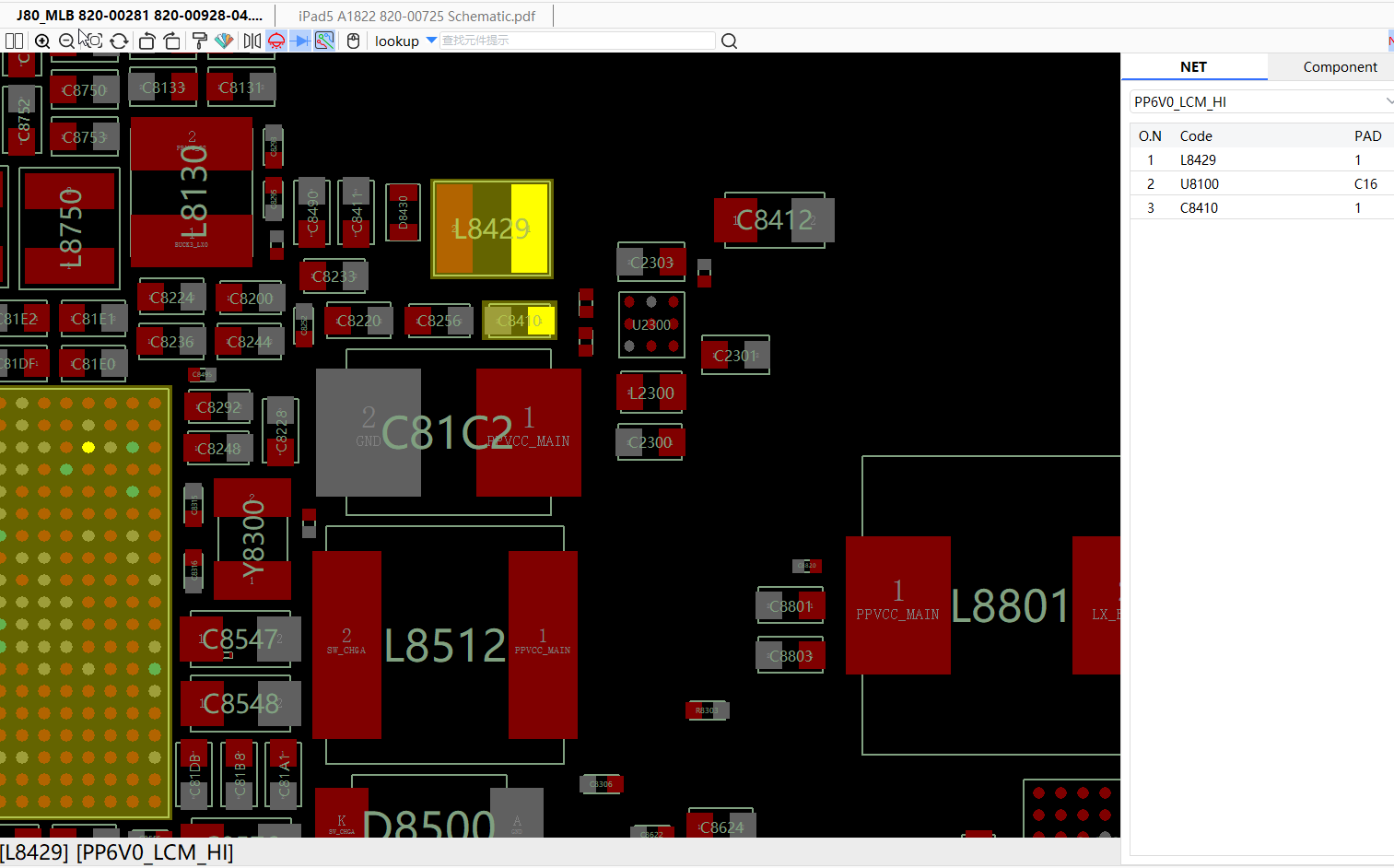

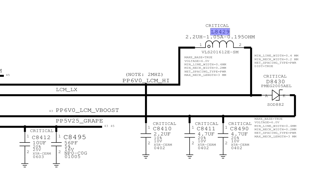

        L8429 = 2.2uh-1.05a-0.195ohm
        vls201612e

          Thank you guys so much for all of this useful info. Thermal cam is too expensive at least for now but I do have rosin I can use.
          Question, I changed the charging port without any issues or torn pads but this being my first one could that possible cause any of this? Should I leave it or remove it and check?

            mon2, would you be able to send me the schematic you have for this iPad. Since my last post I have continued to search and still cant find anything specifically for the 5. I also figured out that its not the coil lol.
            Update to follow shortly as I just won a donor board on ebay.
              The short is gone without me doing anything. While I was looking for a schematic/board view, the short fixed itself. I connected everything back up and it's working just fine.
              This is great but not a fix. I don't want to seal it back up to find it not working in a day or two. I waited a day and still not short. This iPad had the screen replaced a few times and home button but I don't believe nor see any evidence of anyone touching the board.
              Any suggestions on what to do?
