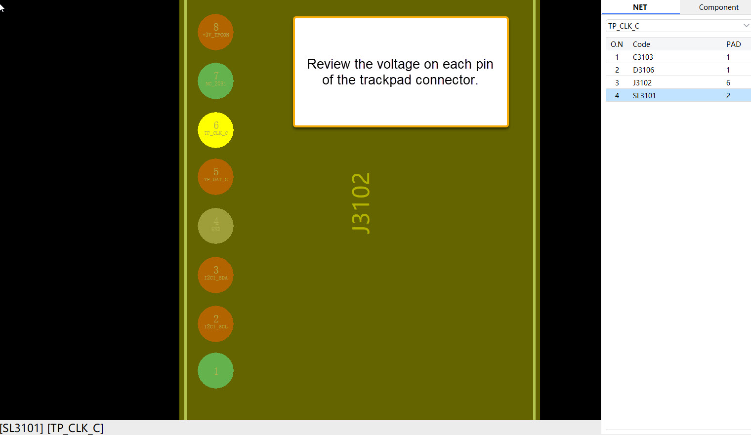

        Re: asus x550vxk touchpad not recognized
        Review the voltage on each trackpad connector pin.

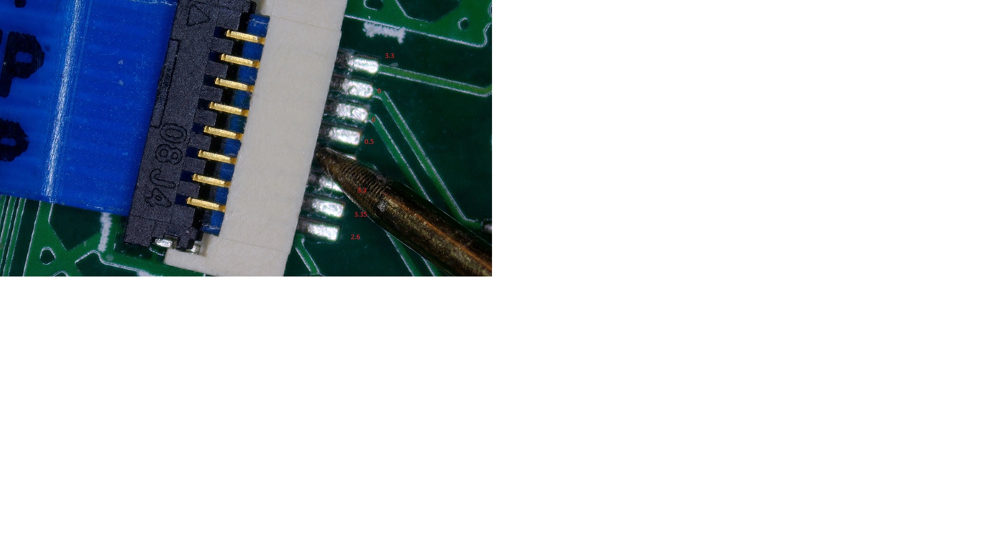

          The results
          • Stevedb
            Stevedb
            • Feb 2018
            • 624
            • Belgium
            Flex of connector on picture is not inserted full it must be much deeper. Reseat the flex
