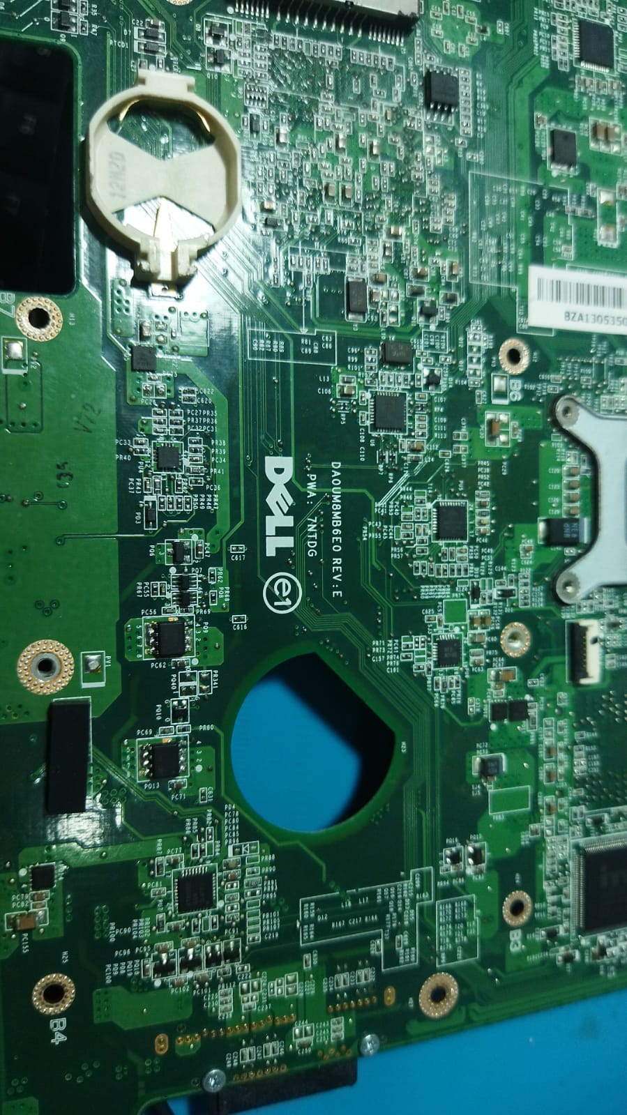

            • IamPritesh
              • Aug 2017
              • 356
              • India
              Re: Dell N4010 Does not power on.
              BOARD Image attached. I think i have now attached the correct pdf

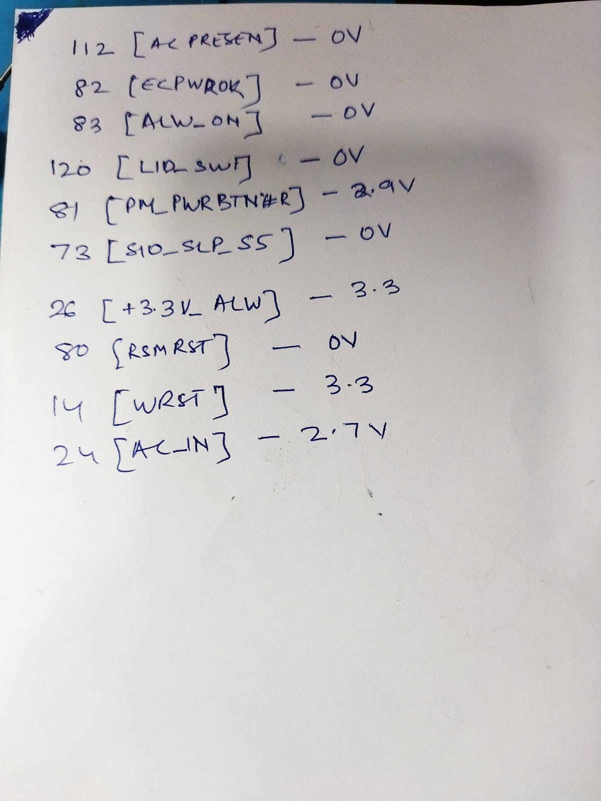

                            • IamPritesh
                              • Aug 2017
                              • 356
                              • India
                              Io reading
                              • mcplslg123
                                • Jun 2015
                                • 7262
                                • india
                                Focus on LID_SW#??. It should be 3.3V. Remove the LID switch and check again.

                                  • IamPritesh
                                    • Aug 2017
                                    • 356
                                    • India
                                    According to the schematic +3.3V_SUS generates the LID_SW#. I don't have +3.3V_SUS
