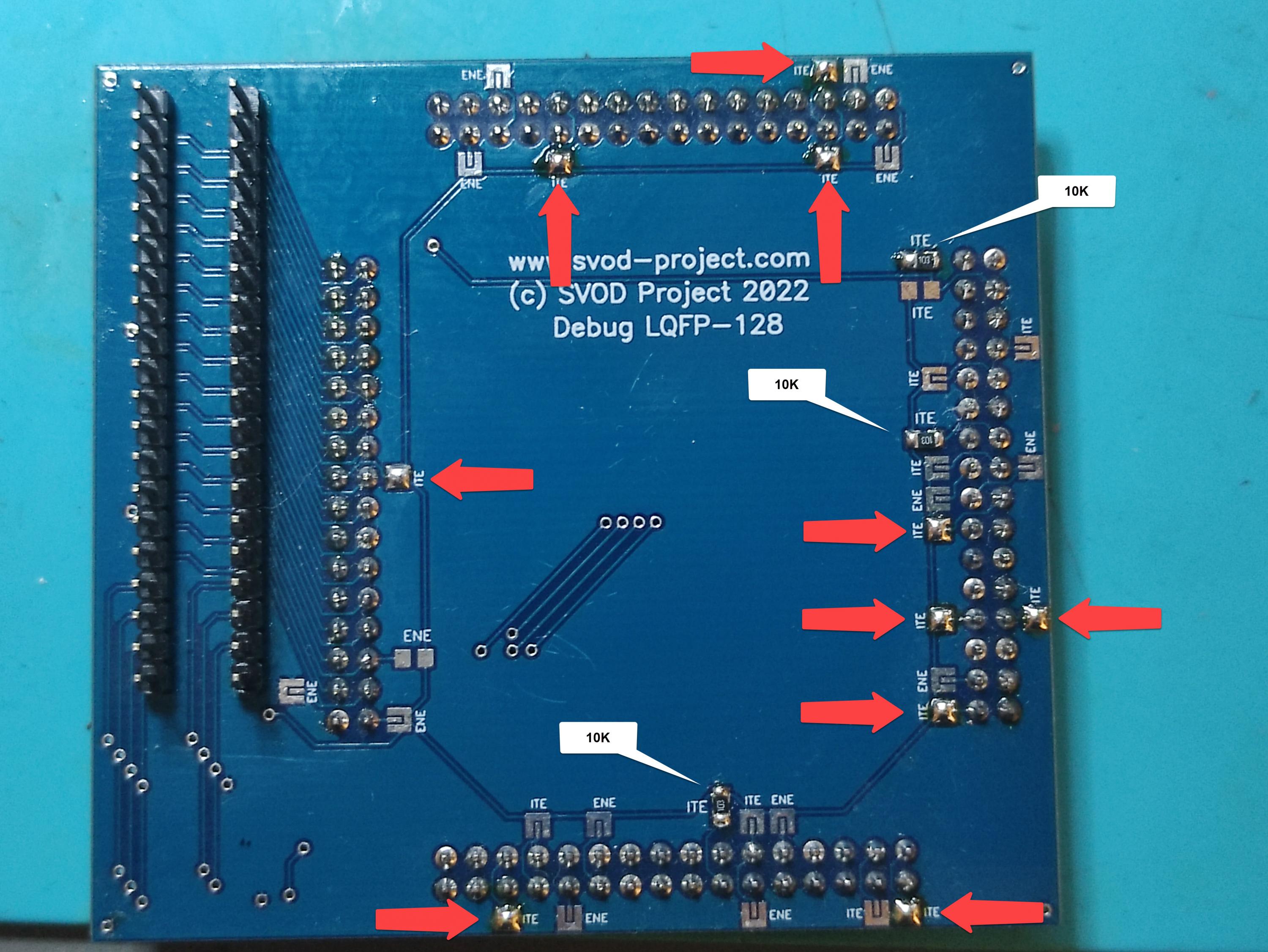

    Recently got this off the SVOD team, but it came needing assembly plus some 10K resistors. I used the PDF on their website to configure the jumpers/resistors, but can't get it to recognise any ITE, ENE or Nuvoton EC in my SVOD.
    Anyone got any experience with this programmer socket and how to configure it?

    Finally got some spare time to buzz this out and got it working. They even say on their website, if you don't know how to use it, then don't buy it. Giving you a bag of parts with zero instructions was obviously some kind of rite of passage to see if you are intelligent enough to own it. To save anyone else time, I'll fill in the blanks here.
    There are two identical PCB's, to be configured either for ITE, or ENE/Nuvoton EC's. There are some solder jumpers, these are for +3V or for GND, and a few pullups for the RESET lines etc. Images attached on how these are configured for future reference. The ZIF socket plugs into one or the other depending on what EC you are using. I had an open circuit on pin 37 for some reason, which came good after resoldering the header pin. So you might need to buzz each pin out after assembly if you are having issues during the check pin bit.
    The preset configuration file for the ZIF header in the SVOD program is correct for ENE, but wrong for ITE. It's possible this is for an old version of the ZIF debug kit, and may only be wrong for the 2022 version. Images attached for the correct pinout. Works fine now for ITE, ENE and Nuvoton EC's.
    +3.3V is supplied on the SVOD header on pin 34 and GND is pin 39.

      Someone has asked for some images of the front and back of the adaptor set so here they are.

          hi can u can upload better quality of ITE board because is shifted ans not sharpen
          and 2nd question
          on ite you are have not every ITE point bridged are this is ok and working
          i will be very thankfoully

            The bridges for these boards are either grounds or Vcc lines. Not all lines are needed; I metered each line to confirm which pins they corresponded to on the ITE socket. The 10K resistors are pull ups. The camera on my el cheapo Xiaomi isn't the best but the attached photo has everything you need.
            As I said in my 2nd post, this was tested and working. You may need to meter things out to check your soldering if it doesn't work for you.

              1-the place for components on top of board of any plug to the svod programmer, are for leds or any working info? Did you discover it?

                There are some pads on the clamshell PCB for power/busy LED's (and dropping resistors) but aren't necessary to be populated for simply programming etc. I haven't buzzed these out for polarity as they aren't needed.
                What YT videos are you referring to? These boards are programming ITE/ENE/Nuvoton embedded controllers, so I don't understand the external memory reference.

                  i have this also if you want to read ITE chip you need must soldering any blank chip i use 25Q32FV blank chip.If not use this maybe give error ITE is busy better put any blank chip.
                  for Ene no need any blank chip.

                    Did some digging in the forum about that. According to the SVOD team, you need that EEPROM fitted if the chip you are trying to program isn't blank. To quote:
                    "if your ITE8585 not new and with firmware inside, need solder spi25 flash empty with size more 128k"
                    http://forum.svod-project.com/viewtopic.php?f=2&t=991
                    Don't know if this pertains to all ITE chips, or just this specific one. So any SPI25 capable EEPROM will work, even a 1MB one.
