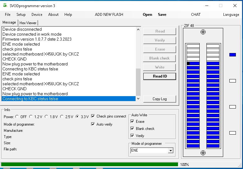

    Hai Guys, I need help here
    I wanna to reprogram EC Ene KB9026Q C,
    if you guy see my picture no 1, that (pin 9 : KSI4) is not connected,
    already test the pin from Keyboard connector to SVOD3, its not problem.
    but somehow, its said pin false.
    Try to ignore it, but still cannot read id (picture 2)
    Its that mean my EC ene is bad?

        Meter it all the way to the EC pins, not just to the keyboard connector. Does your SVOD3 work with other ENE EC's ok? I've had issues on my SVOD3 previously with one of the PA1 (DMG1013UW) FET's got damaged.

            i dont know if this what the cause of it, but when checked again, i found that 1V is not present (like 3.3V and 5V). I found one resistor is turn bad, so I fix it, already check again, laptop can turn on normally without programming the EC, so maybe this is one that cause it cannot be program.
