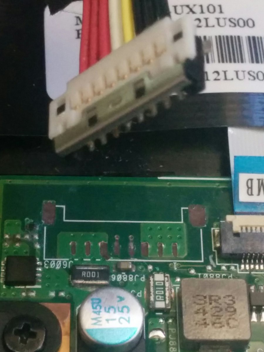

The kind of ASUS battery connector.
  • Danila.
    • Apr 2021
    • 8
    • BELARUS => POLAND
    What kind of this battery connector. Where on Aliexpress can I buy it?
    thx.
  • mon2
    • Dec 2019
    • 14120
    Re: The kind of ASUS battery connector.
    The connector is torn off the pcb and is on the battery cable in your picture.
    Detach the connector and post more pictures.
    You will need to measure the distance between each pin of this connector.
    Is it 2.54mm or 2.0mm ?
    Connector looks like the 'JST PH right angle smd' style.
    • Danila.
      • Apr 2021
      • 8
      • BELARUS => POLAND
      I know. The foto from internet.
      I just did't find this connector on ali, ebay, etc..
      • elecsoluces
        • May 2020
        • 66
        • France
        The connector itself doesn't seem damaged, it is attached to the battery
        • Danila.
          • Apr 2021
          • 8
          • BELARUS => POLAND
          ok. super. thx
