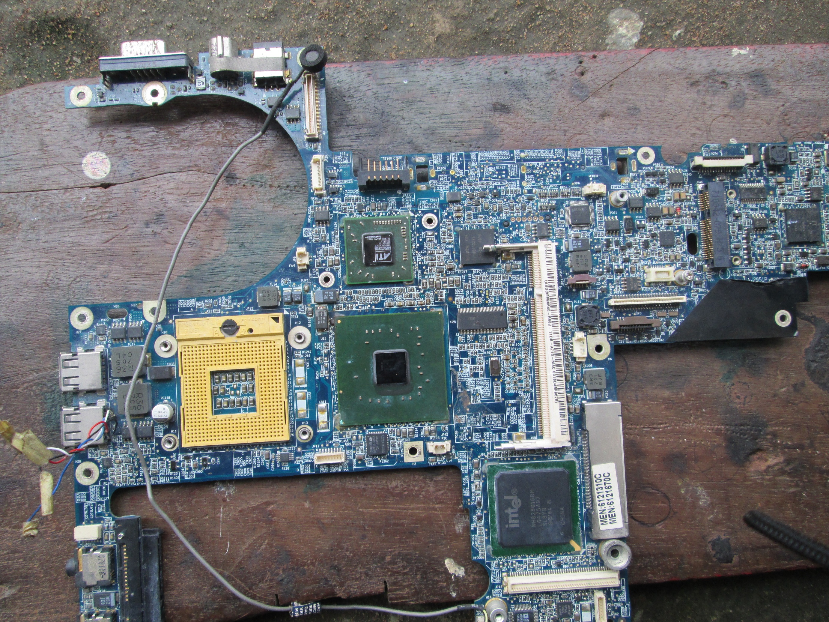

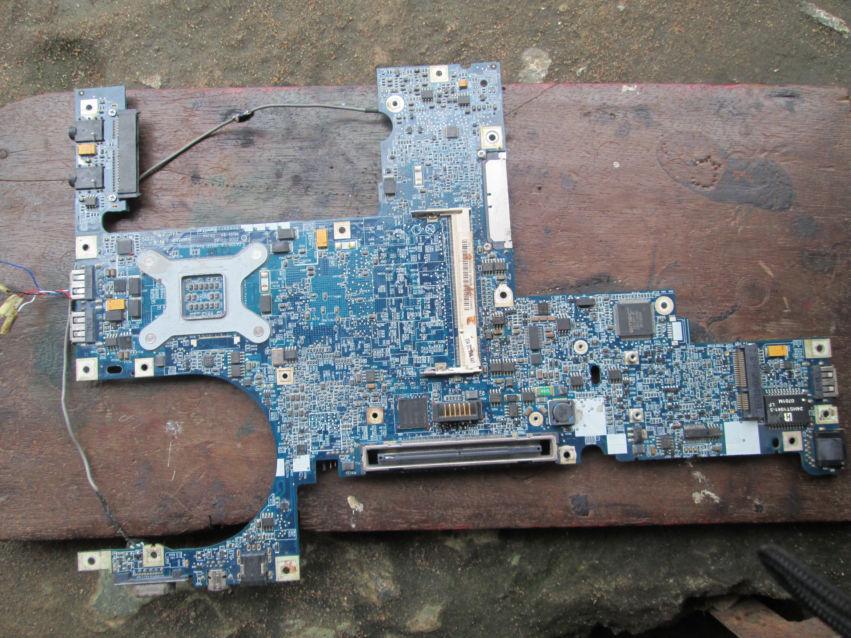

    I have this laptop that suddenly developed some power faults. The adapter gives the normal rated voltage, but if it is connected to the board, there is no 3.3v or any other voltage. some few resistors and capacitors near the PCN1 have their values below their rating on the board but off-board, they read normal. Also, PL1, PQ3, PQ4 are getting very hot. How can I test and isolate the fault? See the schematic I am working with. My board screenshots also attached.

    You are on the right part of the review - PQ3 and PQ4 are the usual suspects - see the detailed thread above from @Piernov.
    Remove all power / no battery.
    Meter in resistance mode.
    Check the resistance across each mosfet:
    source (1-2-3) & drain (5-6-7-8)
    source (1-2-3) & gate (4)
    gate (4) & drain (5-6-7-8)
    Post the reading in ohms and also the scale used for the measurement on your meter.
    Repeat for PQ4. Very likely that at least one or both of these mosfets is defective. If available, you can skip ahead and replace them both for testing.
    Also, on the charger IC (PU2), post the voltages for:
    ACDET (pin # 26)
    ACDRV# (pin # 25)

        Re: Hp compaq nc6400 hatoo la-2951p power issue
        Remove PQ4 - power up again.
        Are PL1, PQ3 now cool ?

            Ok. Meter in resistance mode (start with the lowest scale).
            Check the resistance to ground of pins 1-2-3 of the REMOVED Q4 mosfet.
            We are checking if there is a shorted part on the main rail.
            Also check the resistance to ground of pins 5-6-7-8 of mosfet @ PQ7.
            Post the measurements and scale used on your meter.
