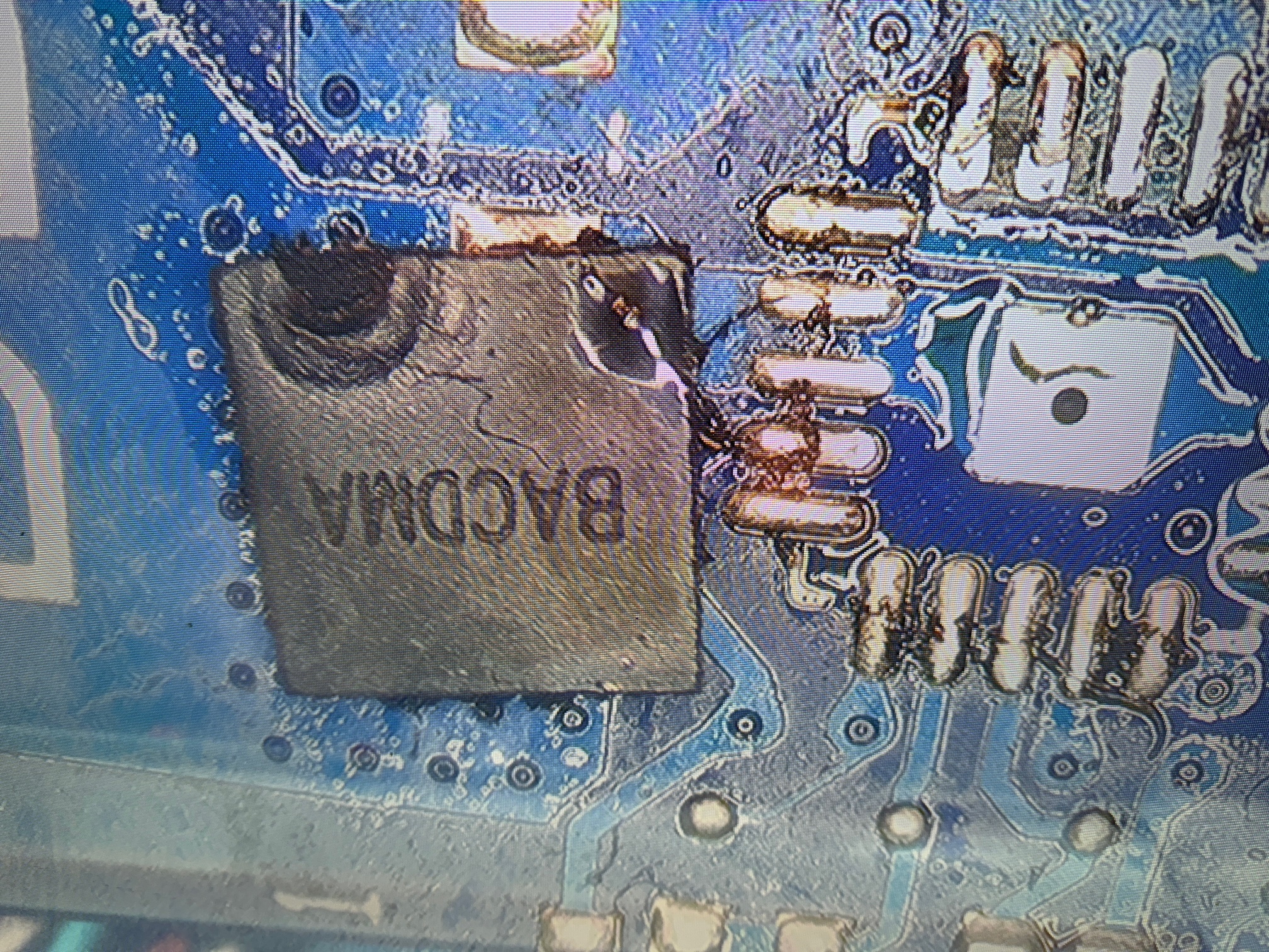

                What is it: BACDMAClick image for larger version  Name:	image0 (3).jpg Views:	3 Size:	1.85 MB ID:	3756072

                  Originally posted by wefixtvs
                  What is it: BACDMA
                  SY8288CRAC
