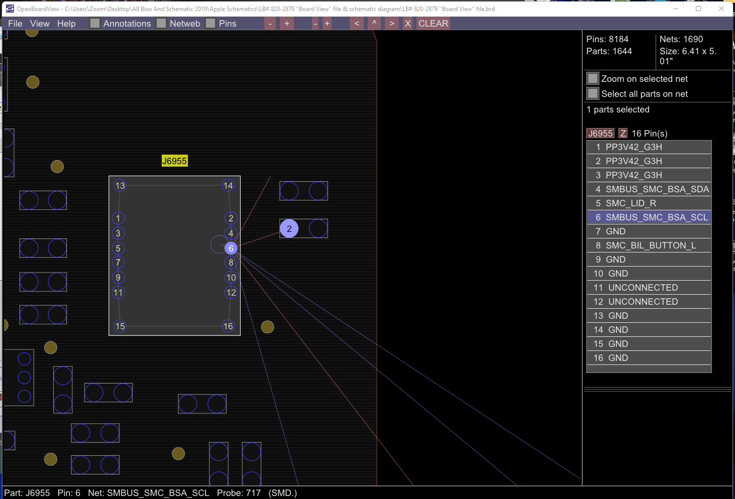

              • piernov
                • Jan 2016
                • 4435
                • France
                Re: Macbook Pro 2010 Not Charging
                https://www.badcaps.net/forum/showpo...50&postcount=2
                2.2.2. Battery not detected
                Issue on charging circuit SMBUS.
                Check voltage and diode mode to ground on charging circuit SMBUS SDA and SCL lines

                        • platinumsteel
                          • May 2019
                          • 234
                          • Trinidad&Tobago
                          Originally posted by mon2
                          Sorry - what is that ?
                          That is J6955 connector. There is a little led indicator to the side of the older macbook pros that shows how much charge the battery has. It has a connector for the LEDs . connector is right next to R5280 and R5281. The connector is connected to those SMBUS_SMC_BSA_SCL/SDA lines

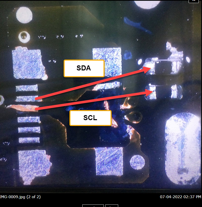

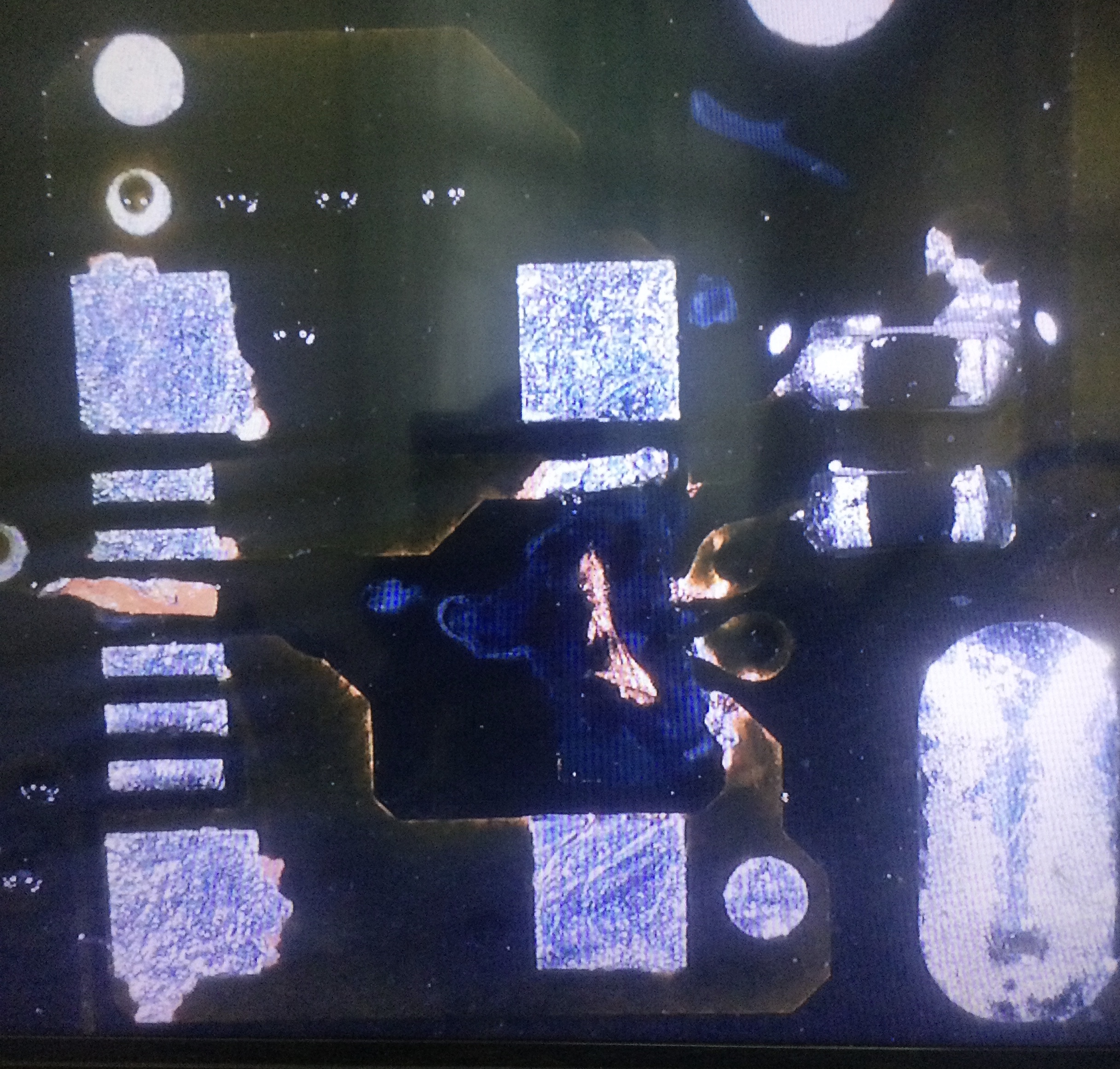

                            • platinumsteel
                              • May 2019
                              • 234
                              • Trinidad&Tobago
                              Would you believe that yesterday when i took off the smc i was going to do that same test but something came up and i completely forgot to do it. I doubt i will want to conduct that test and go over the whole reballing process.I am not lucky with using the paste. I want to order the balls and try that method instead for reballing. When i get that then will take off smc and conduct the test.But thanks a lot for mentioning that should of done that from the very start my bad.
                              • platinumsteel
                                • May 2019
                                • 234
                                • Trinidad&Tobago
                                Hi guys i ended up deciding to remove the bill connector.And low and behold there was a crater with corrosion i tried scraping off but it seems to be going deeper am not sure. Am not sure if this will definitely be my issue of that drop in diode mode measurement i have especially on the SDA line.
                                SDA 0.527V
                                SCL 0.550V
                                But do u guys think it will make sense if i try to get away from those viers? Like maybe remove the 2x resistors of their pad and run jumpers from the resistor directly to the capacitors to the back of the board . Like move the resistors of those 2 viers and run jumper wires directly to the back of the board so maybe i can bypass what ever short there is if atold there is a slight short?
                                • mon2
                                  • Dec 2019
                                  • 13866
                                  Hi. Ok, after a stare of the PCB, can see the pattern (I think).
                                  See attached. Does this look correct on the wiring ?
                                  TOP ARROW = SDA pin.
                                  BOTTOM ARROW = SCL pin.
                                  My suggestion:
                                  1) locate some single strand wire that is flexible.
                                  2) place one end of the strand where the connector pad is showing (SDA) -> apply a bit of flux and solder it in place. Cut off a few inches for the other side.
                                  3) repeat with another fresh strand for the SCL pad.
                                  4) Now apply the other side of the SDA wire to the SDA resistor to bypass the broken PCB trace.
                                  5) Repeat to fix the SCL pad with the SCL resistor in the same way.
                                  6) Now, apply the BIL connector ontop of this stack up and solder each connector pad back into place.
                                  So you are creating a sandwich to fix the 2 traces.
                                  These wires can be longer as it is a SLOW I2C (SMBUS) bus and often is 100khz (400khz max) so not a high speed interconnect.
                                  You can exit the wires from the REAR of the BIL connector (ie. to the LEFT side of your picture) and then around the connector to reach the local resistors.
