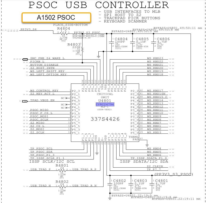

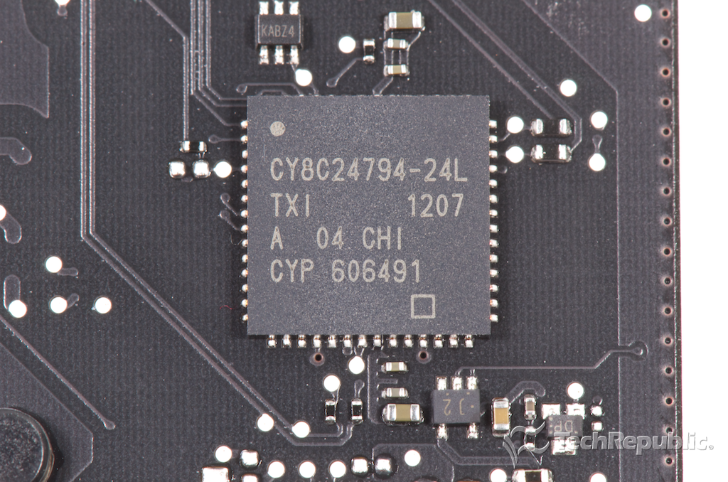

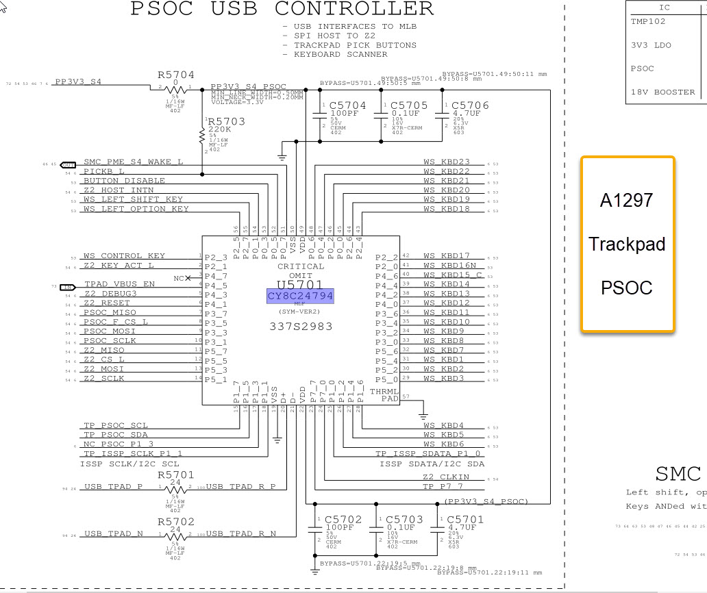

    Hello
    Here I have macbook a1502 with (13" macbook pro) working keyboard but not working trackpad... no water damage all is clean, track and pads are ok so i think problem is with CY8C24794 usb chip.. my question is , will a1297 DONOR BOARD WITH SAME CHIP be compatible if i use the CY8C24794 from the a1297 (17" i7 macbook pro)...

    Re: CY8C24794 usb trackpad chip firmware
    Very interesting observation.
    I think there is a very high chance that it will work - the pinout is the same between the PSOC devices. The PSOC is just a programmable 8051 or Cortex M0 / M0+, etc. micro with embedded fpga like fabric. The internal firmware defines the function and pinout.
    Give it a try and do update this thread. Fairly sure that it will work.
      thanks mon2 to such fast answer, i ask because different some pins,, ej p4_1 and p4_3 NC one but reset and debug in the other
        I don't think it will matter since you are not debugging the firmware. The developer will use the pin to debug their firmware code - to trace and monitor in the internal working registers, etc. of the microcontroller.
        The reset pin is likely still not an issue as the internal device will feature multiple resets including a power on reset. This reset is an additional and external reset.
        I would give it a try as the parts are so so so close to each other.
