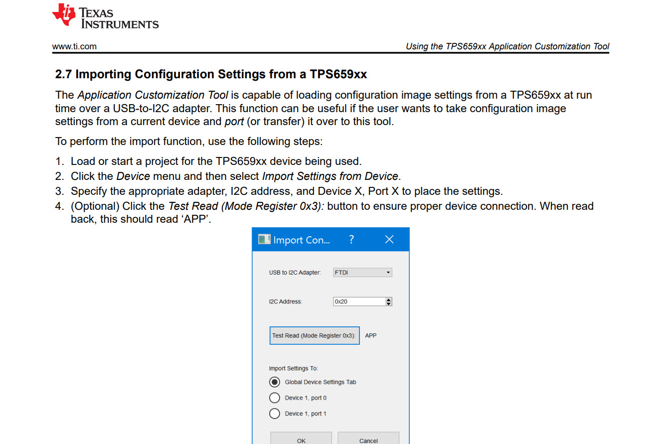

                  See attached. From the tool that TI is referencing, it should be possible to READ the configuration from inside the IC that is working.
                  Then you can save it and apply the same configuration onto a fresh device.
                  At least in theory.
                  From the screen shots, the tool is based on the FTDI controller. We have some knowledge on this controller.
                  To create a USB to I2C or SPI bridge, the FTDI controller MUST offer the MPSSE engine. The part number notes this feature with a 'H' suffix in the markings.
                  So for example, FT232H = single port controller WITH MPSSE engine.
                  Then using such a controller based PCBA - there are many on the market but again, must have the proper controller -> proceed to wire it onto the logic board and run their app to create the USB based I2C Bus Master.
                  The app will then proceed to R/W the firmware after you dump it from the original.
                  I can post the request for a confirmation of this understanding & device on the TI engineering forum. They are pretty good about support for companies.

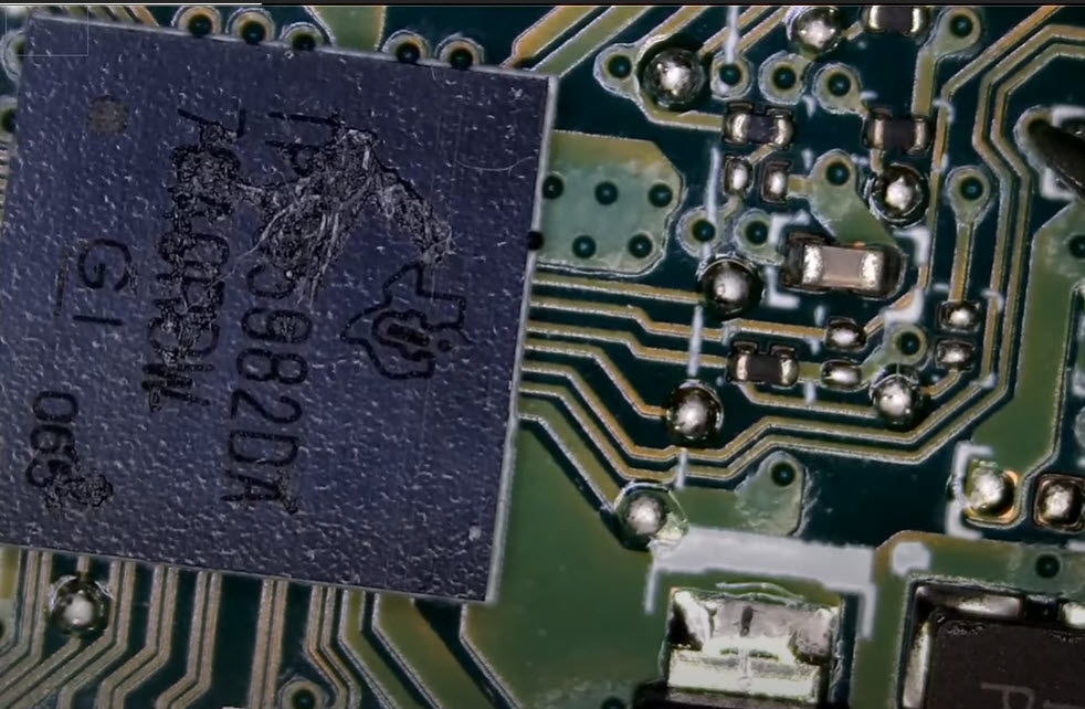

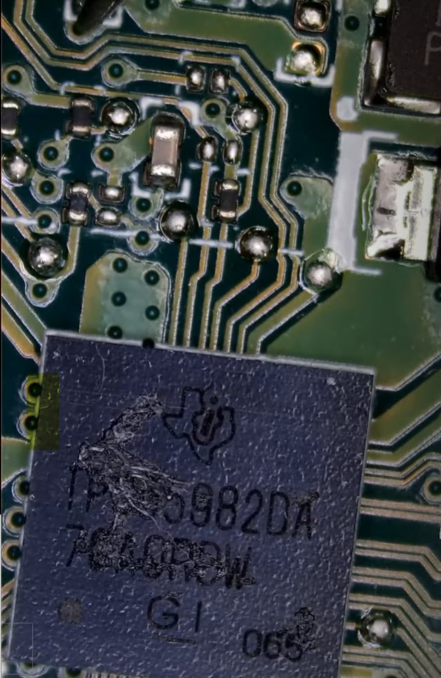

                    Can you post a clear pic of the ORGINAL IC that is the USB Type C power delivery controller ?
                    NorthRidgeFix is showing a different p/n in the video and he only replaced the IC - no firmware required.
                    See attached.

                      The first video link you shared it looks like thunderbolt ic to me
                      About spi device I don't have ft232 only ch341a that I believe can be used as spi bridge
                      Can it be accessed from windows through internal i2c bus ?
                      I have another idea, would a bios update force sio ic to also write firmware in TPS ?

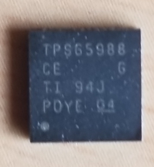

                      Original Tps65988ce photos attached
                      Yeah in Another northbridge's video the chip is tps65982 ic. I have replaced one on Asus, it was a breeze
