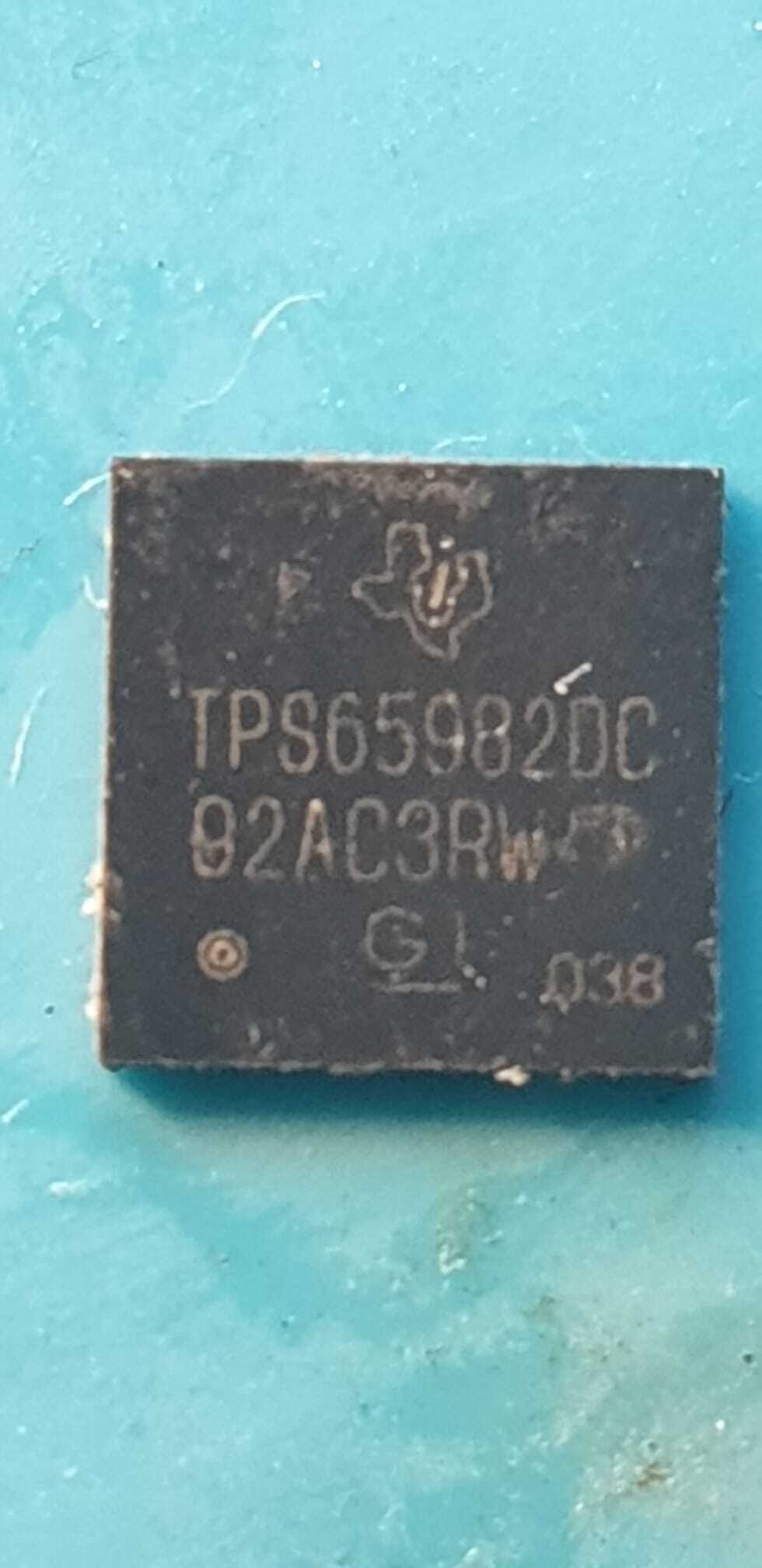

New Tps65988ce IC don't negotiate 20v spectre x360 2019 model

    Originally posted by mon2
    What is the exact part number that you have sourced as the replacement.
    Do review this thread:
    HP Specter DA0X36MBAE0 REV: E - Shorted TPS65988CE - Badcaps
    original one is TPS65982DC, new one is TPC65982DD

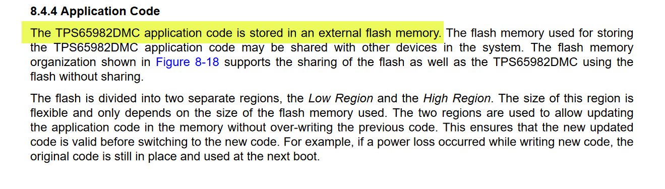

      Review this landing page:
      https://www.ti.com/product/TPS65982DMC
      Download and compare the # of balls; ball definitions for this documented component. Does it match your original device? This is a dock management controller which appears to load its firmware from an external flash device.
      Do you see a local SPI flash memory device nearby this TI controller?
