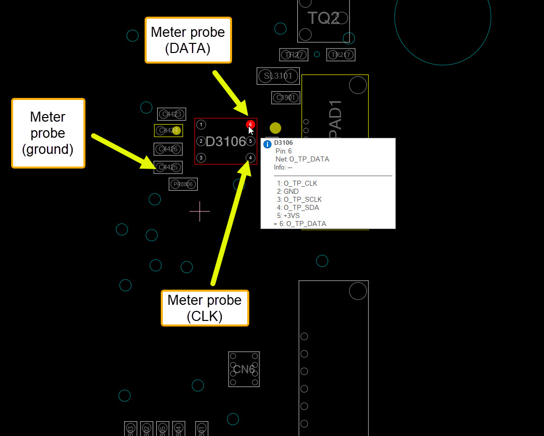

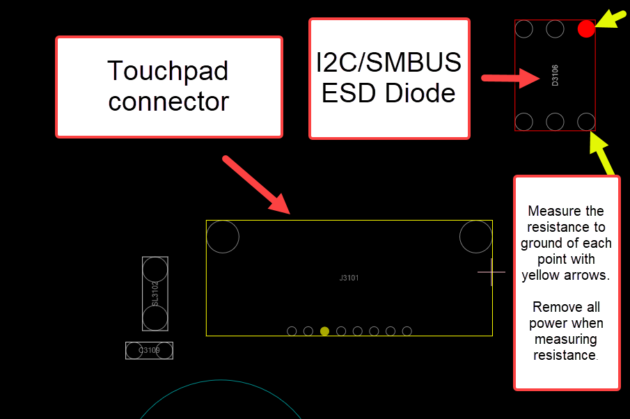

    See attached. Review the yellow arrows -> remove all power -> meter in resistance mode -> red meter lead on the yellow arrow head point; black meter lead to ground.
    What is the resistance for the SCL & SDA pins used by the trackpad ?
    Post the resistance measurements and scale on the meter used.
    Next, multimeter in DC volts mode (5 volts or higher is ok).
    Measure the voltage on the SCL & SDA pins to ground.
    Post the voltage measurements for each pin.

      both patterns display infinite values sir, in buzzer mode and the position of the red probe on gnd and the black probe on pin
      I need to say that these pins are not filled with IC

        and I've measured the volt parameter, the result on pin number 6 (DATA) when using the touchpad displays 0.70v, if not using the touchpad is 3.3v sir

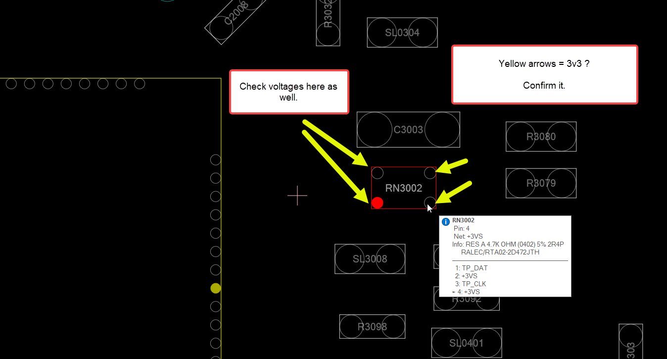

              These are not good voltage readings.
              See attached. Locate RN3002 and measure the voltage on the RIGHT side of this resistor network.
              Inside this resistor network are 2 * 4k7 resistors that are acting as pull-ups. The pull-up voltage must be 3v3 for each pin.
              Confirm the voltage readings.
              The LEFT side are the same SCL & SDA pins used for the trackpad. These are the TP_DAT & TP_CLK lines.
              Measure these as well and post all readings.

                Sorry sir I just replied because yesterday I had to work
                sorry but on this mobo there is no RN3002, are you not wrong to open boardview?

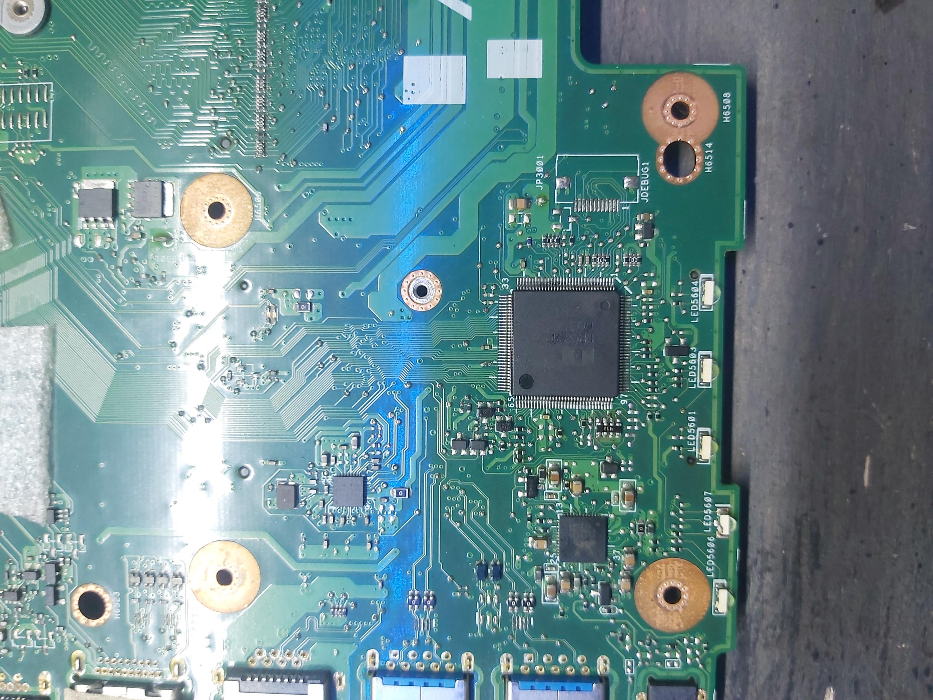

                  Can you post a picture of your logic board near the touchpad connector?
                  Then will see it matches my boardview file.
                  For the missing resistor network, do you see the pads?
                  Maybe share a pic of that area as well.

                    The touchpad is detached
                    TP CLK = 0v
                    TP DAT = 3V
                    Touchpad installed condition
                    TP CLK = 0V
                    TP DAT = 0.69V

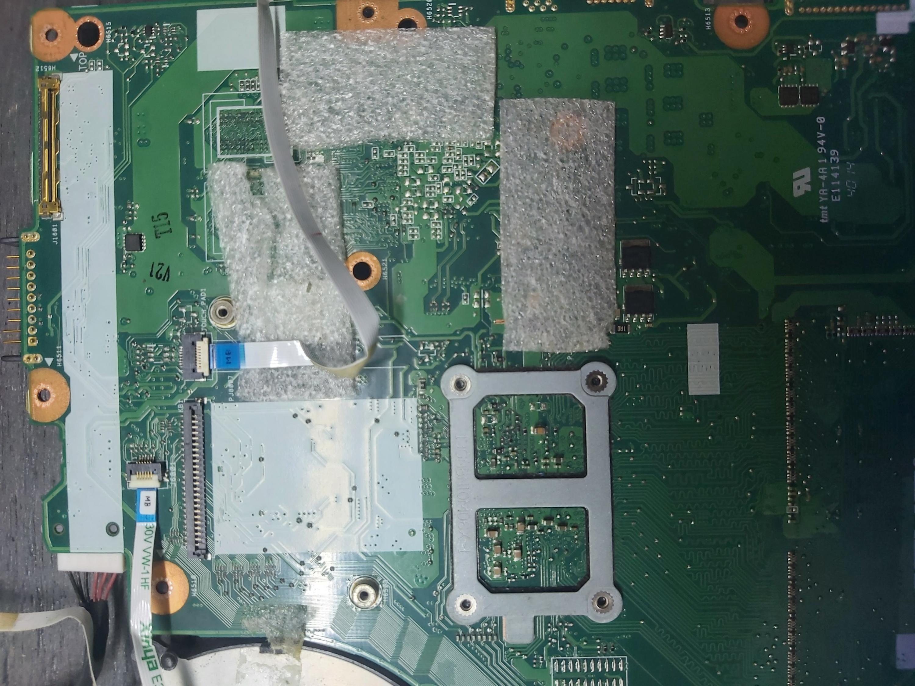

                    this measurement on RN5202 near KBC

                      Ini pak

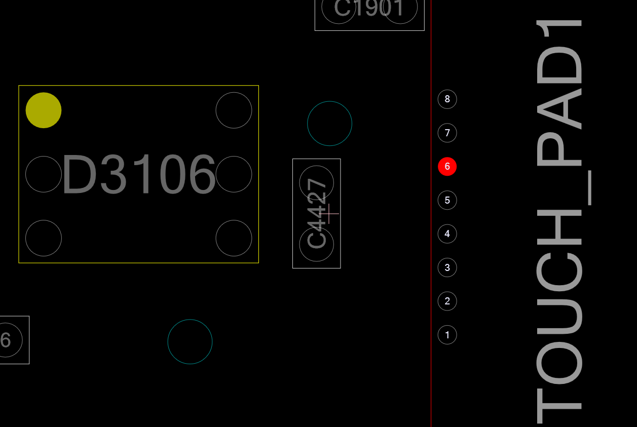

                            Re: Asus x450ep rev 2.0 touchpad synaptics not detect
                            Review the ESD protection device that should be present on your logic board.
                            See attached. If you do see this part, proceed to check the resistance to GROUND.
                            Test as follows:
                            1) Remove all power.
                            2) Meter in resistance mode (start with the lowest scale). If you see '1' or 'OL' then use the next higher scale on your meter.
                            3) One meter probe to ground.
                            4) Other meter probe to DATA pin. You can use either probe - resistance does not have a polarity.
                            What is the reading ?
                            5) Repeat but use the meter probe on CLK and GROUND.

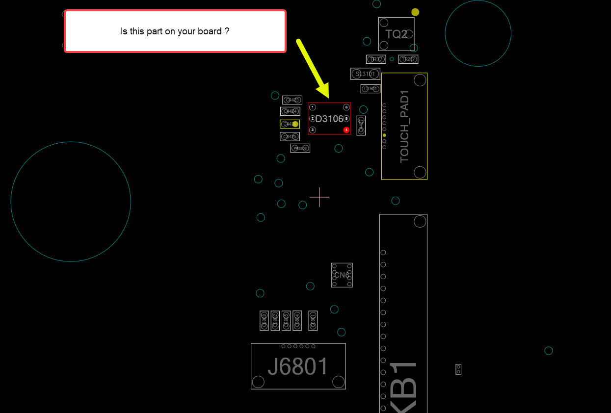

                                  Can you confirm again if D3106 is on your logic board ?
                                  Next, remove all power. Meter in resistance mode.
                                  Check the resistance to ground for the following pins on the touchpad connector:
                                  Pin # 2 O_TP_SCLK
                                  Pin # 3 O_TP_SDA
                                  Pin # 5 O_TP_DATA
                                  Pin # 6 O_TP_CLK
                                  After the resistance check -> meter in voltage mode -> check the voltage of the same pins.
                                  Post the resistance and voltage checks. When checking resistance - NO POWER !!
                                    no sir this is empty
