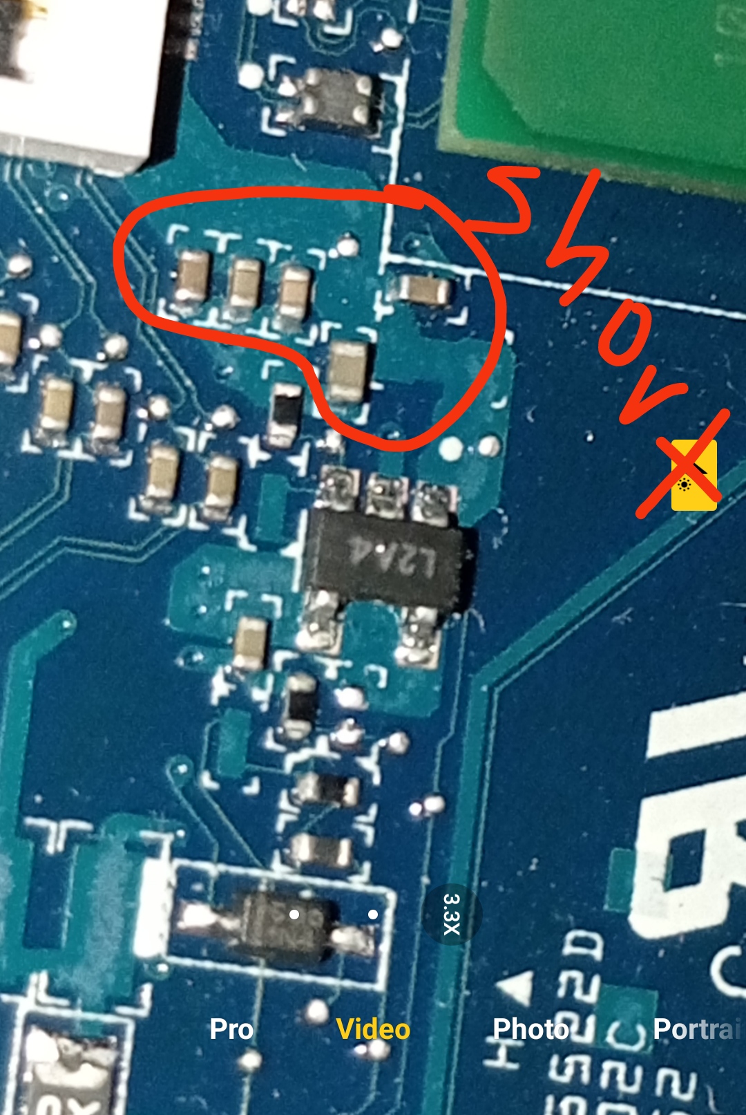

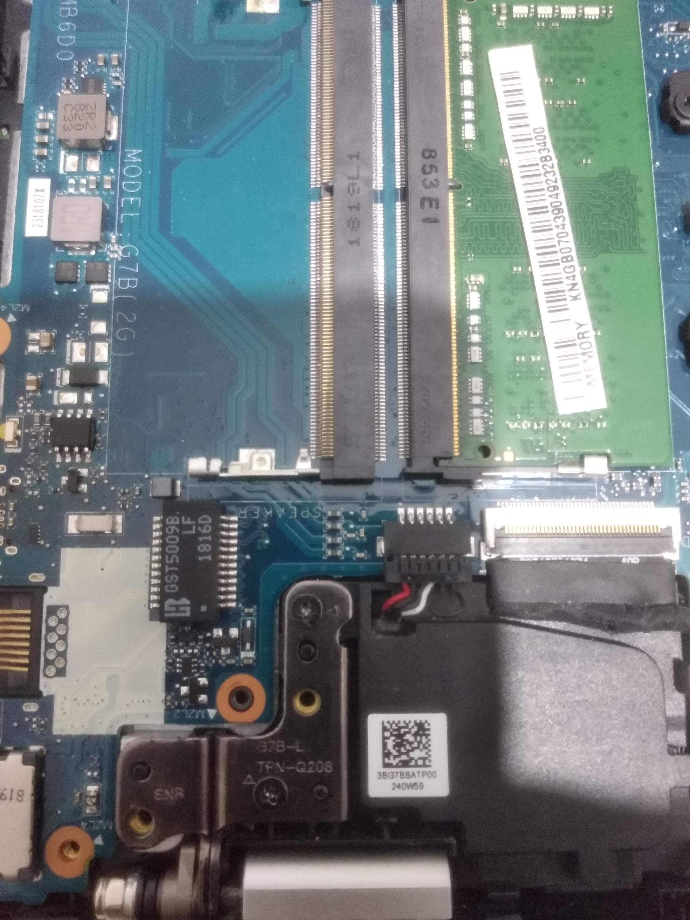

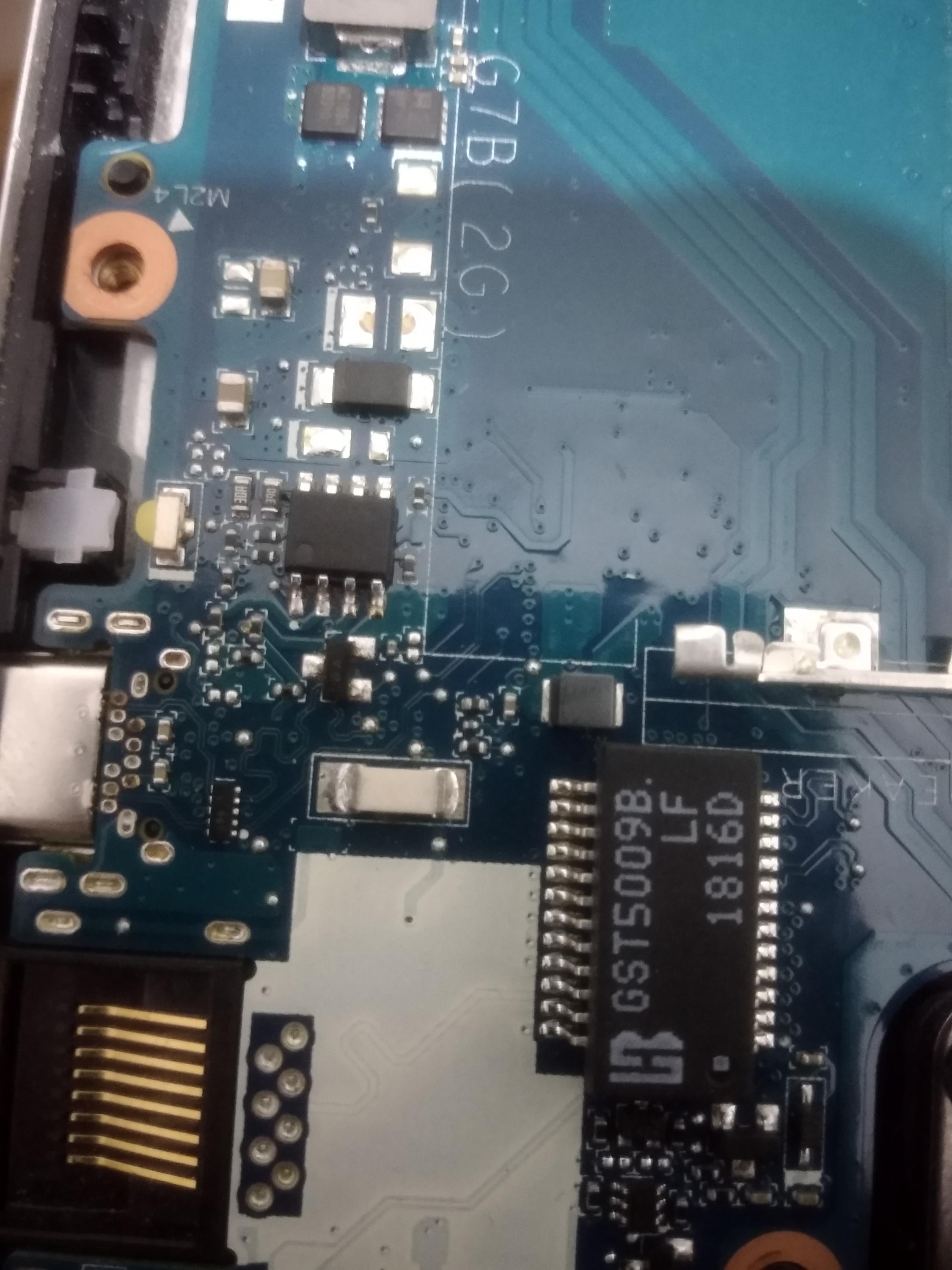

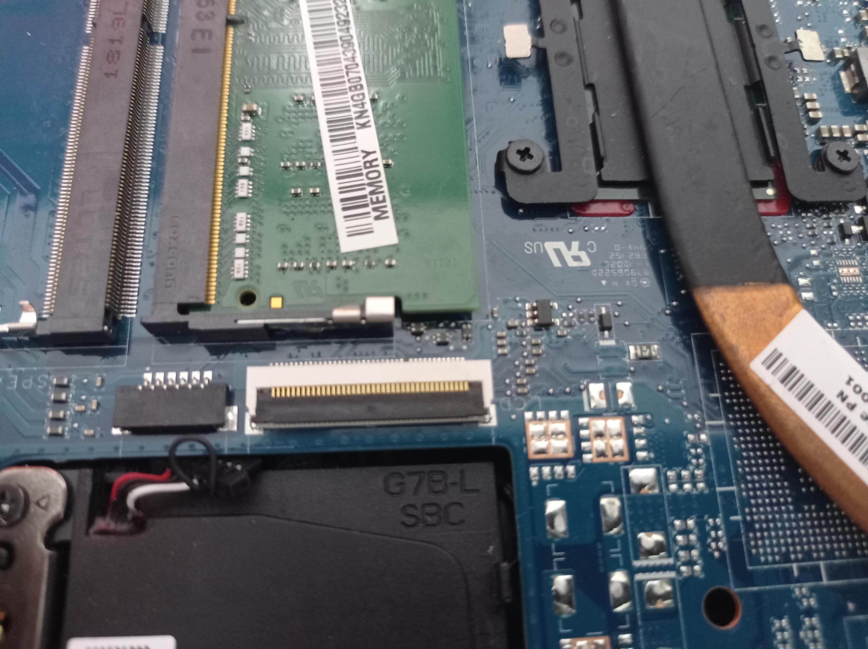

HP Laptop not detecting internal screen (HP 15-cs0906nz)
  • honestmstk
    • Apr 2020
    • 10
    • California
    HP Laptop not detecting internal screen (HP 15-cs0906nz)
    Hello everyone, as mentioned in the title im having problems with the screen circuitry. When i got the laptop it had a burnt hole in its screen cable and a few broken wires. It displayed on an external monitor without issue, still does. I ordered a replacement cable and popped it in today but still nothing.
    I then looked around on the board to see if theres a fuse that couldve blown and found one. Not entirely sure if its a fuse, i mean its white ( ill be attacing pictures), but it doesnt have continuity. I looked to see where the connection went and from the left side of the fuse it beeps on a few wires on the screen connector. It also seems to be a ground which makes little sense to me (the left pad on the fuse). The same pads on the lcd connector are still grounds even with the fuse broken. I also saw that the left pad of the fuse is connected to a three pad mosfet(?) above it. I tested the mosfet and its also showing weird behaviour, unlike the other ones on the board. I even tried replacing it and at first it tested differently and after turning on and off the laptop it started behaving like the previous one- the ground pad and the one next to it short. And thats where my ideas stop, what could be the fried component and why has the fuse allowed them to fail?
    The board id is DA0G7BMB6D0 rev d and i was unable to find a boardview.
    Many thanks in advance to the members of this amazing forum, even if we dont figure it out.
    EDIT: Even if that is a fuse i dont think it has anything to do with the display connector, i could be wrong still. The fuse is shorted to ground on one side and has no voltage going through it on the other.
    Last edited by honestmstk; 05-16-2022, 01:35 PM.
  • Stevedb
    Stevedb
    • Feb 2018
    • 622
    • Belgium
    Re: HP Laptop not detecting internal screen (HP 15-cs0906nz)
    Yes it is fuse . So you have short there that is why the fuse blown how much ohms resistance to ground do you have exact there.
    • Stevedb
      Stevedb
      • Feb 2018
      • 622
      • Belgium
      Re: HP Laptop not detecting internal screen (HP 15-cs0906nz)
      How much resistance do you have on +19v on the lcd connector.
      • honestmstk
        • Apr 2020
        • 10
        • California
        Re: HP Laptop not detecting internal screen (HP 15-cs0906nz)
        Around two ohms on the fuse. Can you tell me which pin is the 19 volt on the connector? Ill try my best to find it in the meantime. Thank you
        • honestmstk
          • Apr 2020
          • 10
          • California
          Re: HP Laptop not detecting internal screen (HP 15-cs0906nz)
          Originally posted by Stevedb
          How much resistance do you have on +19v on the lcd connector.
          I tried going from the right pad of the fuse (the side which is disconnected from everything and not a ground) to the pins of the lcd connector, and not a single beep. I thought the voltage pins would be connected to that, guess not.
          • Stevedb
            Stevedb
            • Feb 2018
            • 622
            • Belgium
            Re: HP Laptop not detecting internal screen (HP 15-cs0906nz)
            If you have a picture mostly it is the big track that goes to three or 4 pins. By the way if you have a short to if you disconnect the screen?
            • honestmstk
              • Apr 2020
              • 10
              • California
              Re: HP Laptop not detecting internal screen (HP 15-cs0906nz)
              Originally posted by Stevedb
              If you have a picture mostly it is the big track that goes to three or 4 pins. By the way if you have a short to if you disconnect the screen?
              Its kind of blocked by the ram slot so i dont see which track it is, but i measured all of them
              4 or 5 are measuring 1ohm
              2 are measuring 46 ohms (not next to each other)
              rest are open line
              • honestmstk
                • Apr 2020
                • 10
                • California
                HP Laptop not detecting internal screen (HP 15-cs0906nz)
                So this is a continuation of this tread: https://www.badcaps.net/forum/showthread.php?t=106465, since it went cold i cant expect any help there.
                TLDR: The laptop model from the title works on external display, doesnt display to an internal one, i found new clues.
                The white thing i thought was the backlight fuse isnt that 100%, tested on another similar laptop which has a working screen and it measures the same behaviour. Its to do with one of the ports.
                Other thing i found are 5 capacitors which are shorting to ground on both sides right next to the LCD connector, not like false beeps on the multimeter, full on 1 ohm short. And the only thing nearby is a 5 legged chip with the marking L2A4. I couldnt find the pinout for it. On the side with 3 legs, 2 are shorting to ground, other legs are not. Is this normal for a L2A4 chip?
                I will attach a picture of the 5 capacitors and the chip. Hopefully you can help me figure this out. Thanks in advance.
                Last edited by honestmstk; 06-23-2022, 06:41 PM.
                • honestmstk
                  • Apr 2020
                  • 10
                  • California
                  Re: HP Laptop not detecting internal screen (HP 15-cs0906nz)
                  Update: i fixed the problem.
                  So if anyone from the future sees this, it was the 5 pin L2A4 mosfet. It shouldnt be shorted to ground on any pins other than the middle one of the 3. I didnt have an exact one, but used one from a 2010 macbook air motherboard. The thing that gave me confidence was the fact that it was right next to the lcd connector- so it served the same purpose as mine. And im really bad at understanding datasheets for the various chips.
                  • mon2
                    • Dec 2019
                    • 13830
                    Re: HP Laptop not detecting internal screen (HP 15-cs0906nz)
                    Well done! Thanks for updating the thread.
                    • honestmstk
                      • Apr 2020
                      • 10
                      • California
                      Re: HP Laptop not detecting internal screen (HP 15-cs0906nz)
                      Thank you, really proud of myself for managing it, especially after a repair shop held the laptop for 2-3 weeks and didnt even try to diagnose by the look of things.
                      • Stevedb
                        Stevedb
                        • Feb 2018
                        • 622
                        • Belgium
                        Re: HP Laptop not detecting internal screen (HP 15-cs0906nz)
                        Good work man , congratulations
                        • VcemPzd
                          Black screen Lenovo legion 5 pro 16ACH6H gaming laptop
                          by VcemPzd
                          Hello everyone !
                          My name is Chris, I am a 30 years old embedded software developer working in the automotive industry. I am really passionate about learning new skills and repairing/crafting stuff. I came around this forum last week with the goal of repairing my faulty gaming laptop, indeed, I was video editing on it when suddenly a black screen popped and never disappeared I bought some stuff to try to repair it and learn as many things as possible about computer repairs but nothing worked so far. When the black screen appeared, my legion 5 pro was connected to my external monitor...
                          04-28-2025, 10:14 AM
                        • Benass
                          Surface Laptop 3 Not Detecting SSD - Need Help!
                          by Benass
                          Hey everyone,
                          I'm having an issue with my Surface Laptop 3, and I could really use some help. I've tried everything I can think of, but my laptop just won't detect any new SSDs I install. Here's a rundown of the situation:
                          Problem:
                          • My Surface Laptop 3 isn't detecting any new SSDs, including a Sabrent Rocket 2230 256GB NVMe SSD and a Dogfish 256GB M.2 2230 NVMe PCIe Gen 3.0 x4 SSD.
                          • Both SSDs work fine in other laptops, so I know they are functional.
                          • The laptop does detect a Forsee 64GB SSD from my Steam Deck, and I can successfully install Windows on it.
                          What I've Tried:
                          1. Compatibility
                          07-22-2024, 11:26 PM
                        • jean luc ferre
                          laptop hp g72 b52sf screen problems
                          by jean luc ferre
                          on this laptop hp g72 b52sf i have screen problems as you can see with the photo joined in attachments.
                          the used graphic card is "intel hd graphics" and the id of the integrated screen is : "monitor/SEC3354".
                          i verified the driver of the péripherals and they are ok. i verified the definition and settings of the graphic card and of the screen : definition 1600x900 and refreshment frequency :60hz. (they are the sames for the graphic card and the screen).
                          i don't understand the reasons of the white stripe at the bottom of the screen below the task...
                          06-07-2025, 03:27 PM
                        • AccountSaver
                          Lenovo Thinkpad E15 Gen 2 NM-D011 - No display ? External , yes!
                          by AccountSaver
                          Here is a pretty crazy one.
                          Step 1.
                          Laptop was brought to me as dead not working. Removed everything , cleared everything.
                          Step 2.
                          Some liquid damage close to the Type - C connector, and the connector even though it was cleaned wasn't charging the battery . Removed the Type-C port, and replaced it. Now the laptop turns on and charges battery. Shows external screen , not internal.
                          Step 3.
                          Took out the screen and checked it to a secondary Gen 2 i have, screen works like a charm.
                          Step 4.
                          Lets ,dive into the board. I see the edp cable on the...
                          05-07-2025, 07:16 AM
                        • Admin
                          Other Useful Threads - Laptop Screen Compatibility, Useful ICs, BGA Chip Suppliers, NVidia bumpgate
                          by Admin
                          Some sticky topics have been moved to this thread:
                          Laptop Screen Compatibility
                          - finding a compatible laptop screen with LED-backlight.
                          Laptop Screen Compatibility
                          Most Common ICs - a list of the most common ICs (Integrated Circuits) required for repairing a laptop
                          MOST COMMON IC FOR LAPTOP YOU SHOULD HAVE IN STOCK
                          Let's Talk About BGA Chip Suppliers - anyone who repairs computers at component level has had to order chips from China at some point. Large BGA chips like graphics chips, chipsets and now CPUs are in increasing demand, due to their...
                          12-27-2023, 03:43 AM
