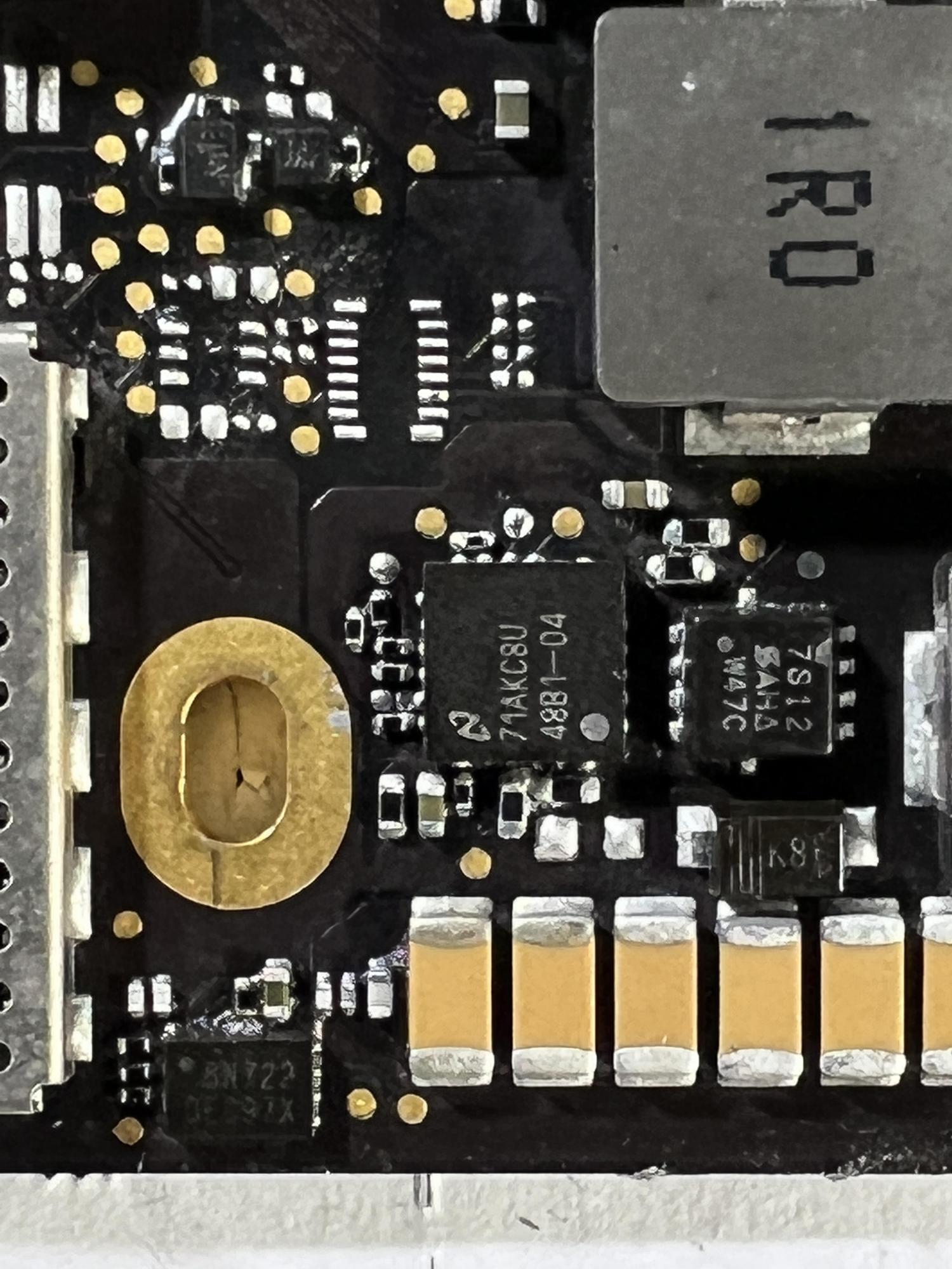

        sorry my mistake. i measured wrong current sense resistor.
        the current sense resistor is R8400 right?
        the resistance between the fuse and the current sense resistor is 0.5 ohm
        the voltage at the end of current sense resistor is 13V
        hereby i attached the U8400 that i took from A1502

          Re: macbook pro 820-00840 have image no backlight
          Is this a pic of the donor board or the board you are are repairing ?
          • kingskie
            • Oct 2014
            • 249
            • indonesia
            this is the pic of the board that i am working on. 820-0040
                Use the boardview file to confirm that no parts are missing around this backlight IC:
                https://www.badcaps.net/forum/showthread.php?t=69489
                See some blank pads in the pic. Also no solder shorts.
                Have not had enough quality time to review the same.

                  yes @mon2 all the parts are there. the bank pads is no stuff in the schematic.

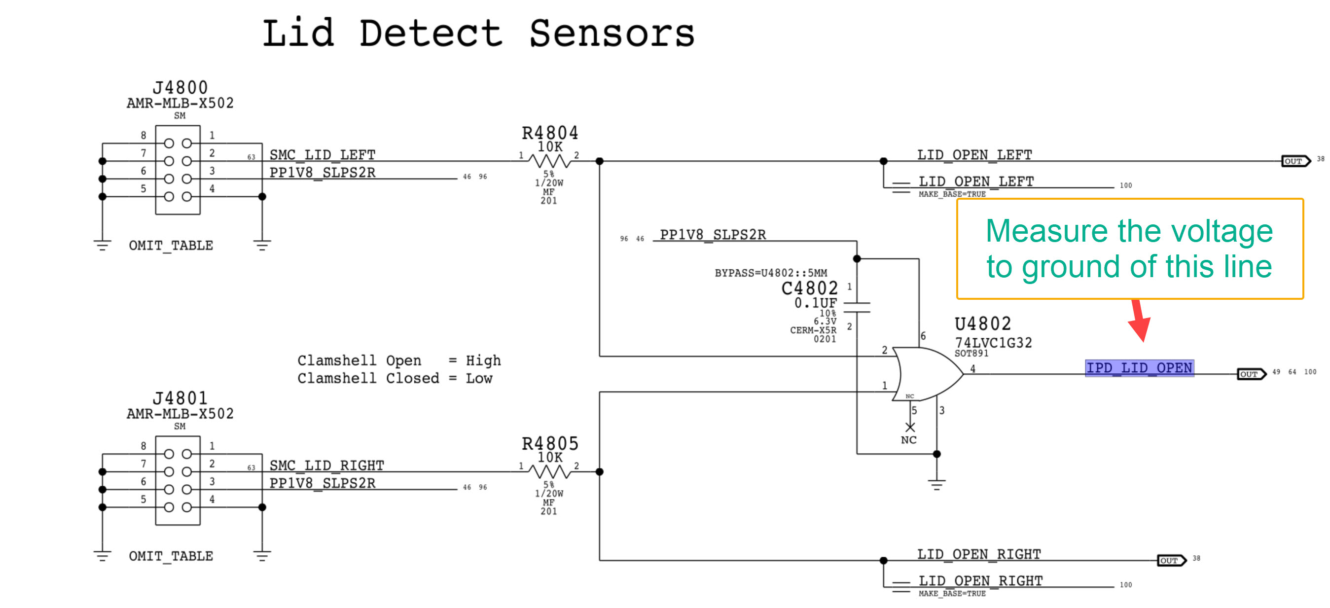

                        Hello and welcome to the forum.
                        Does your macbook power up and offer a display? (without the backlight)
                        Can you see the usual graphics with the aid of a flashlight / cellphone torch light?
                        There is a lid sensor inside the trackpad. A hall effect switch is used to detect if the lid is open or closed.
                        You can check the voltage to ground of this lid sensor as a start. If the lid is considered to be open, then the ENABLE state will follow to enable the boost LED circuit @ U8400.

                          Good morning and thanks for replay so fast.
                          yes the screen works without the backlight, we can see the dark image, regarding the lid sensor inside the trackpad it gives me 1.8 volts in IPD_LID_OPEN

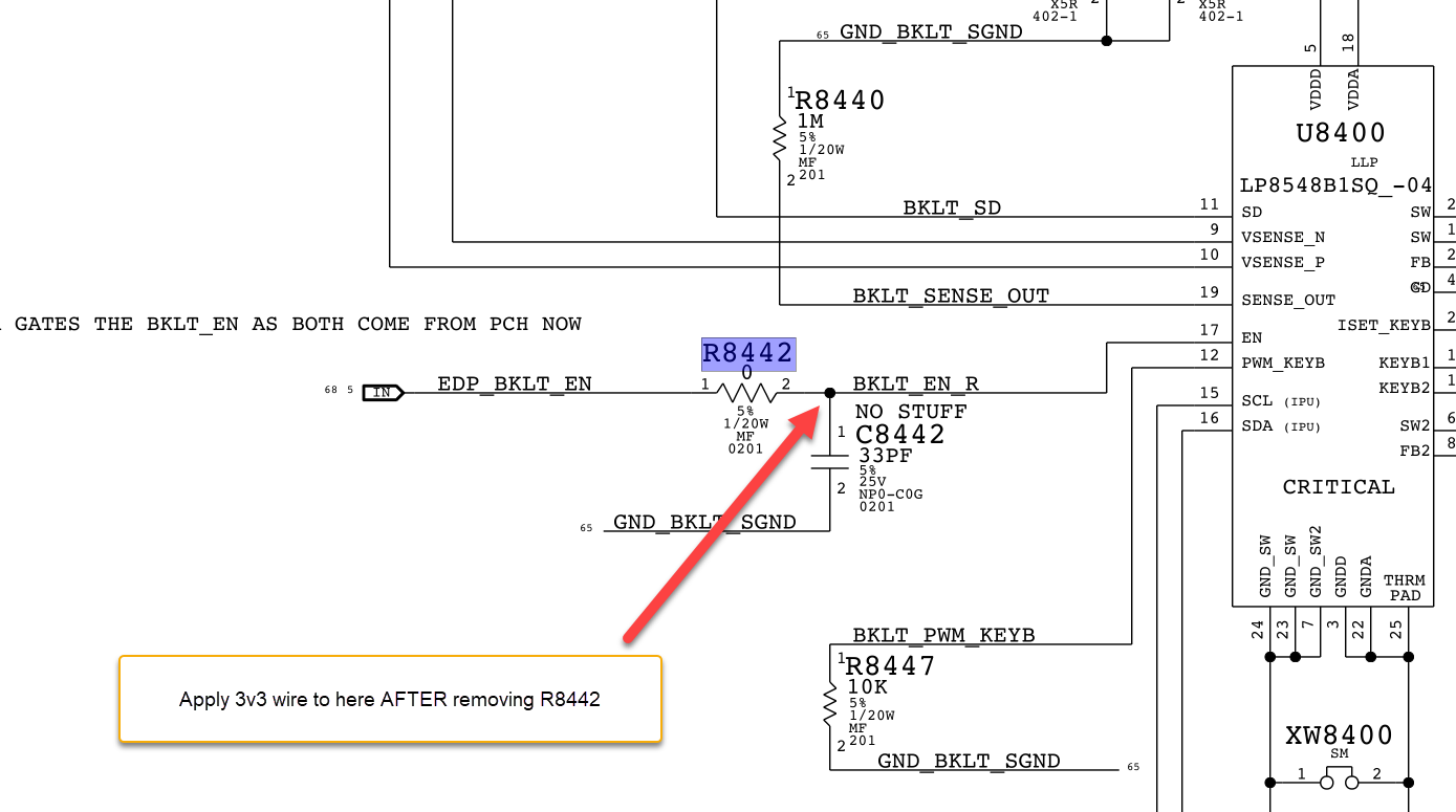

                            Remove all power. What is the resistance to ground of EDP_BKLT_EN?
                            • Sacred0489
                              EDP_BKLT_EN 9kohms resistence to ground on R8442
                              • mon2
                                • Dec 2019
                                • 14240
                                #35
                                So it is not shorted.
                                Check the voltage to ground of:
                                ISNS_LCDBKLT_P
                                ISNS_LCDBKLT_N
                                There should be little or no voltage drop across these 2 test points else the boost circuit will be turned OFF due to an excessive current draw.
                                Confirm the resistance to ground of PPVOUT_S0_LCDBKLT. No power when checking resistance.
                                If the resistance is not low, continue...
                                Remove R8442. Solder a wire from R8442 pcb pad # 2 = EN pin on the backlight IC to a 3v3 rail on the logic board.
                                This is to manually enable the backlight IC with a logic '1'. This bypass should then provide for a voltage divider to lower the gate voltage @ Q8400 mosfet to allow for the 12V to enter the boost circuit.
                                Does this enable the backlight for your board?
                                  ISNS_LCDBKLT_P
                                  ISNS_LCDBKLT_N
                                  ISNS_LCDBKLT_P 11.96 Volt
                                  ISNS_LCDBKLT_N 11.96 volts
                                  PPVOUT_S0_LCDBKLT has no power and is not shorted to ground, on R8442 #2 = pin to BKLT_SD pin 1 is LCDBKLT_EN_L so the 3v3 i put on the pad #2 or #1
                                    See attached.

                                        After you applied this bypass enable, what is the voltage to ground of PPVOUT_S0_LCDBKLT?
                                        • Sacred0489
                                          • Sep 2022
                                          • 21
                                          • Spain
                                          #40
                                          PPVOUT_S0_LCDBKLT i check the voltage in the bypass and is 3.3 volt but i still haved 0 volt on PPVOUT_S0_LCDBKLT

                                            I have only 8V on backlight line but no high voltage in boost circuit, I have checked all components like caps and diode and they seems to be ok.
                                            I have noticed that when macbook chimes after turning on there is no image at all even with flash light,
                                            I have tried 2 different OEM LCD and still there is no image,
                                            I see the LCD fades out when i remove power or turn off the macbook.
                                            I have 2 problems
                                            1 No image
                                            2 No backlight, but i have 8VDC on backlight circuit.
