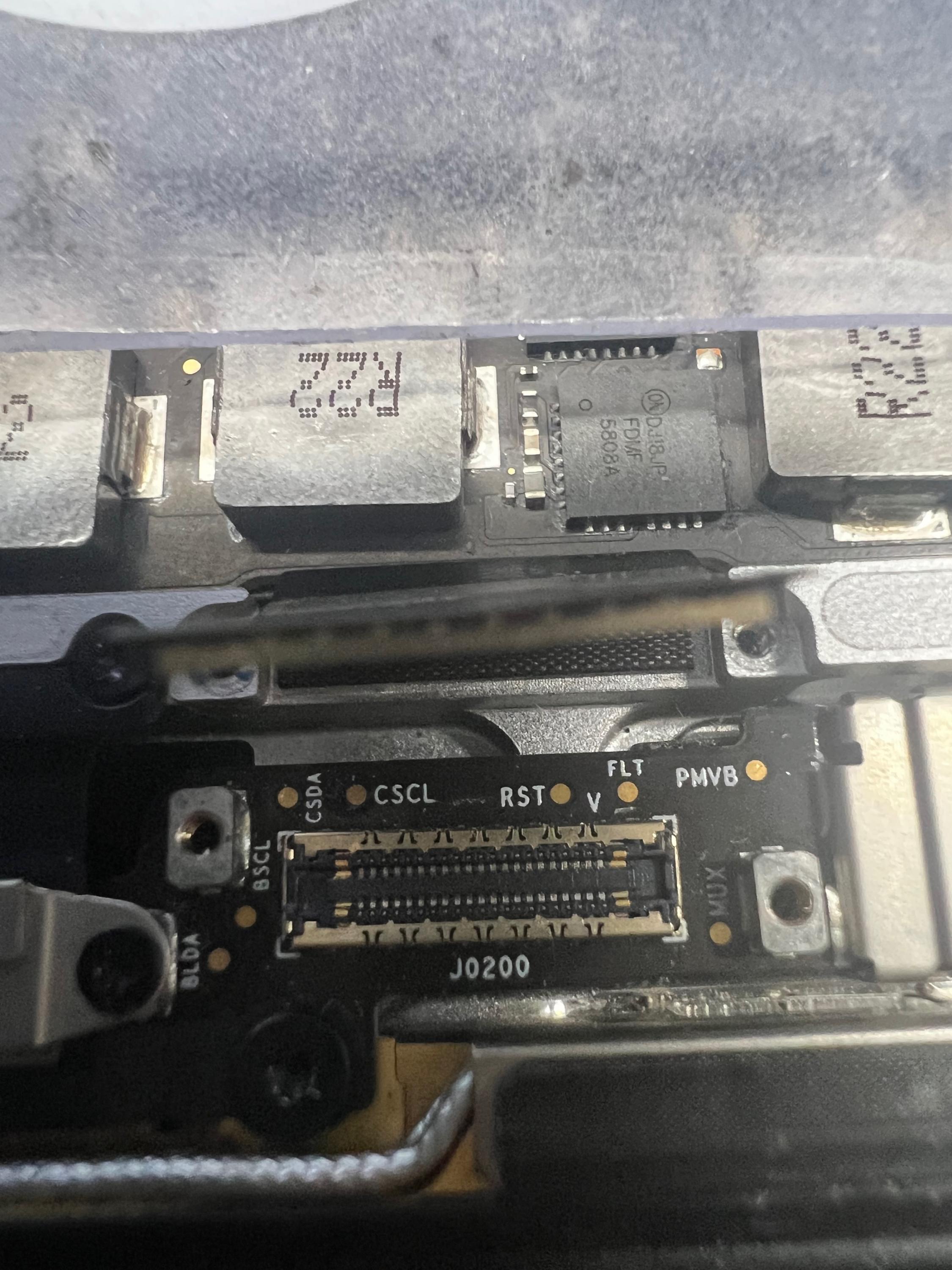

                      Excuse me, I have tested the voltages in the test points that are below the connector. I think that this is what you were referring to and I only get 5 volts. i attach a pictures with the connector and 11 volt
                      • mon2
                        • Dec 2019
                        • 14662
                        #51
                        Re: macbook pro 820-00840 have image no backlight
                        Will check the schematics once at the office.
                        Test the test pads in the picture you posted.
                        BSCL, BSDA, etc. Check their voltage to ground.
                        • Sacred0489
                          • Sep 2022
                          • 21
                          • Spain
                          #52
                          OK thank so much the repair shop are close the weekend so i see you at monday thank a lot for the help
                          • Sacred0489
                            • Sep 2022
                            • 21
                            • Spain
                            #53
                            So i have a time to take meditions and in this two test point i have
                            BSCL - 5v
                            BSDA - 5v
                            • mon2
                              • Dec 2019
                              • 14662
                              #54
                              Ok. Continue to test the other test points that end with SCL and SDA.

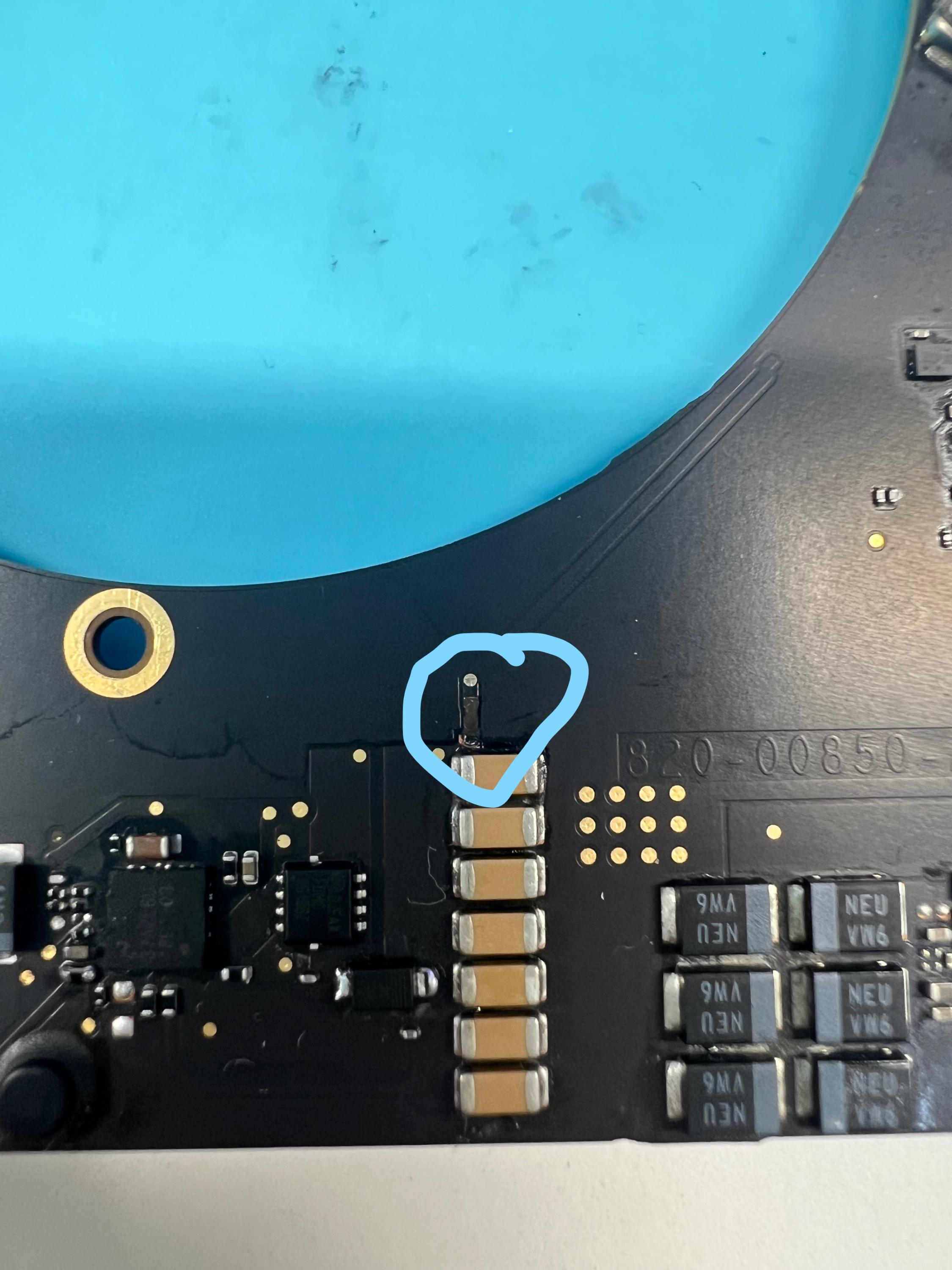

                              • Sacred0489
                                • Sep 2022
                                • 21
                                • Spain
                                #55
                                Good morning and sorry for the time off i am on holidays, this morning and detect a missing component but i cant find on any schematic o buit map i Attach the pictures.
                                I think maybe this is the cause for the not backlight

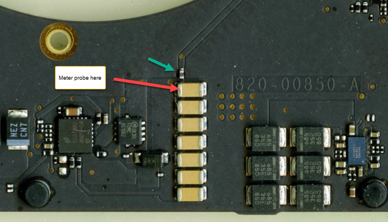

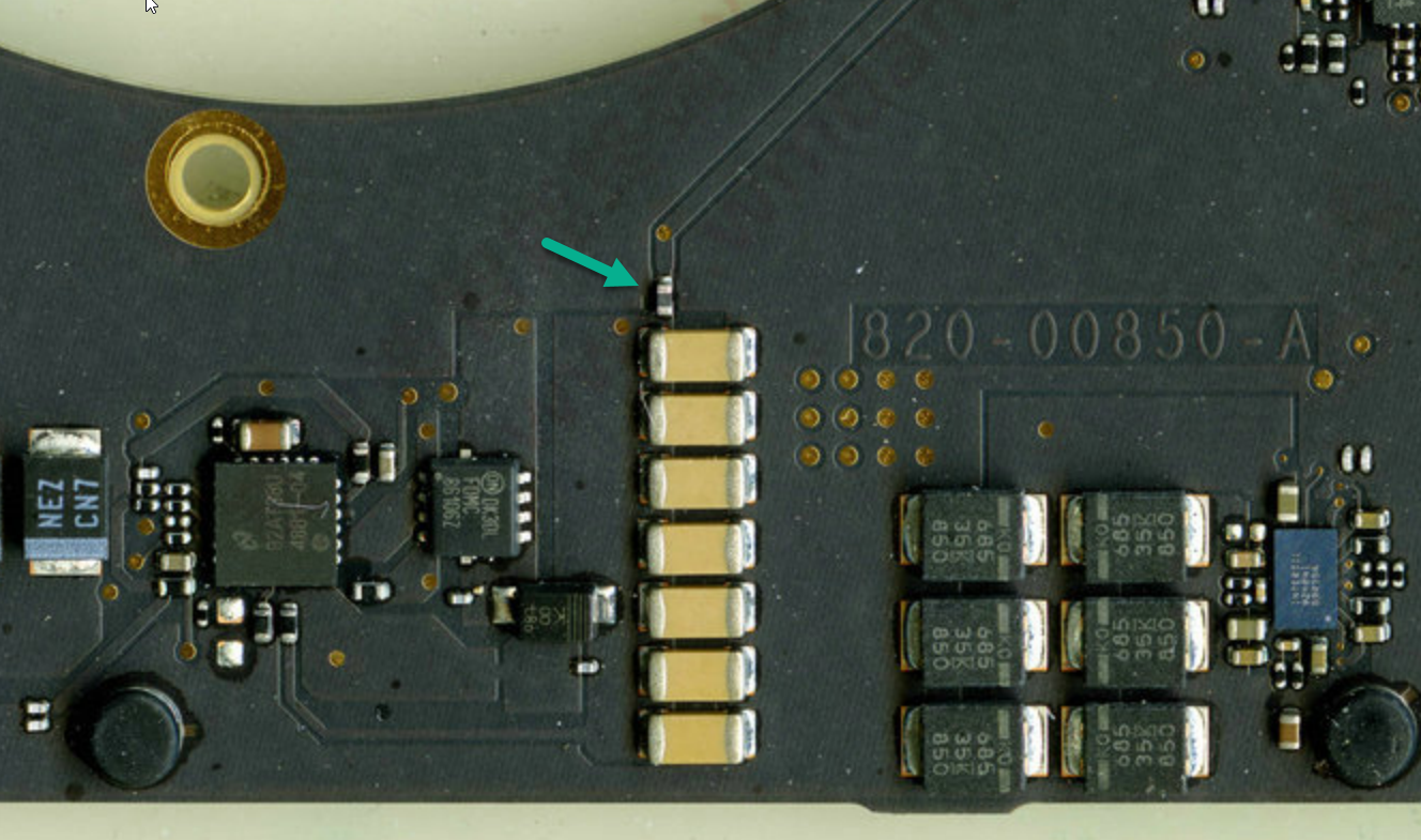

                                • mon2
                                  • Dec 2019
                                  • 14662
                                  #56
                                  Attached.
                                  Remove all power. Meter in DIODE mode. Short your meter probes. Meter should tone beep.
                                  Connect one meter probe to any of the large caps shown with the arrowhead. These caps are mated with the PPVOUT_S0_LCDBKLT backlight rail.
                                  Other meter probe to pin #43 of the LCD connector @ J8500.
                                  Do you hear a tone beep? If not, that trace with the missing part is broken and needs to be fixed.
                                  Suggest to scrap a bit of black solder mask with a sharp knife to confirm that the large trace around the fan opening in the PCB is truly the same PCB trace leading to pin #43 of the LCD connector. Fairly confident that it is.
                                  Excellent find and observation of this PCB layout!!

                                    #57
                                    Attached.
                                    thanks for the picture in the schematic i get do not have the type of component that is why it is seen in the photo, it is a resistor, could you tell me what its values are, thanks

                                        #59
                                        Attached.
                                        from the cap to pin 43 there was no continuity so we scraped away the solder mask and tested the continuity to pin 43 and it had continuity , so i need to know find the value of the resister to replace it .
                                        • mon2
                                          • Dec 2019
                                          • 14662
                                          #60
                                          The schematic does not show this missing part.
                                          From the picture of the boardscan from a paid database, this appears to be a ferrite bead. It is not technically required for the operation so you can just short the pads to allow for the backlight to reach the LCD display.
                                          For initial testing, it is recommended to bridge the pads.
                                          Otherwise, this part looks like an 0603 or 0805 ferrite bead (1A or higher should be ok) - we like to use 600 ohms in our designs but 300 ohms should be ok.
                                          We use the parts from MaxEcho (Taiwan) but many others on the market are also ok to consider if you wish to apply this part.
                                          http://www.maxecho.com.tw/en/product...d__ACMS_series
                                          If possible, review the physical pad sizes on the pcb. Or as a plan B, take a part that is 0603 from any donor board and see if it fits over the pads you have that are missing this component. If it does not, try 0805 (will be a larger part). Then proceed to seek out a ferrite bead to replace this component.
                                          In summary, this part will clean up / filter noise on the LED backlight voltage.

                                            I have tried 2 different OEM LCD and still there is no image,
                                            I see the LCD fades out when i remove power or turn off the macbook.
                                            I have 2 problems
                                            1 No image
                                            2 No backlight, but i have 8VDC on backlight circuit.
