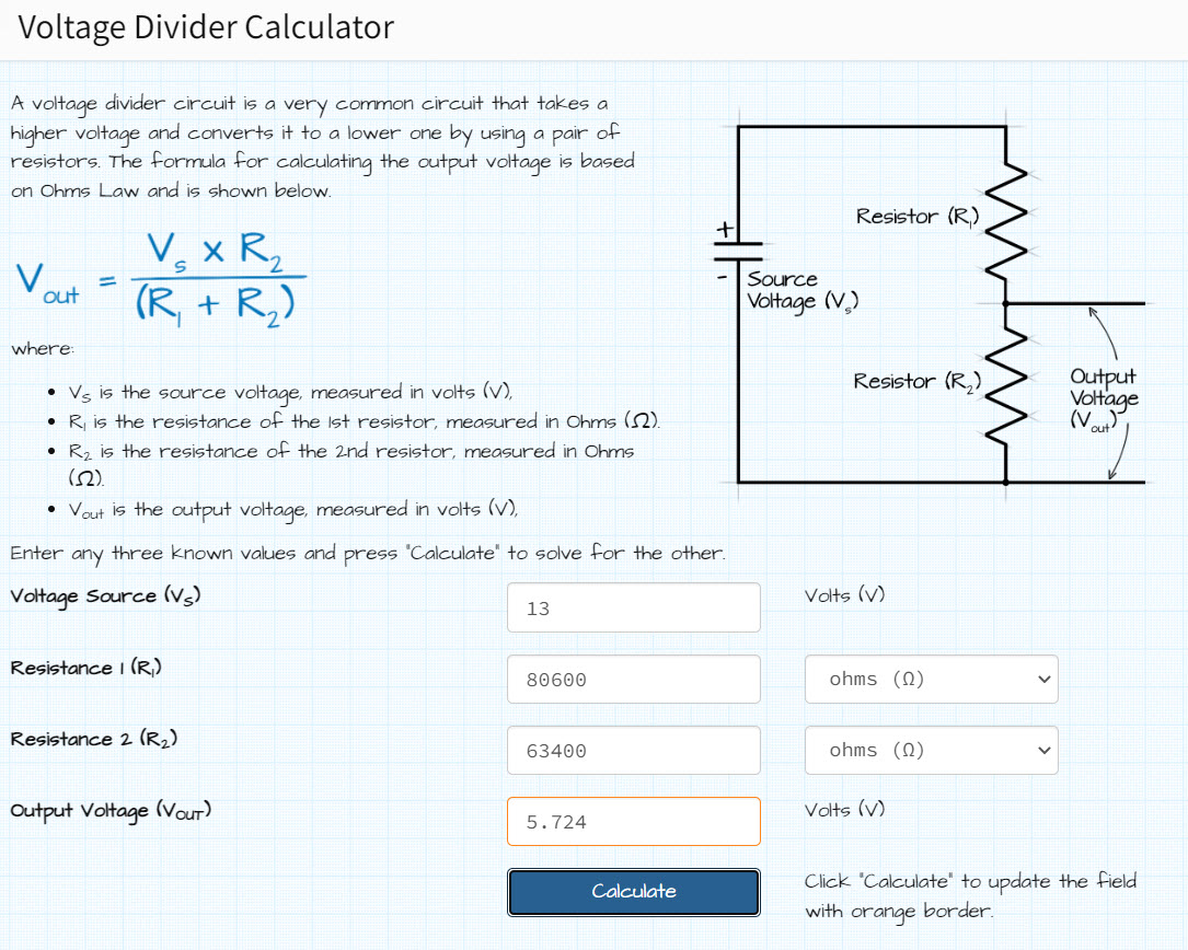

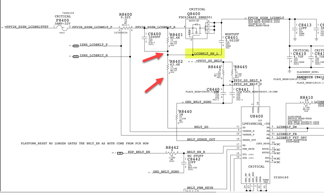

            What is the voltage of BKLT_SD ? (R8402, pin # 2) ?
            Q8400 mosfet will TURN ON if the GATE is lower than the voltage it is trying to pass between source & drain.
            You are measuring GATE = ~13 volts which is about the same as the PPVIN_S0SW_LCDBKLT_R so the mosfet remains OFF.
            To turn ON this mosfet, the voltage @ R8402, pin #2 must be LOW.
            Then R8402 & R8401 will create a resistor based voltage divider and the voltage at the gate will be a divided down voltage than PPVIN_S0SW_LCDBKLT_R.
            See attached - if all is well, you should see ~5v7 on the gate of Q8400 which will then allow for the backlight voltage to pass through and ideally turn on the backlight.

                        Yes. Let us test..remove R8442. Do not lose the part but it is only 0 ohms so a blob of solder can replace it.
                        Then apply a 3v3 voltage wire onto the C8442 pad (this capacitor is not stuffed). This is the same trace as R8442, pin #2. Locate the 3v3 rail on the board for this signal.
                        Your board is not enabling the backlight so the enable pin is low. The EN pin must be high to turn on the backlight boost IC.
                        With this manual enable, does the backlight turn on?
                        If any doubts or questions, just ask before proceeding.

                                  by force you mean when turn on i have to connect R8402 pin 2 to ground?
                                  • mon2
                                    • Dec 2019
                                    • 14673
                                    Re: macbook pro 820-00840 have image no backlight
                                    No. R8402, pin #1 which is the gate of the mosfet. Make that ground.
                                    We are selecting this point since we do not know if the backlight IC is driving the R8402, pin #2. That is, we do not want to force 2 outputs to challenge each other.
