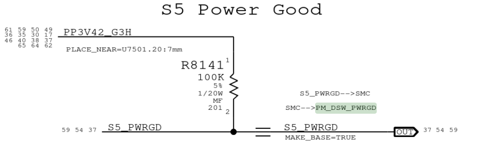

    I have green light become orange in a sec .
    Voltage reading :
    PM_slp_s4 0v
    PPVRTC_g3H 3.3
    PPBUS_g3h 8.6
    ppbus_s5_hs_computing_isns 8.5
    PP3v42_g3H 3.4
    PP5v_s5 5v
    PP3v3_s5 3.3
    PP3v3_SUS 0v
    P3V3SUS_EN 0v
    PP1V05_sus 0v
    RTC_RESET_L 3,3
    PCH_SRTCRSTL 3.3
    PM_DSW_PWRGD (DPWROK) 0v
    PM_BAT_LOW 3.3
    PM_RSMSRT_L 0v
    PM_PWR_BTN_L
    PM_SLP_SUS_L 0v
    S5_PWRGD 3.3
    PCH_DSWVRMEN 3.2
    PM_DSW_PWRGD 0v
    SMC_ADAPTER_EN 3.3
    PCH_INTRUDER_L = 3.2

      Review this:
      https://www.it-tech.com.au/mac-q-a/p...2ZQcVlaYV9LUGc.
      • lordgeny
        • Apr 2016
        • 223
        • Italia
        Re: a1466 820-00165 no power
        What could it be ? r8141 measures 100k
        • mon2
          • Dec 2019
          • 14677
          check the voltage on each side of r8141.
          Do you see +3v42 on r8141, pin # 1 ? This is an open-drain output and the r8141 pull-up resistor is required to pull up this line to a '1' state.
            pin 1 3.40
            pin 2 3.36

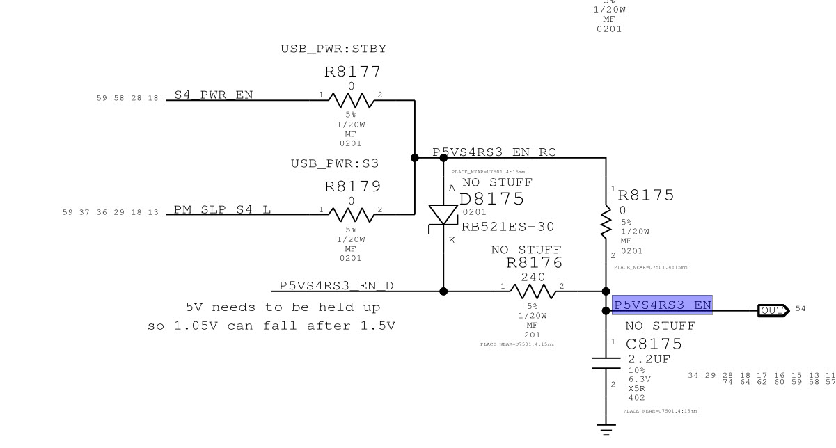

                      PP5V_S4RS3 not present

                        Review this thread:
                        https://boards.rossmanngroup.com/thr...v_s4rs3.59197/
                        • lordgeny
                          • Apr 2016
                          • 223
                          • Italia
                          P5VS4RS3_EN not present
                          P3V3SUS_EN not present
                          • mon2
                            • Dec 2019
                            • 14677
                            Post the voltage readings for:
                            S4_PWR_EN
                            PM_SLP_S4_L
                            • lordgeny
                              • Apr 2016
                              • 223
                              • Italia
                              0v both

                                  No point in checking random things, must fix things in order of the power sequence…
                                  • reformatt
                                    • Feb 2020
                                    • 1510
                                    Piernov is 100% correct. The power sequence is available here:
                                    https://logi.wiki/index.php/G3_to_S3..._and_Broadwell
                                    From the first post:
                                    S5_PWRGD=3.3 yet PM_DSW_PWRGD=0V
                                    Piernov alludes to this in his first post, however I guess this wasn't clear to the OP. You won't get to S4 beyond this signal, so troubleshooting beyond PM_SLP_SUS_L is a waste of time.
                                    PM_DSW_PWRGD comes from the SMC, so you need to be troubleshooting why this is low. Check all supplies around the SMC (PP3V3_S5_SMC_VDDA, PP3V3_S5_AVREF_SMC etc), also check for signs off liquid damage in this area. Sometimes you get crap under the SMC causing weird issues, so I remove the edge bonding and reflow it with flux. Could also be a crook SMC of course too.
