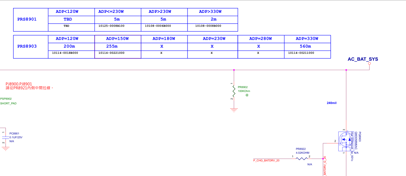

    Ok. This will be a painful one. I found some but from a paid service. Let me post some partial screen grabs.
    The BV file is horrible but may work.
    See attached.

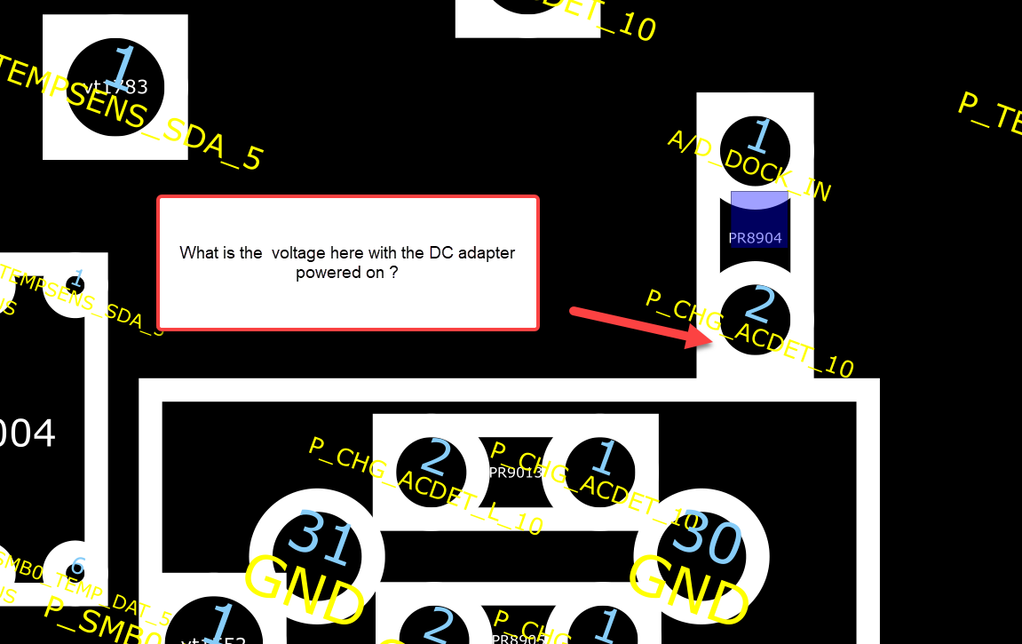

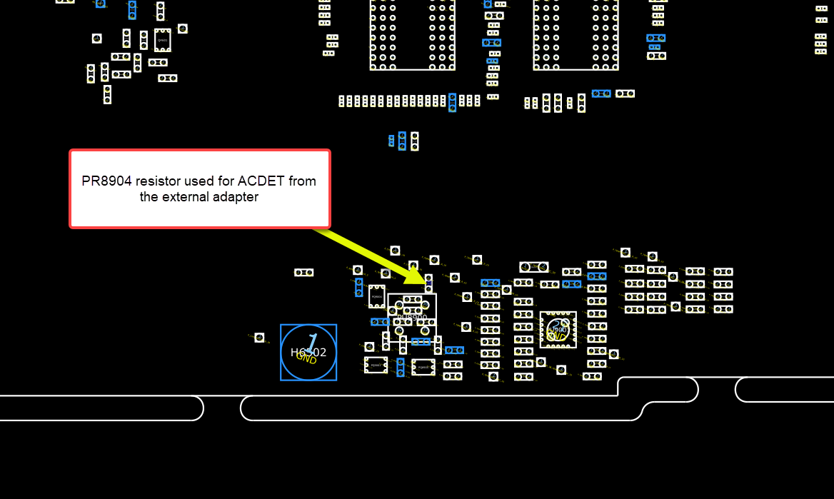

      #142
      Re: ASUS ROG G14 (GA401) battery spark, dead.
      See attached.
      Thank you, PR8904 are at 2.7V

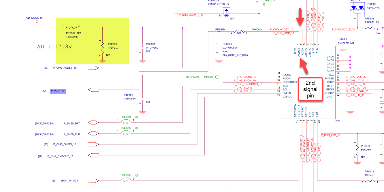

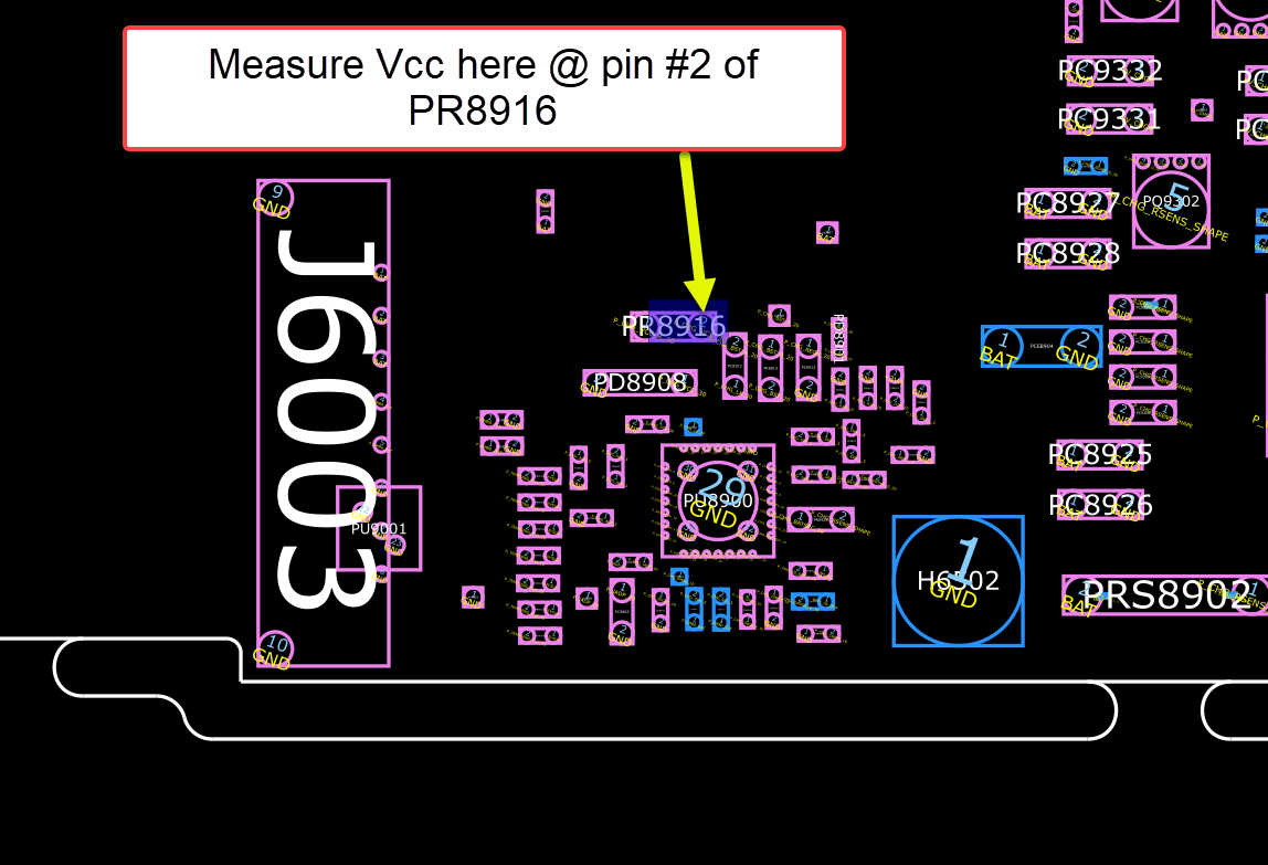

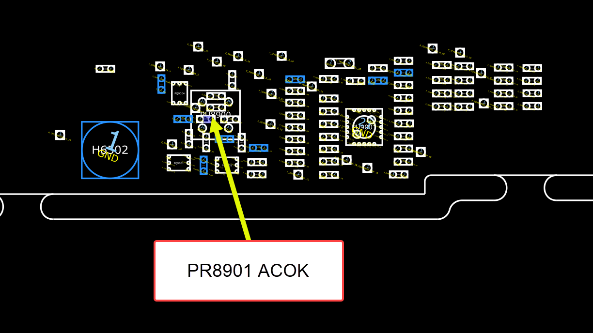

        #143

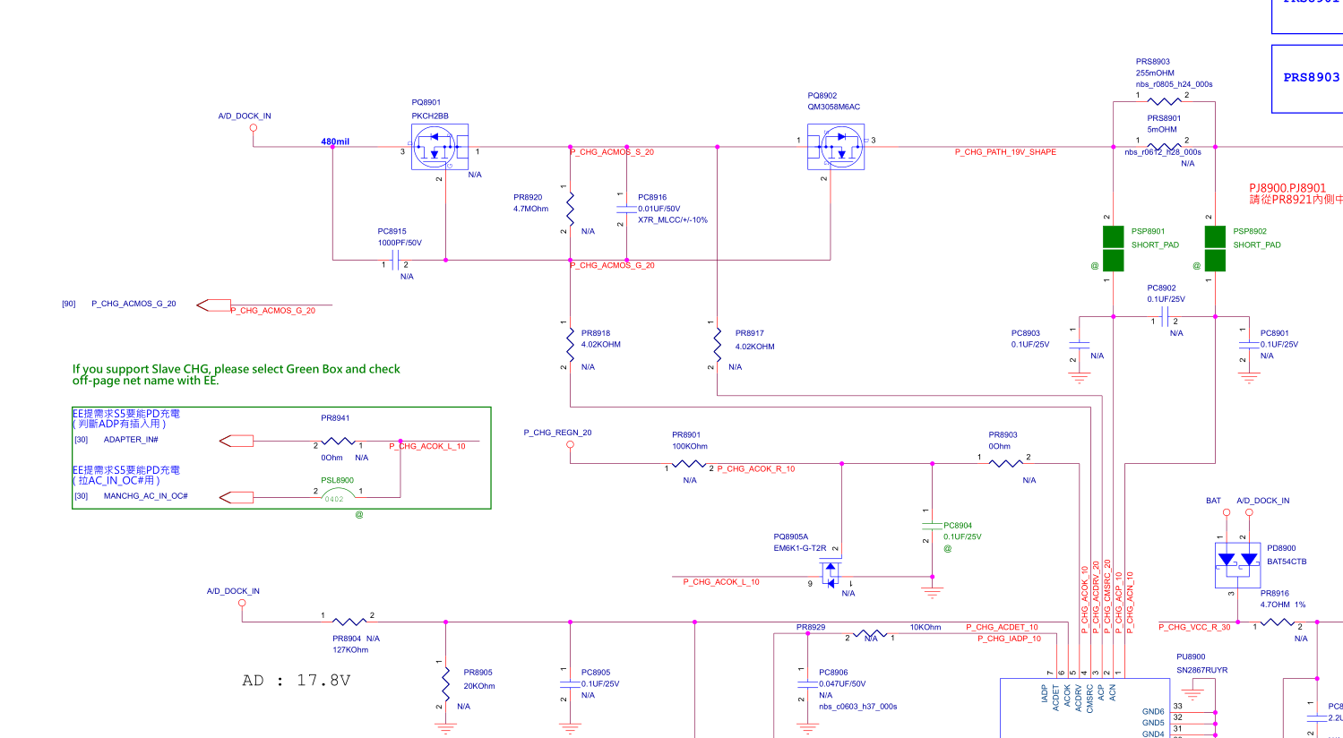

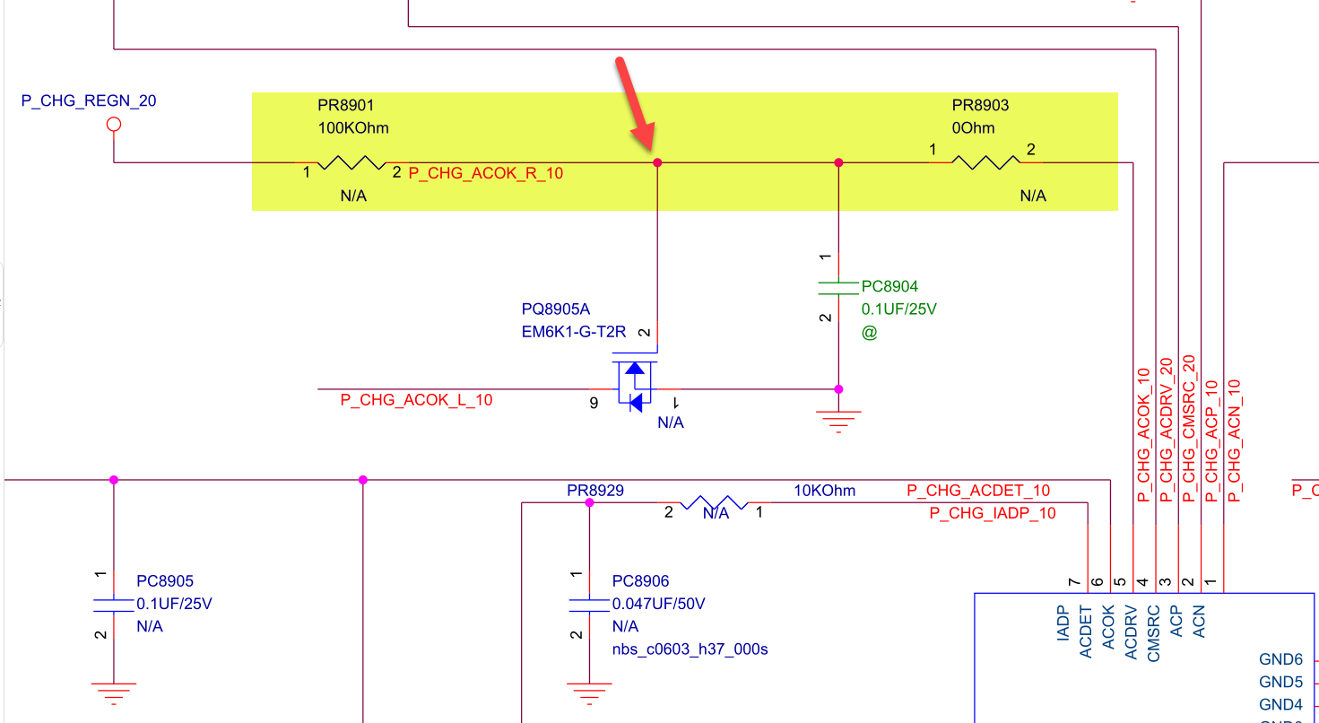

        ACDET is a good voltage.

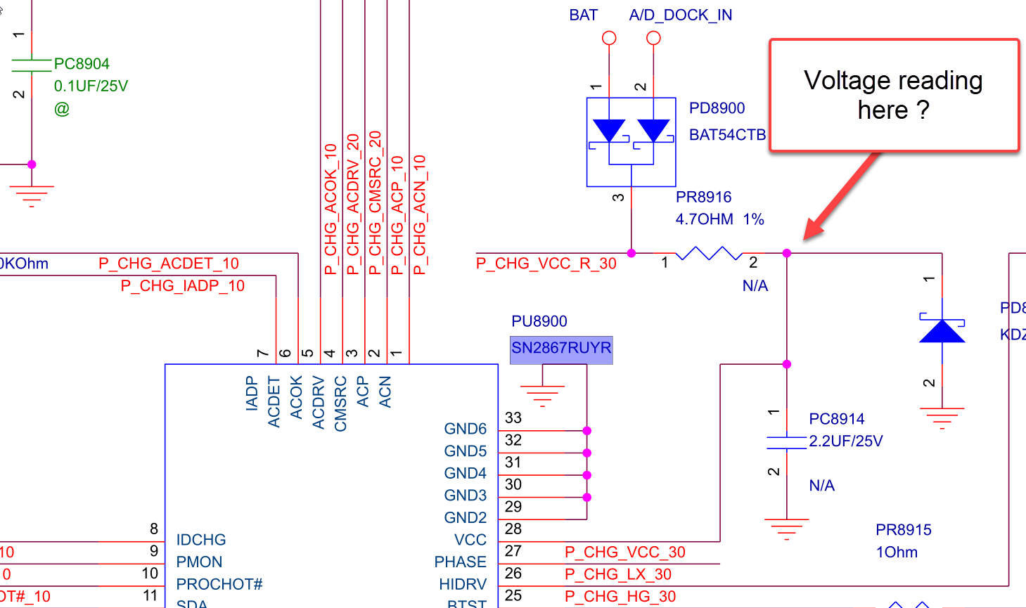

        See attached. Confirm that the VCC pin is being fed a proper voltage for the charger IC.
        Confirm the voltage of ACOK status. Check & post the voltage.
        • jacobtc
          • Apr 2016
          • 274
          • Denmark
          #144
          VCC on charging IC is 19.7V
          ACOK is fed 6V.
          Could it be a defective shorted battery? Voltage measures 0V on the battery, but it worked before, so maybe some internal protection got triggered?

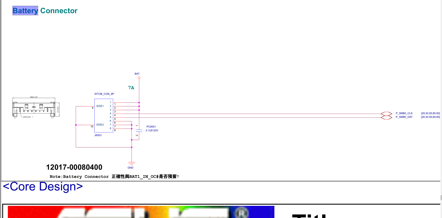

              #146
              Does the logic board function without the battery ? It should.
              If it does not, the battery is not a factor. For now, work without the battery.
              You can inspect the SMBUS (I2C) lines on the battery connector.
              Remove all power. Meter in resistance mode.
              Check the resistance to ground of the following:
              P_SMB0_CLK - pin 3
              P_SMB0_SDA - pin 4
              Red meter lead on the pin; black to ground.
              What are the resistance readings for each ?

                  #148
                  P_SMB0_CLK - pin 3
                  P_SMB0_SDA - pin 4

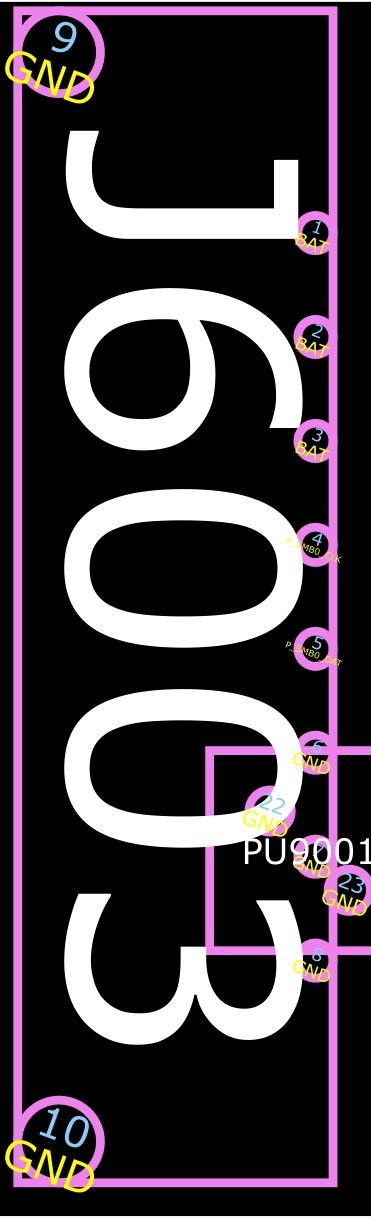

                  Yes, the board works without the battery connected.
                  Should I measure resistance on the battery, when it is not connected to the board, or on the terminals on the board, when the battery is connected?
                  Also, the connector does not seem to have a P_SMB0_SDA pin, only a CLK and DAT pin, see pic.

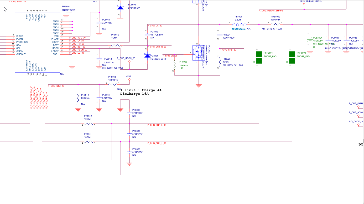

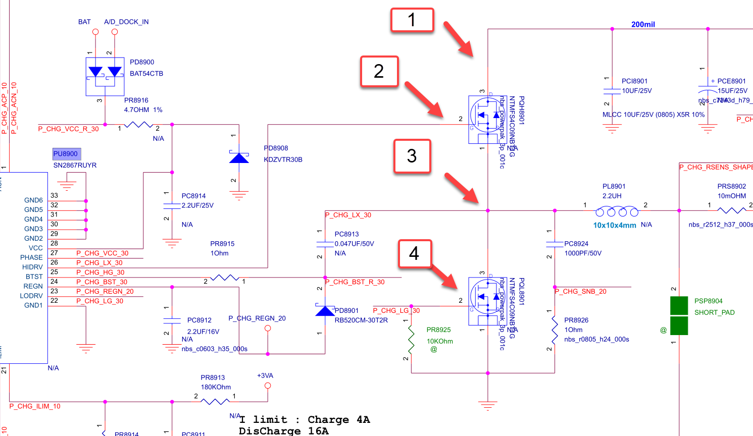

                      #150

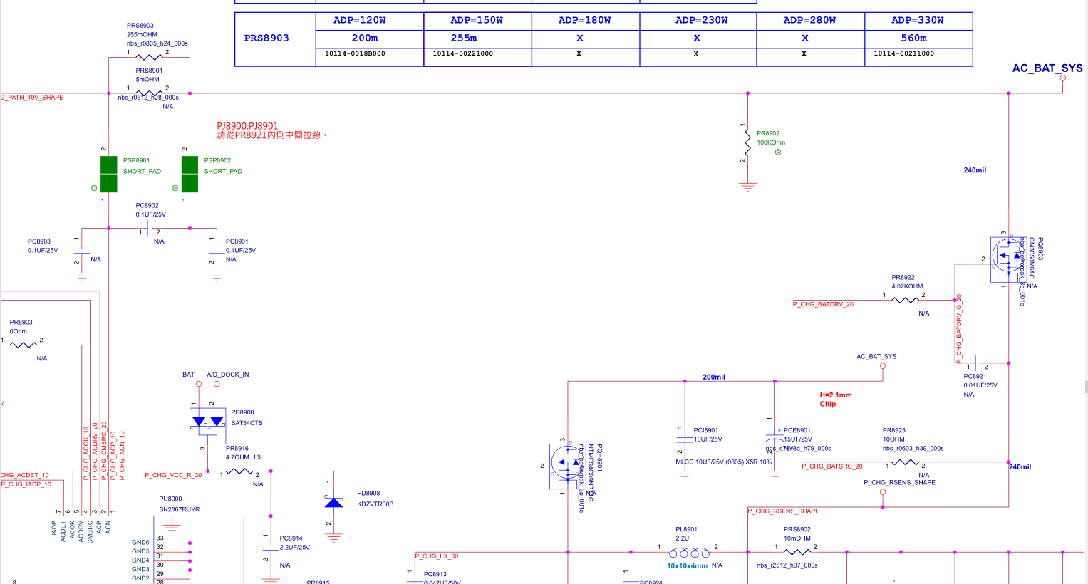

                      See attached.
                      Post the voltage readings for each point of interest on the battery charge mosfets.
                      Attach the external power adapter & battery.
                      Meter in 20V scale. Red meter lead to point to test; Black meter lead to ground.
                      Yes, it is possible that the battery BMS (battery management system) has shut down due to the spark but others can share their comment on this topic. If you have access to, try a replacement battery for testing.
                      When the system is booted, does Windows report the presence of the battery ? Battery level ?
                      The SMBUS / I2C lines seem to be ok with the posted resistance but you can also perform another test.
                      After the logic board is powered up with the battery -> measure the voltage of the battery connector pins (SCL & SDA) to check if the interface lines are defective or not.
                      What voltage do you read with respect to ground for the battery connector pins 3 & 4 ?

                            #153
                            See attached.
                            Here is the readings for the mosfets:
                            PQH8901:
                            D: 20V
                            S: 0,223V
                            G: 0,223V
                            PQL8901:
                            D: 0,223V
                            S: 0V
                            G: 0V
                            Yes, battery shows up in Windows and bios, and reports as 100% charged.

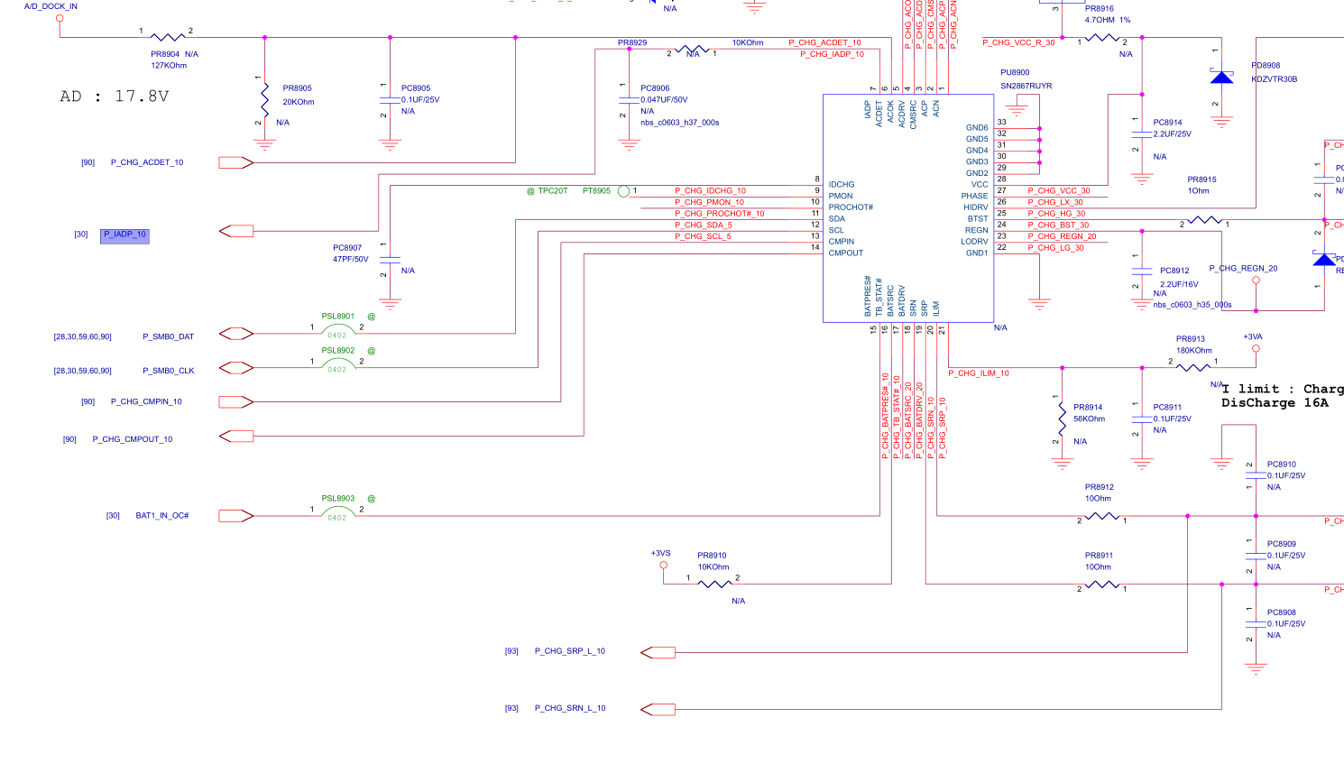

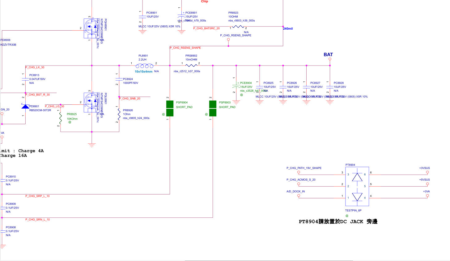

                                      #158
                                      By the way here is shematic and brdview
